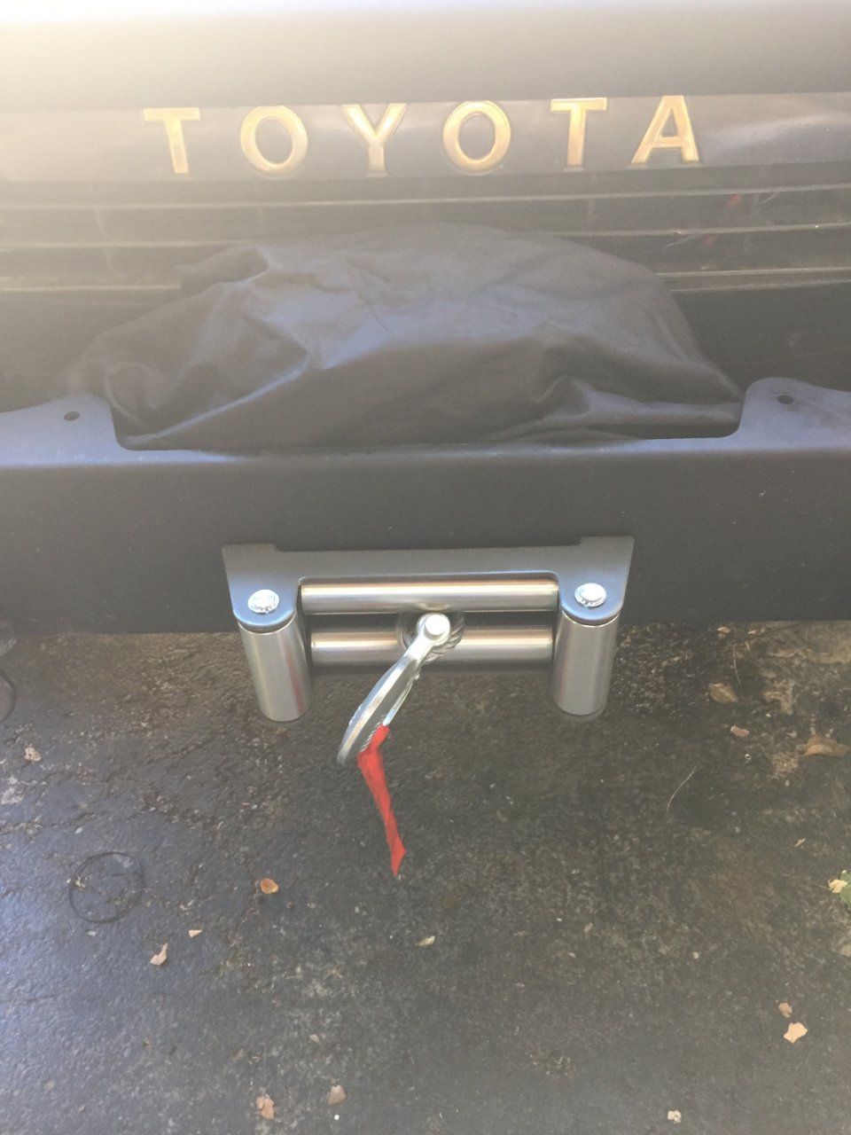

Put a winch cover on.

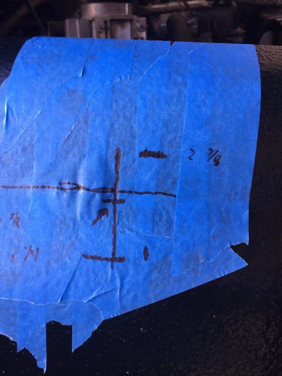

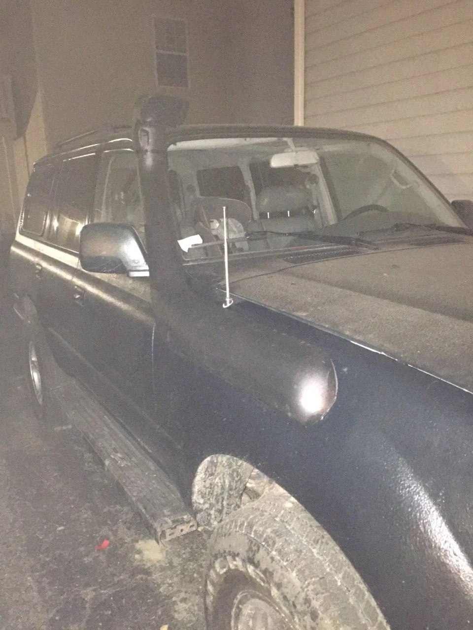

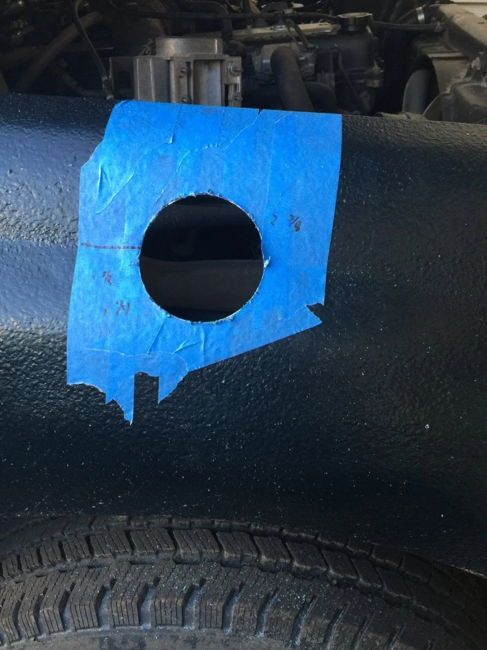

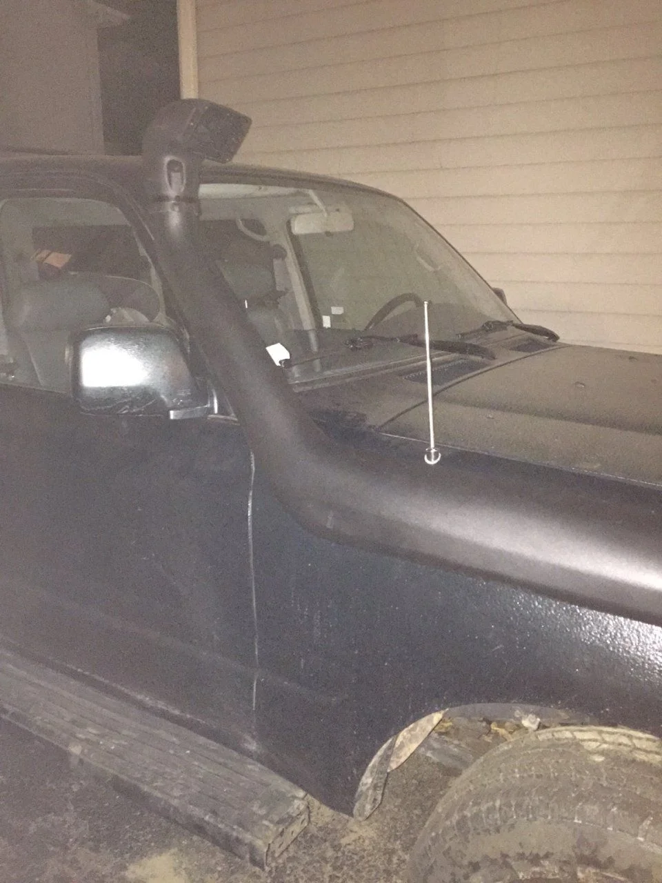

All that's left are the back three bolts. A tip to those who try installing a snorkel. It's a pain in the butt to get the washer on and the nut. Put double sided tape on the washer put the washer on then the nut. The double sided tape will also help seal the hole. (Credit to YouTube)
