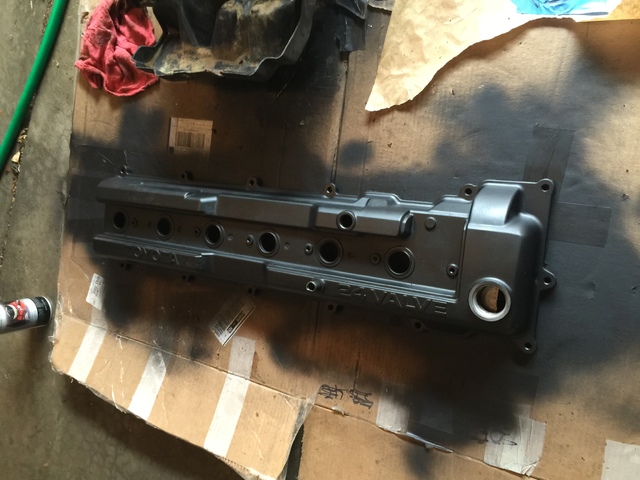

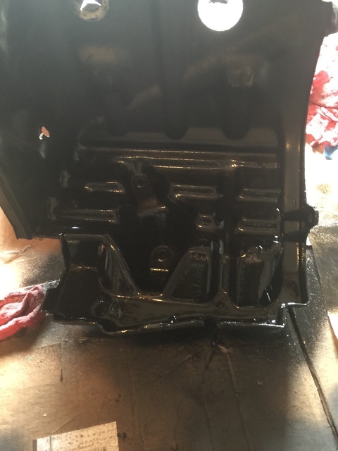

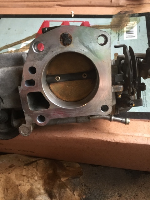

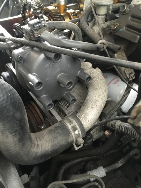

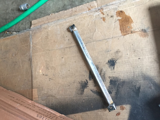

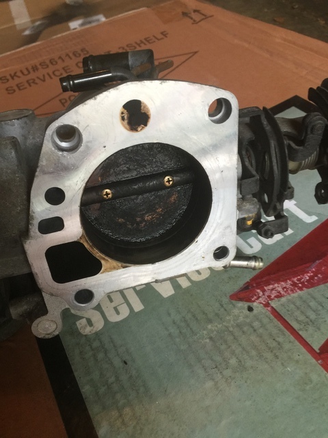

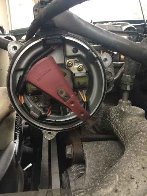

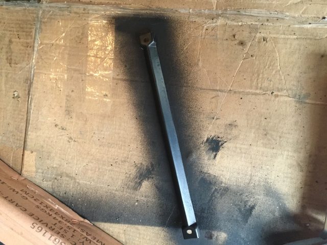

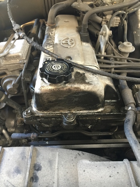

Valve cover is off, cleaned and repainted (only one coat so far). Spark plug tube seals, pcv and grommet are off. I noticed the back bolts on the valve cover were lose which was probably the cause of the leak. I started cleaning all the gunk off. Removed the battery. I repainted the battery clamp with plastidip. Cleaned the throttle body. I put a new dissipator cap and rotor on. I've never worked on a distributor before so I hope I did everything right. I marked where the rotor was and replaced it with the new one. I put all new toyota genuine spark plugs in. I still have to do the back one left but will get to it sometime this week.

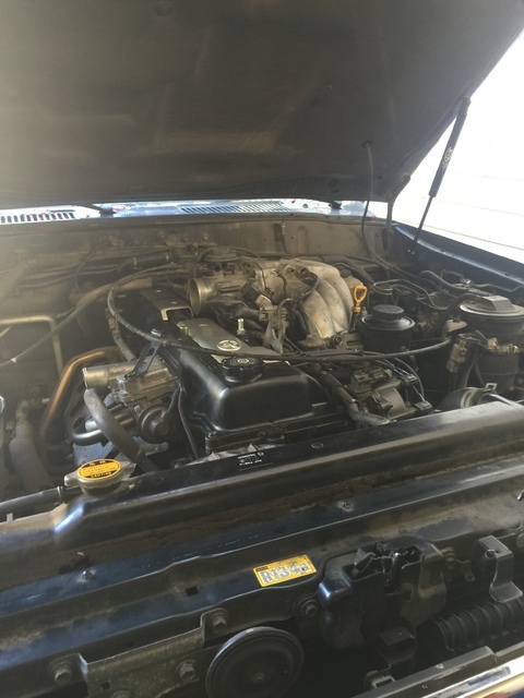

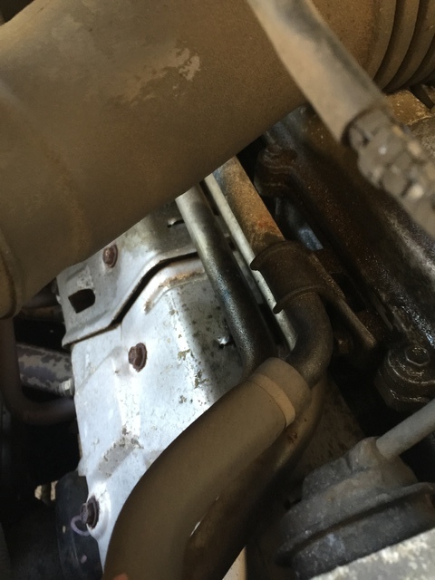

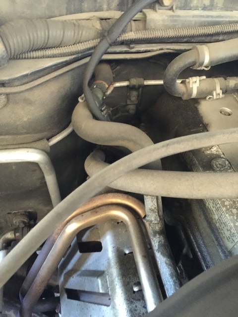

I was able to get the valve cover back on last night. The back two bolts are a real pain. Plugs are in and hooked back up. I stared to hook the throttle body back up but decided to call it a night. I noticed a crack in the pcv hose and the breather hose. I had really though idling. I am not sure if that was the cause of it or not. I'll order replacements today. I have pictures and will try to upload them after work.

Cracks in those hoses are normal after a while and will cause a ruff idol. I used Duct tape at first to try to fix mine and eventually purchased a new one.

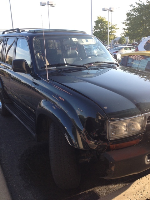

Bought the 80 with a little bit of body damage.

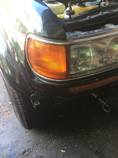

Still needs a little work but much better! The fender is realigned and the new parking light fits. There is still a dent in the fender right where it meets the bottom of the parking light. I may just leave it. The AOE front bumper looks like it will cover the dent.
VC is back in
The batter tray is still wet in this picture. This picture is of the first coat.
