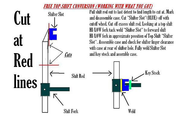

EDIT: forward shift to top shift conversion for FREE
Converting forward shift case to top shift case? - Pirate4x4.Com : 4x4 and Off-Road Forum
