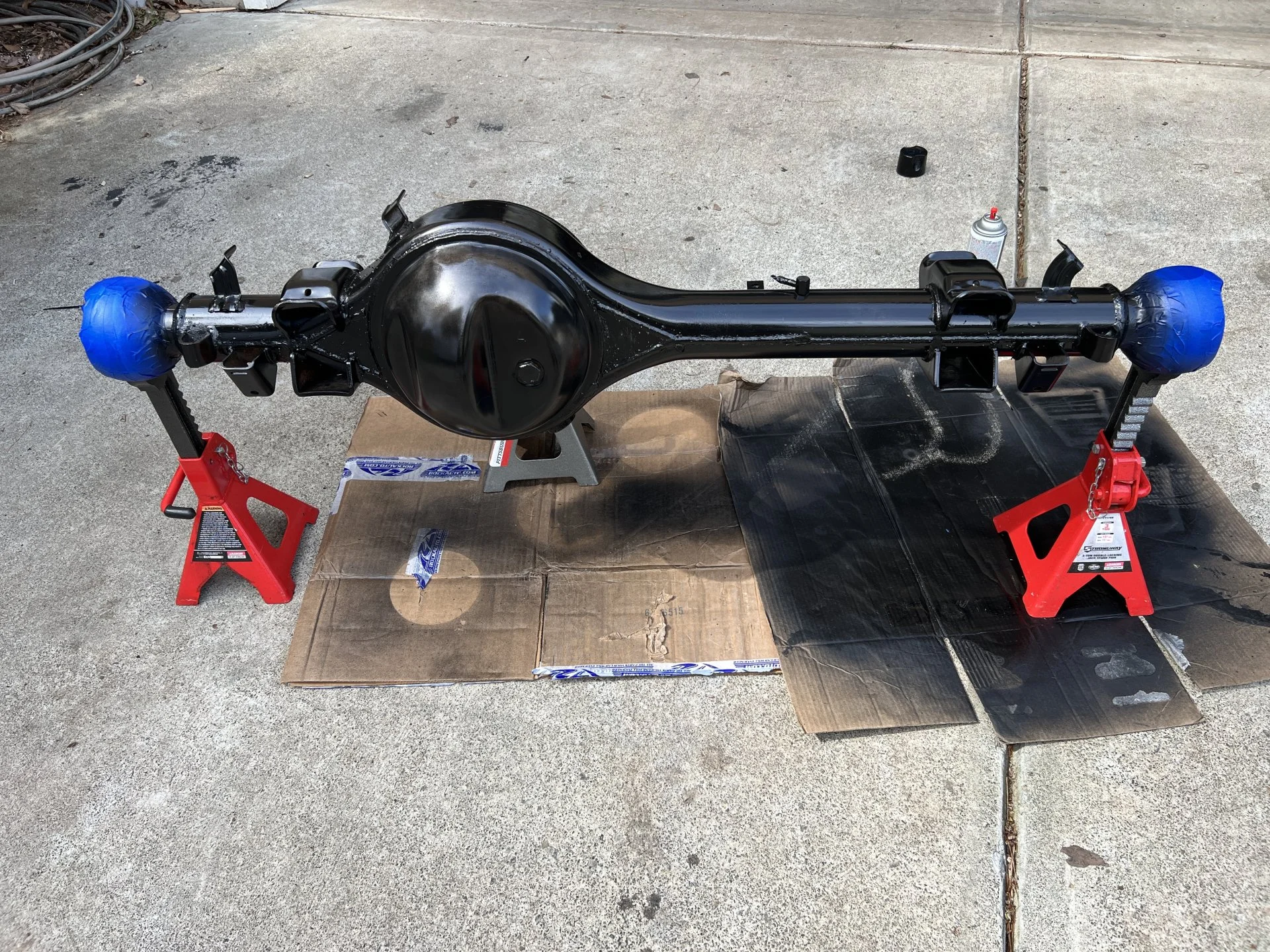

Lots of work has been going on the past few weeks but a new puppy has severely decreased the amount of time I have to spend on the truck.

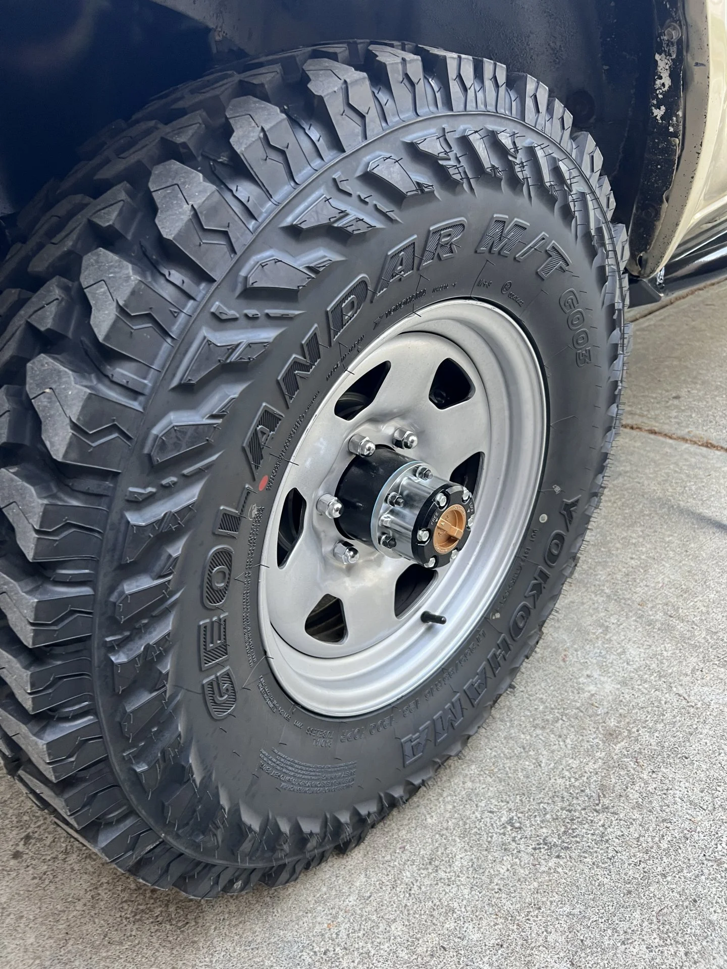

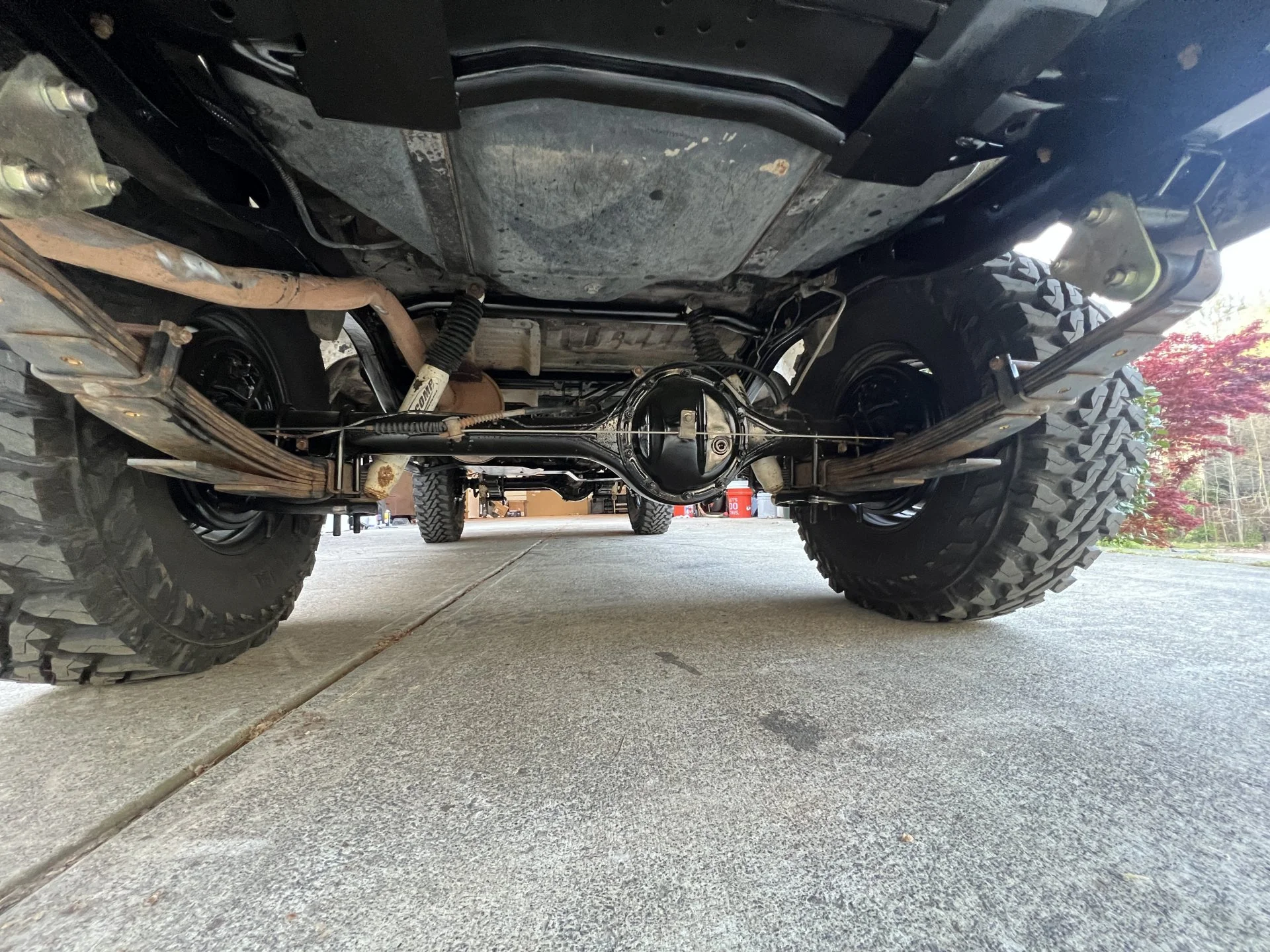

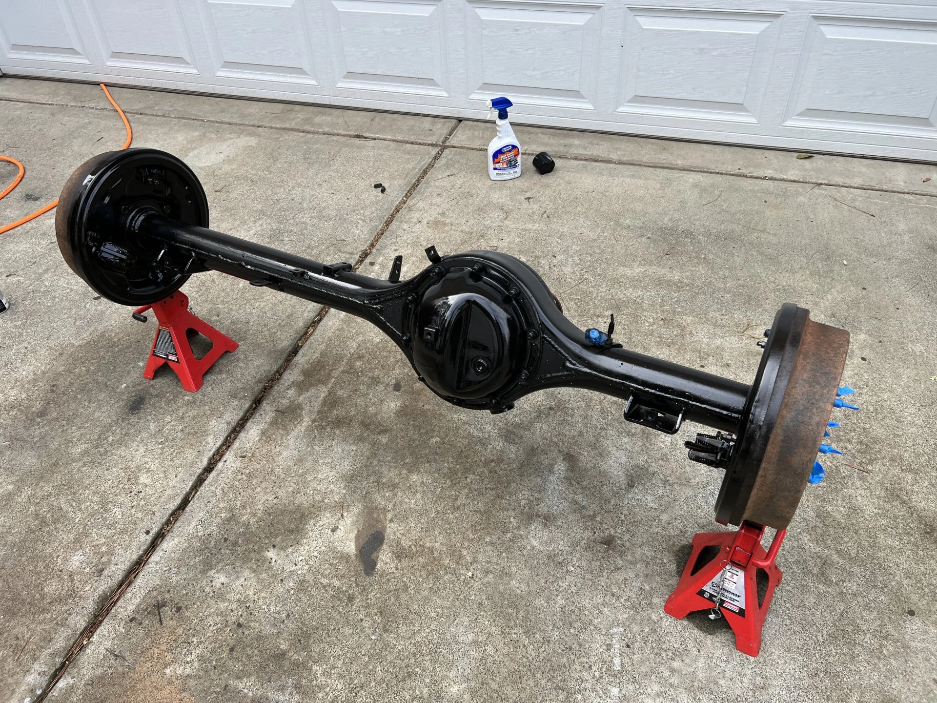

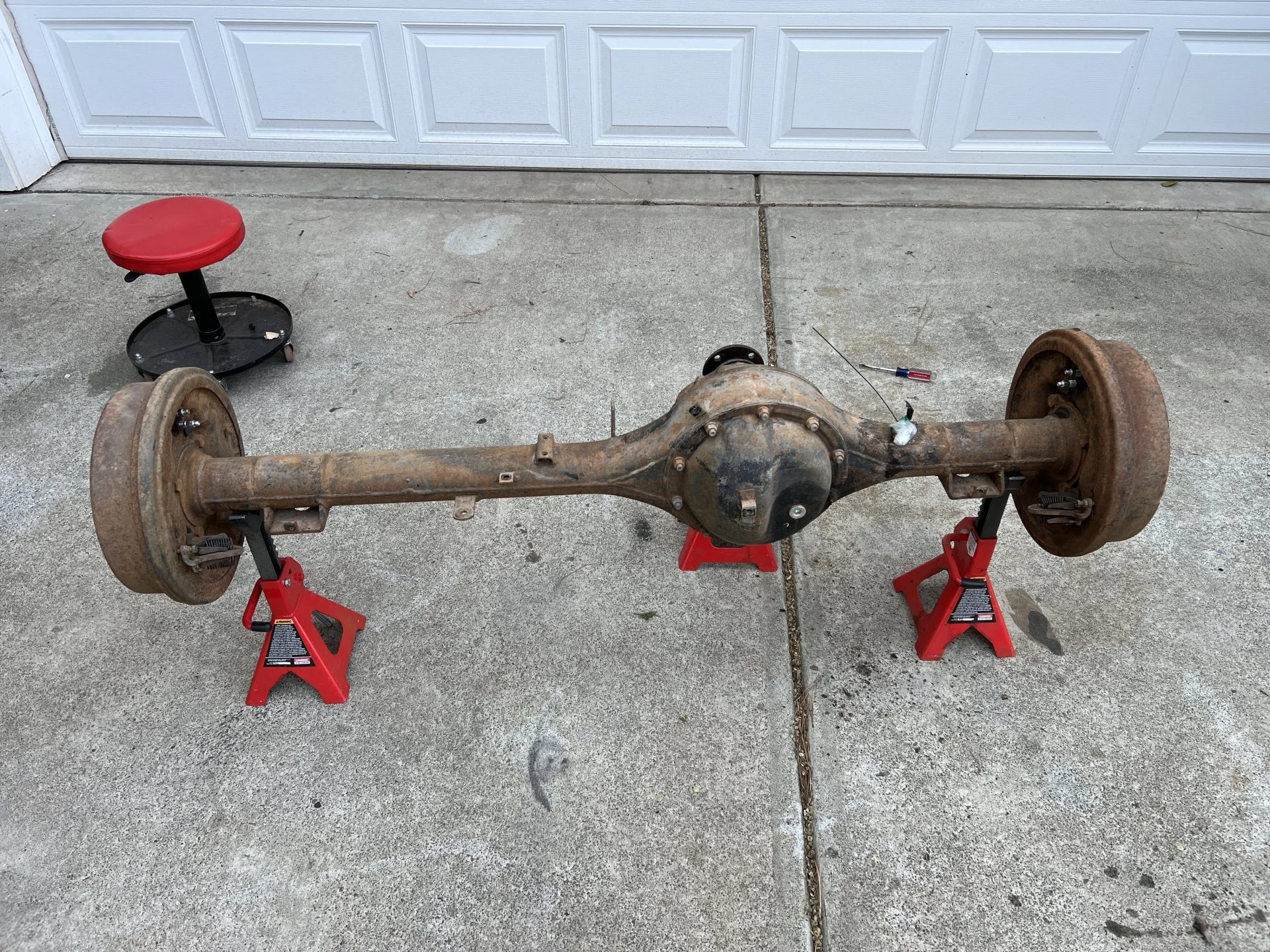

Pulled both the axles for a rebuild and clean up. Brakes were done top to bottom and front to back. Everything in the system was replaced expect hard lines. The booster I ordered is giving me issues so I'm working on that with the vendor and have the stock booster back on the truck for now until it's resolved.
Front got the following:
- Knuckle job with marlin seals
- New rotors, pads, calipers
- New Aisin master
- Backing plate delete with stainless lines from SOR
- New locking hubs
- New wheel studs
- All new hardware
- New TRE's
- New Steering stabilizer
- New Ubolts
- etc, etc.

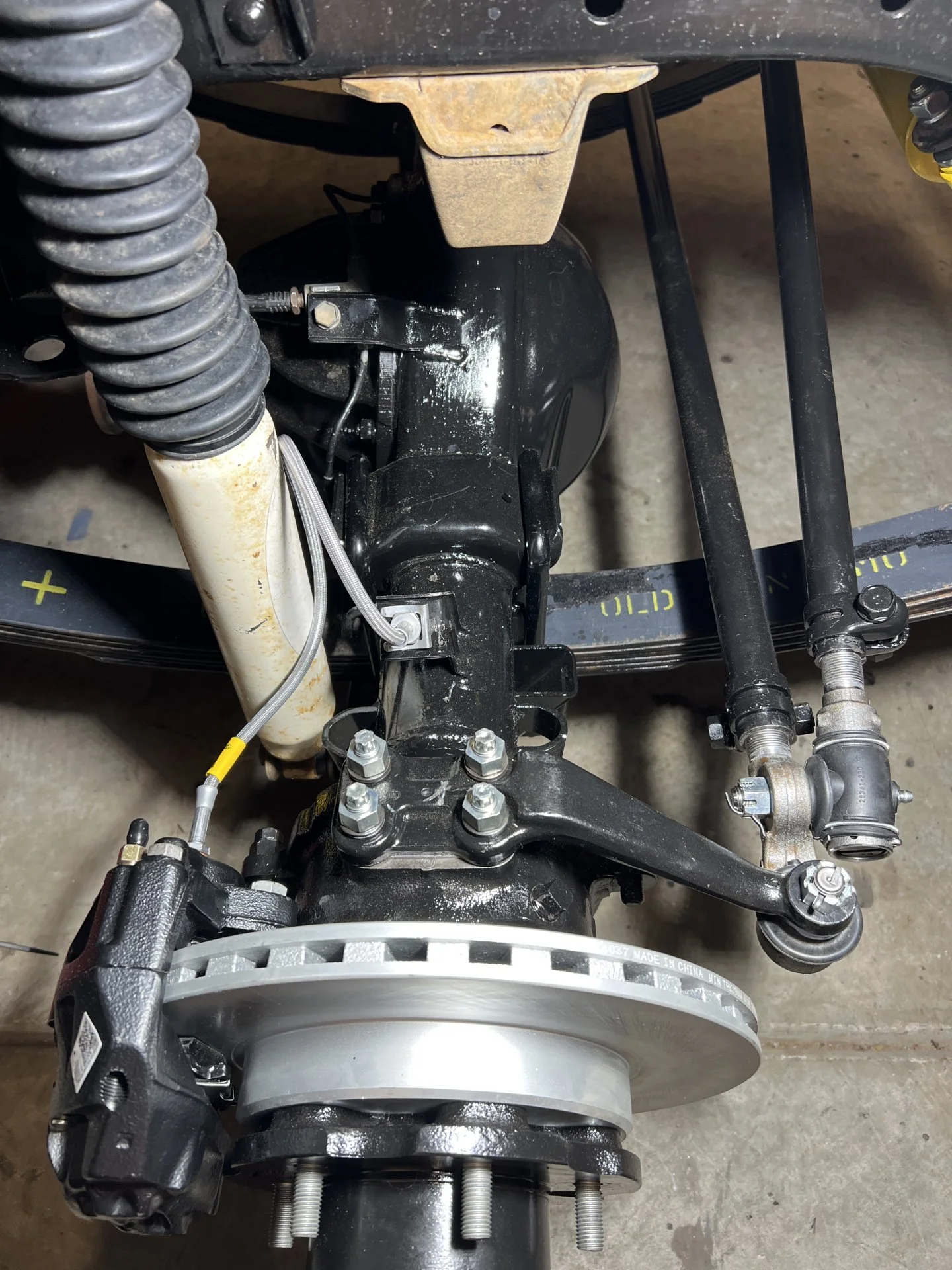

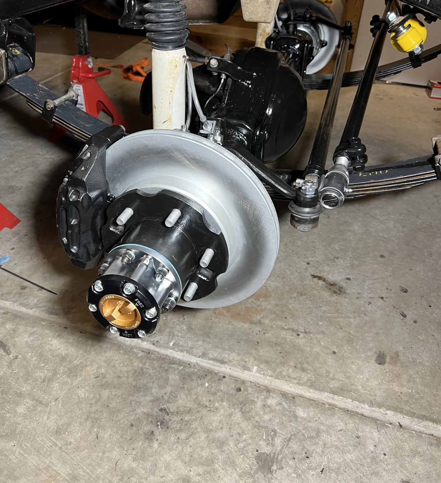

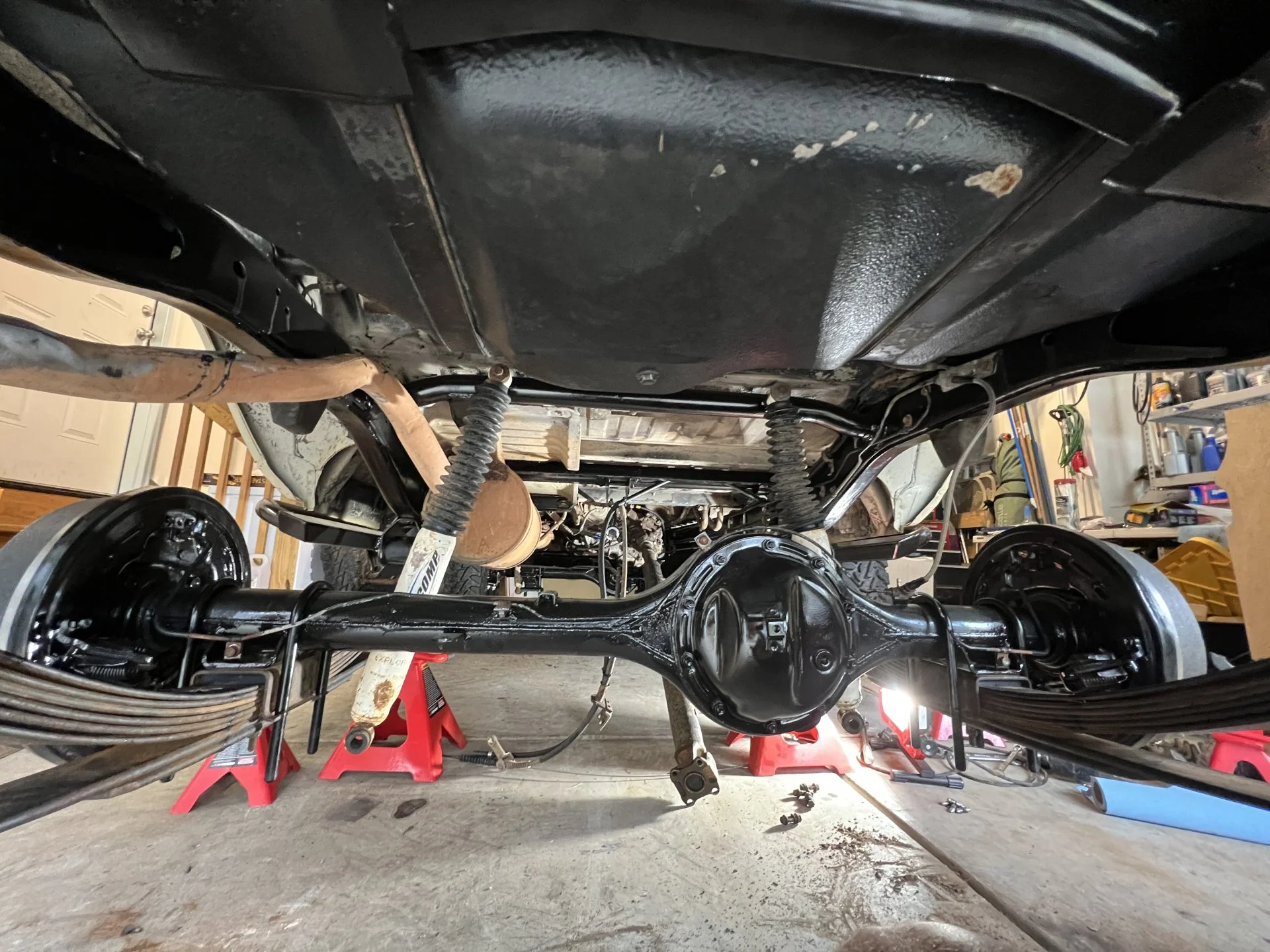

Front in progress and finished
Some finished pics! Job was really satisfying to do since the front axle seals were wasted and bearings were not in great shape. Luckily, the knuckles had virtually no pitting and looked fantastic!
Brake feel is much improved but the stock booster isn't great. Hopefully I'll get the new booster in there soon which will bring braking back to 100%.
Excess ubolts will get trimmed shortly.
Great work! One minor bit of feedback would be to confirm that brake line won't be impacted by the shock at full lock. I'd also see if that line can be managed a bit better. Wind and debris could move that around quite a bit and cause premature wear to the line or surrounding components.
Cheers, James
Cheers, James
There’s no interference at full lock but the line seems too long for the application. I have some 90* adapters on order to help manage the line better. If that doesn’t work, I’ll order some shorter ones. As is, there’s no way to avoid having it twisted a little. Luckily, the line is stiff enough it won’t be impacted by wind while driving.
Awesome. Is there a reason you left off the disc brake shields?
They tend to collect debris on the trail. Also makes replacing knuckle parts easier on the trail if something breaks.
I think that getting rid of the short rubber hoses helps a ton.
One line and you’re done.
Just went back and read your entire thread, fantastic work. Question from a few pages back: how did you apply the Por? Sprayer?
Thank you! I brushed it on.
