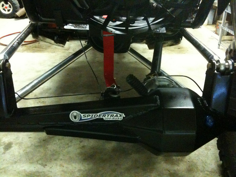

I am picking up tubing today and my Heims from ruff stuff should be here by the weekend. I pretty much had them build me a 4 link kit To speed up the process. I wanted to build everything from scratch (you guys know how much I love my plasma ) but this will save me a shunt load of time.

welded frame. got all my tube today.

Here is what i have so far on the basics of a 4 link from what i gathered over the past few months
-lower links no longer than 40 inches
- upper links need to be around 70% of the length of the lower links
-Try to get links as close to 40 degrees as possible
-vertical separation between the upper and lower links should be 25% of tire diameter (9.5 inches for my set up)
here is what brian said that threw me .
the upper links where they connect to the chassis crossmember need to be 12 inches apart. If thats absolutely needed then my links will be no where near 35 degrees. I would have to run much shorter links .
My preliminary mock up measurements for link lengths are 37 inches for lower and just under 26 inches for the uppers.
do the upper links need to be that far apart at the chassis?
I would think the more triangulation i get the better ( links closer to 40 degrees) that would entail moving the mounts closer and or shortening the links..
someone throw their wisdom my way
Saying something definitive like "it must be 12"" is BS.
Triangulation centers the axle. Keeps it under the truck.
Not 12"....worked awesome
Not 12" works great

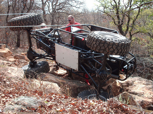

I think the best thing for you to do is head over to Pat's to pull measurements off the rear of his buggy.
His is one of the best working buggies for crawling in the country. I have seen it do some things.....
Also, Joel's Jimmy's 4x4 buggy is over there. It has a 100% proven 4-link design on it. Those buggies work awesome as well.
Putting your eyes and a tape measure on two awesome buggies is something that would help you a ton to get your arms wrapped around this deal
didcha try running your numbers thru the 4-link calculator? that should help. they guys at ruffstuff don't necessarily know it all......that's why they're in the business of selling bent metal parts that roughly fit ( hence the name ruffstuff )and not building rigs. :lol:
