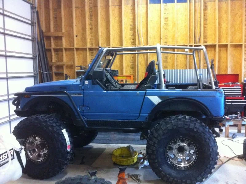

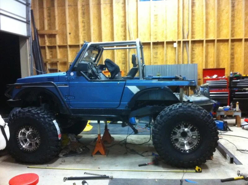

Hey guys here is what I am planning for the samurai...
3 speed automatic to 1.8 lowrange adapter/doubler to Dana 300 with 4:1 gearset and HD front and rear outputs.
rear stretch to 100 inch wheel base
double triangulated 4 linked rear
-would give me link clearance for future rear steer (still undecided)
14 inch Sway a Way Racerunner airshocks
39x13.50R17 BFG Krawler stickies on 17 x9 Raceline Monster Beadlocks.
stretched body skins
extend and redo rear roll cage
Ram assist for front steering.
I will test the above before moving to the front.
Front plans so far are:
to stretch out 7 to 8 inches
3 link
14 inch Sway a Way Racerunner Airshocks.
Oh and i already started ;)
It was so cute before.....

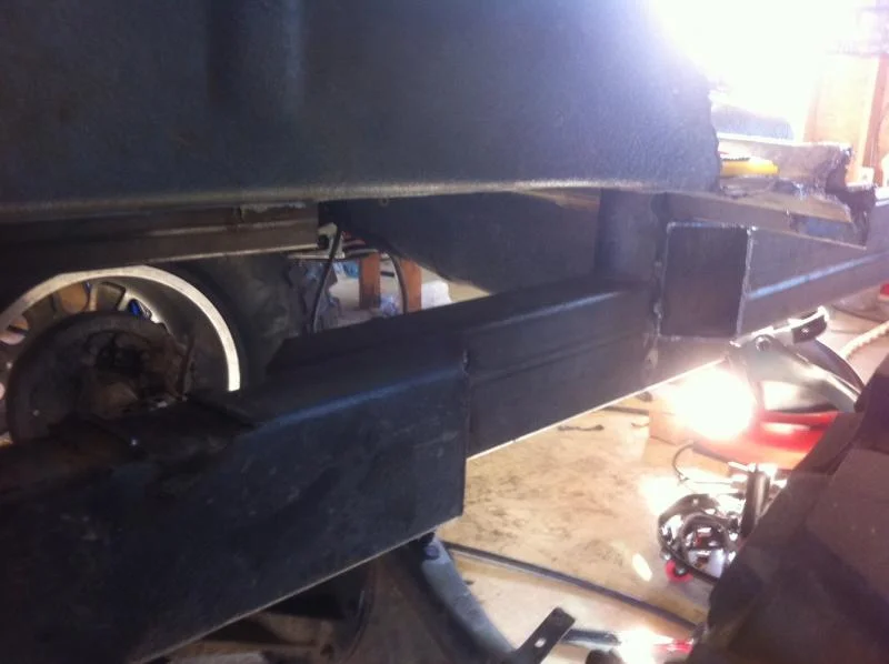

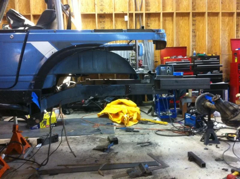

some more detail of the rear part of frame. Jrob and I narrowed the rear frame by about 2 inches on each side. rebuilt (notched) the rear most part of frame to allow clearance for Airshock.
I raised the rear most section 2 inches to gain more gas tank/cel clearance. had to extend frame to have fuel tank/cel behind and away from rear seat.

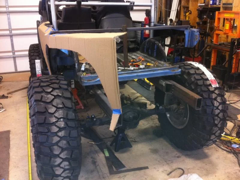

I am thinking about dovetailing behind the original body.
If i dove tailed the whole body i would lose some room for back seats. its already starved for space back there.
I picked out some 18 gauge steel that is waaayy to freaking heavy.
what do the buggy's use? and where can i get it?
there is a paintable plastic sheet that looked like sheet metal when painted ... I can't think of the name of right now :hhmm:

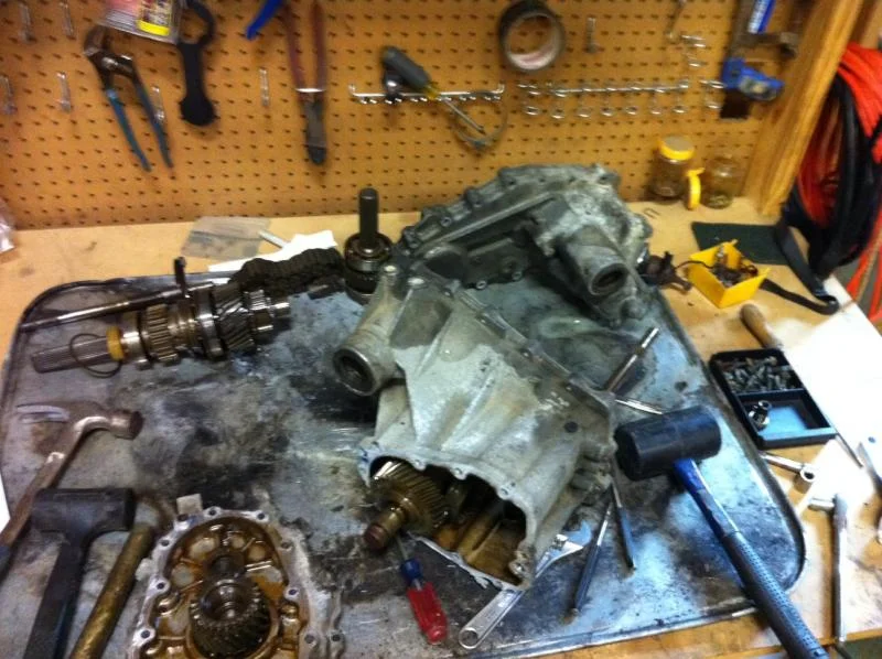

tore down the sidekick tcase for the 1.8 gears and some other parts.
I just noticed all the hammers in the pic :o
Hammertime!
I am not very patient :frown:

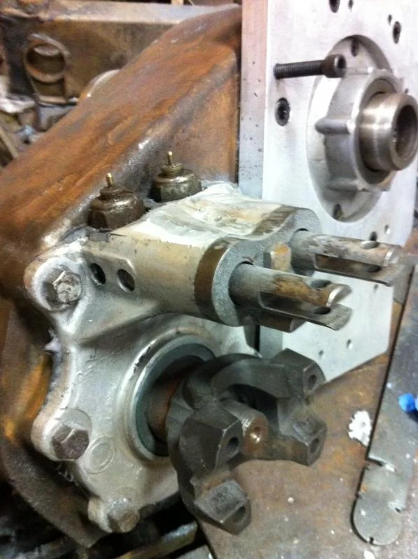

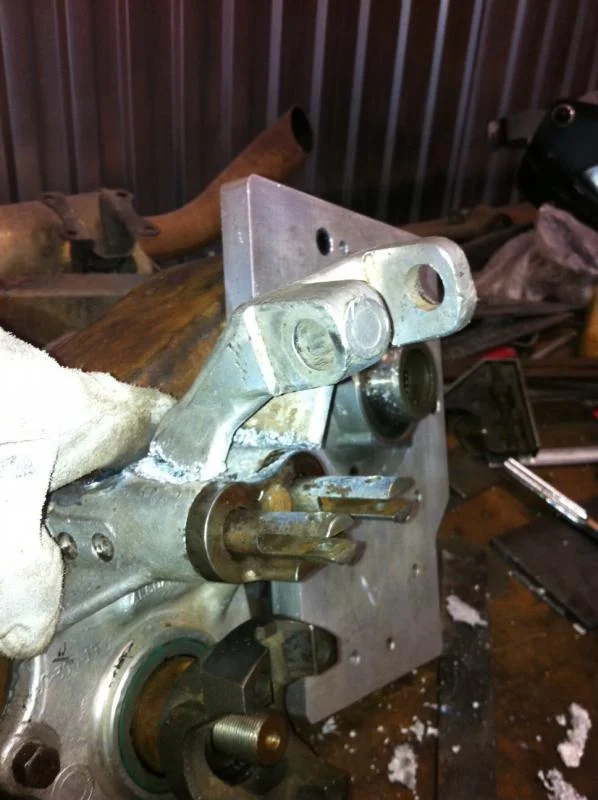

which brings me to my next challenge... what to use for shifters since i had to cut the shifter mount off to fit the adapter/doubler.
I know there are cable shifters out there but i here different things about em.
Has anyone made their own cable shifters?
if so, don't be afraid to post up some pics of what you have seen or built.
Here is a pic of the Dana 300 rails with doubler shifter ( rectangular block above the d300 shift rails
Yep, and I believe I sent you all the pics I have. I can talk ya through it if you'd like. Not difficult, but definitely some thought goes into it.
EDIT: If you've got the money, the NWF shifters are a great investment!
Lenny, I actually have ONE cable shifter from an old project (4 speed Atlas install) you can have for a case of low carb monsters :).
They work great. I used them on my Kate project to get my shifters where I wanted them.
