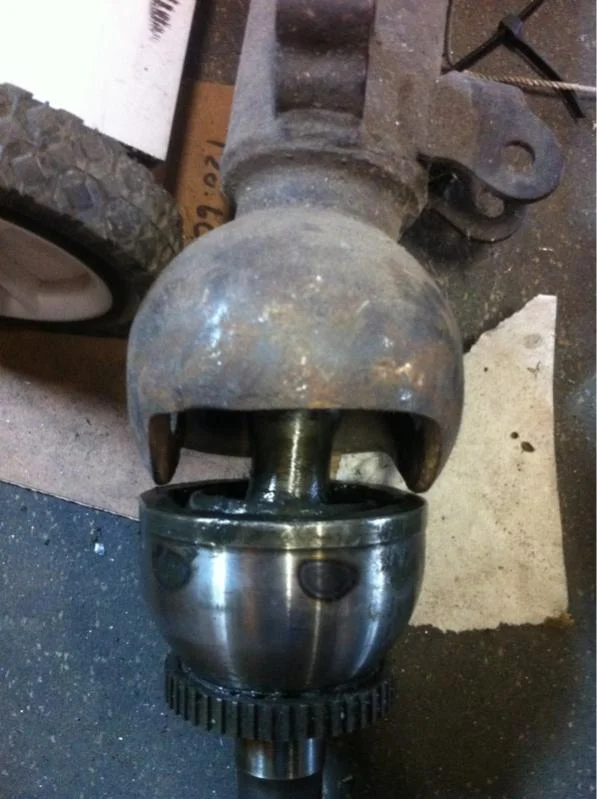

So i carry my arse out to my spare bin to check the difference between a mini birf and a 80 birf. Axleshafts are the same width..
I says to myself ,ehh the 80 birf is a little bigger...pic 1
So i try to slide it into a front mini truck housing.. wrong ! Way bigger pic 2
So that brainstorm turned into a brain fart. Just trying to use the shunt i have around the house
OK so my take on the whole situation is that 80 series bells are larger than 40/mini bells. However the inner axle shafts on the 80 series Longfields are still only 27 spline (same as a stock 40/mini). The 80 series longs are breaking inner shafts just like the 27 spline 40/mini axles used to before he upgraded to a 30 spline inner shaft where it meets the star. If bobby would change the 80 series shafts to a 30 spline inner shaft at the bell they would likely be stronger than the 30 spline mini parts but he doesn't plan to make that change from whet he has told me.
That being said my opinion is to either run a Mini/40/60(depending on what width you want) axle and housing w/ 6 stud knuckles and be done with it. The only drawback to a mini axle is that you are still left with a 8" ring gear up front which I will never wheel with a small block as long as the 9.75" cruiser diff is an option.
I was contemplating a Fab housing w/ a cruiser diff and 80 series bells and HD knuckles (available shortly) but with the 80 series longs still using a 27 spline inner that doesn't sound so appealing. At that point its D60 time.
So FJ60 (wider than 40 and mini axles but not as wide as 80s) axles w/ 6 stud knuckles, 30 spline Longs and either Drop in lockes or ARBs if you have the scratch.
