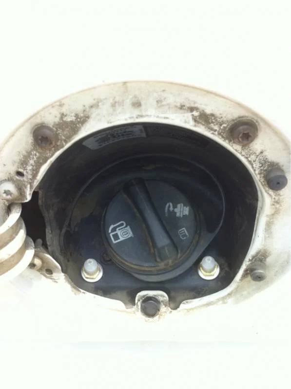

southff4 said:
How you like the airbags? Where did you put the air inlets?
Wound up putting air inlets by gas cap.
