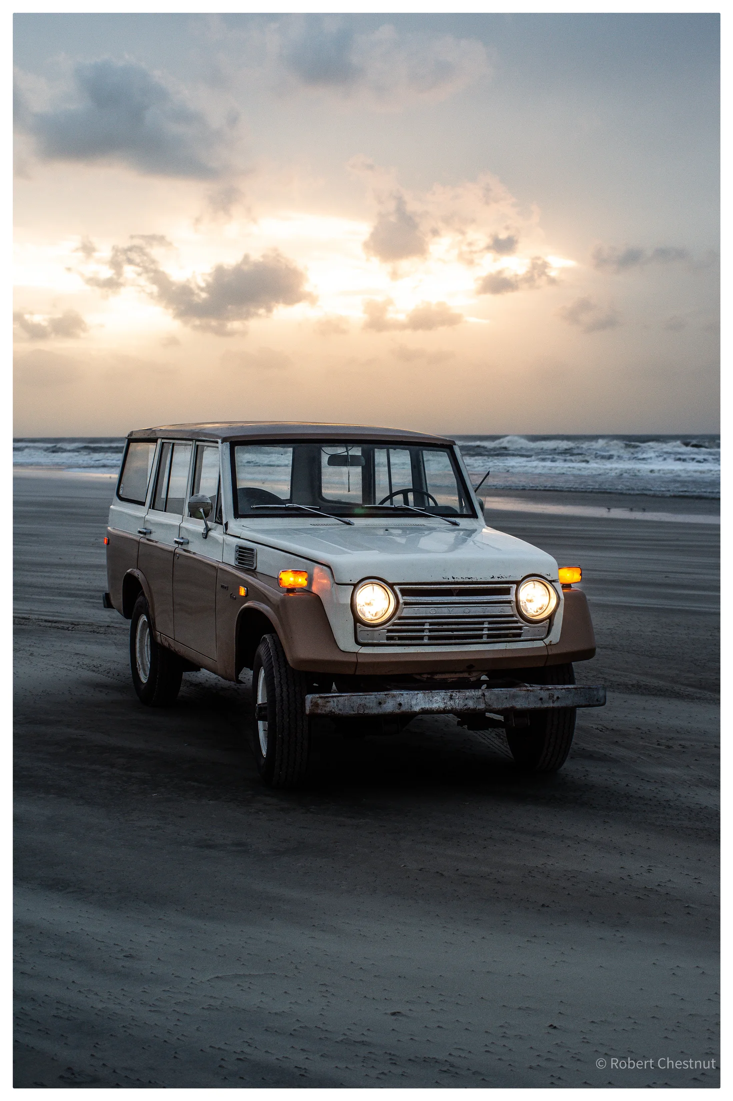

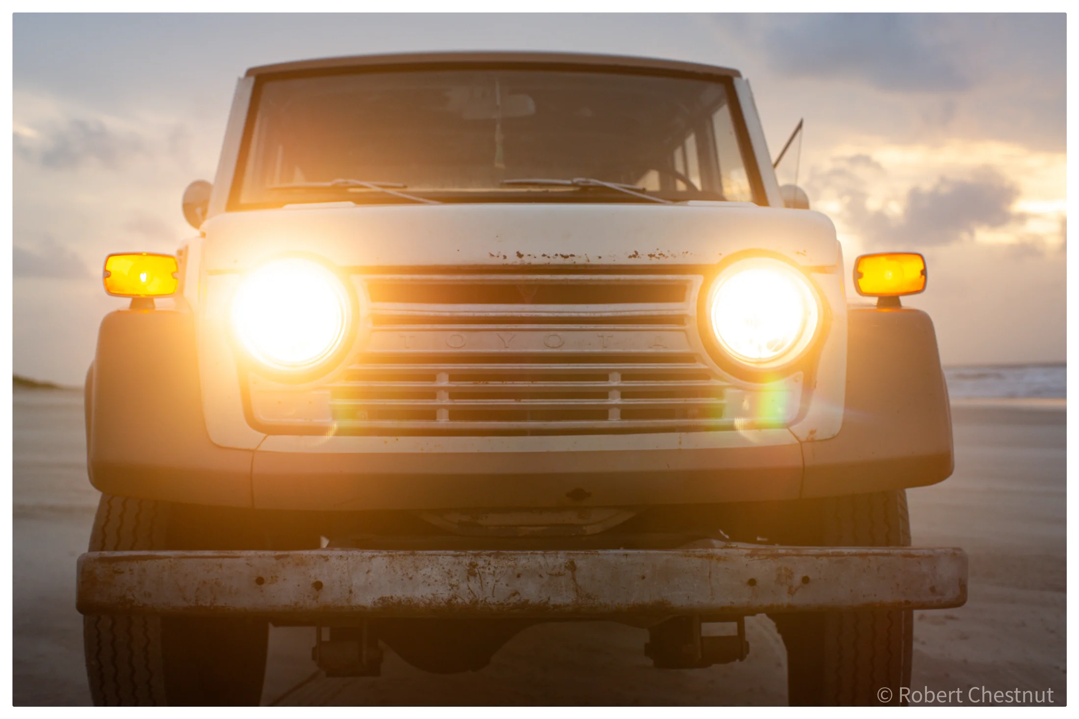

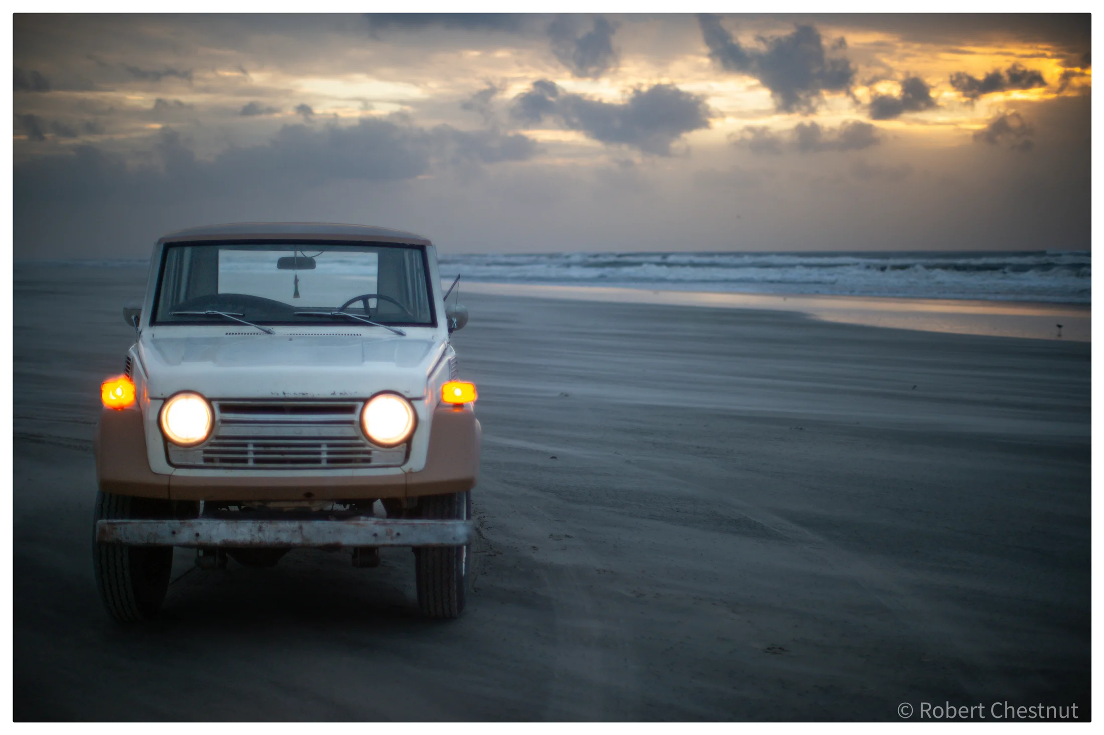

(Cruiser photography has begun on the salted pork wagon!) Here are some beach shots I got in the morning. Usually with a government shut down they rope off the beach. I drove out there to check it out before they rope it off for driving. I took this with my vintage digital Nikon df and a 50mm f1.2 from the 1970s! I love the soft dreamy effect you can get with this vintage nikkor lens. I have owned it for almost 15 years now. Stopped the lens down to f4 in the first and last photo and at 1.2 for the middle photo.

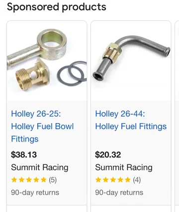

Some things I really don't like and need fettling with: 1. the throttle return spring I used was a little too tight. easy remedy here. 2. I wish the fuel inlet was on the other side. I wonder If I can get a fuel bowl for the holley thats on the other side. I had to run the fuel line a little closer to the head than I would like Its not actually touching but its closer than makes me happy. So I gotta find a solution to that. 3. The choke cable is too tight when I hooked it up. I am hoping to pull the cable apart and get it greased up and working again. I think I have to trim it shorter too.
things I already notice: Idles much smoother. throttle response seems better and overall the engine seems happier! give me a week for the full report!
They make several 90s. I used to run one like on the right on my 1F.
I bought the 26 - 44 fitting there. But I didnt realize I had to buy this to make it work - Holley 26-27 Holley Fuel Fittings | Summit Racing - https://www.summitracing.com/parts/HLY-26-27
So I bought that fitting and I should have a solution once it shows up!
Holley # 134-108 might work on that carb.
Might email holley and ask as even with the 90 degree fitting above, I would rather have the inlet on the other side. get that fuel line away from heat!
Holley tech line can be hit or miss. If you don't get a reply, try Summit or any of the carburetor specialist tech lines. Good luck with your project!
