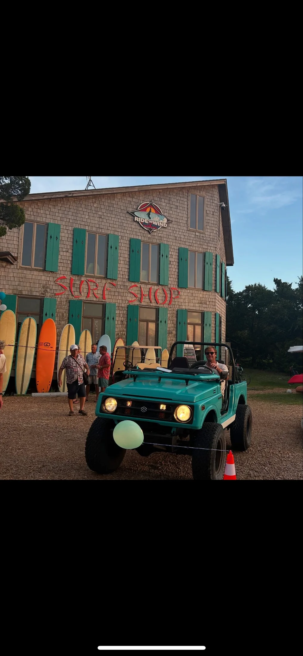

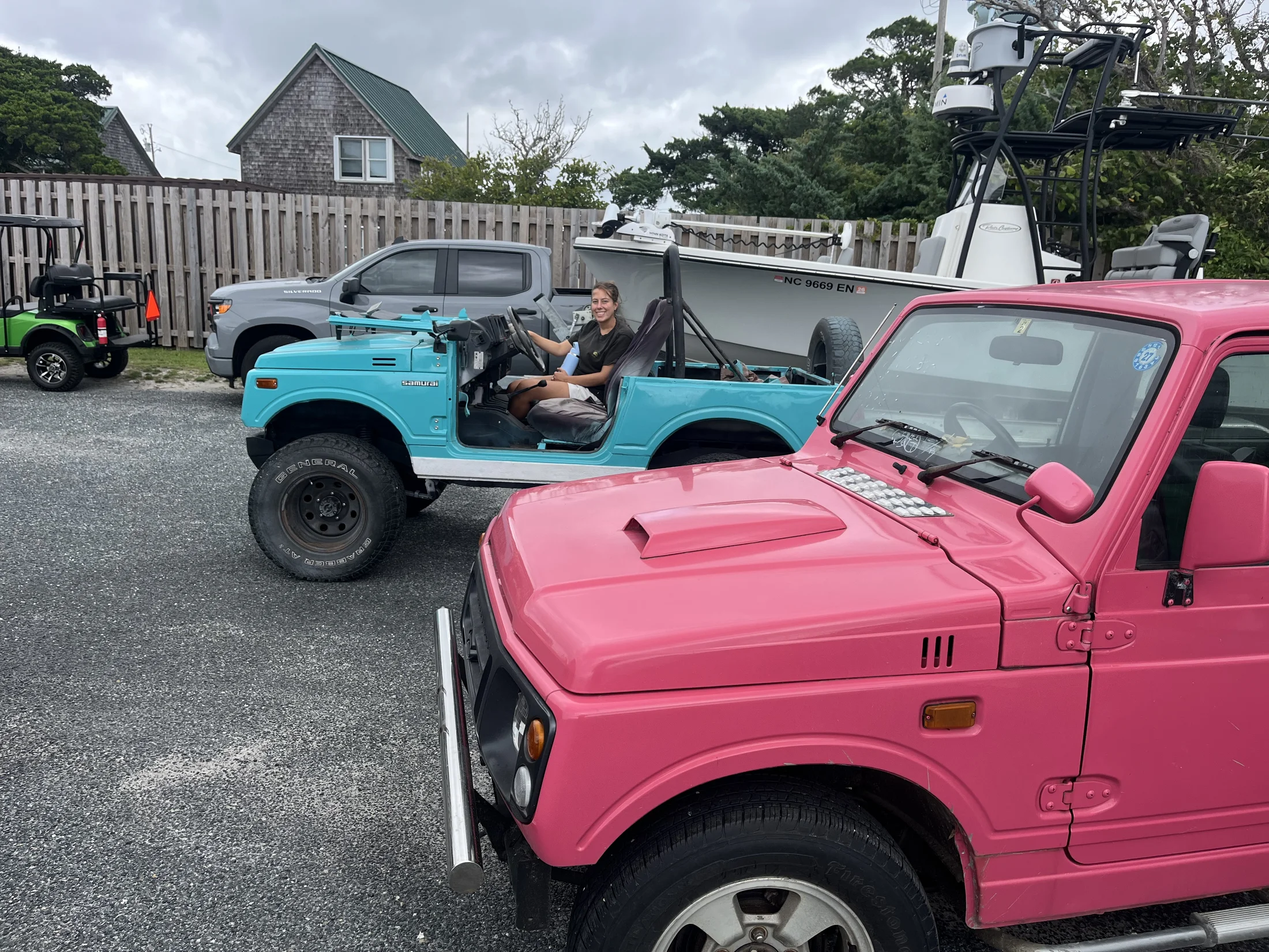

Look I found a jimny friend.
At the surf shops 40th anniversary party in July
