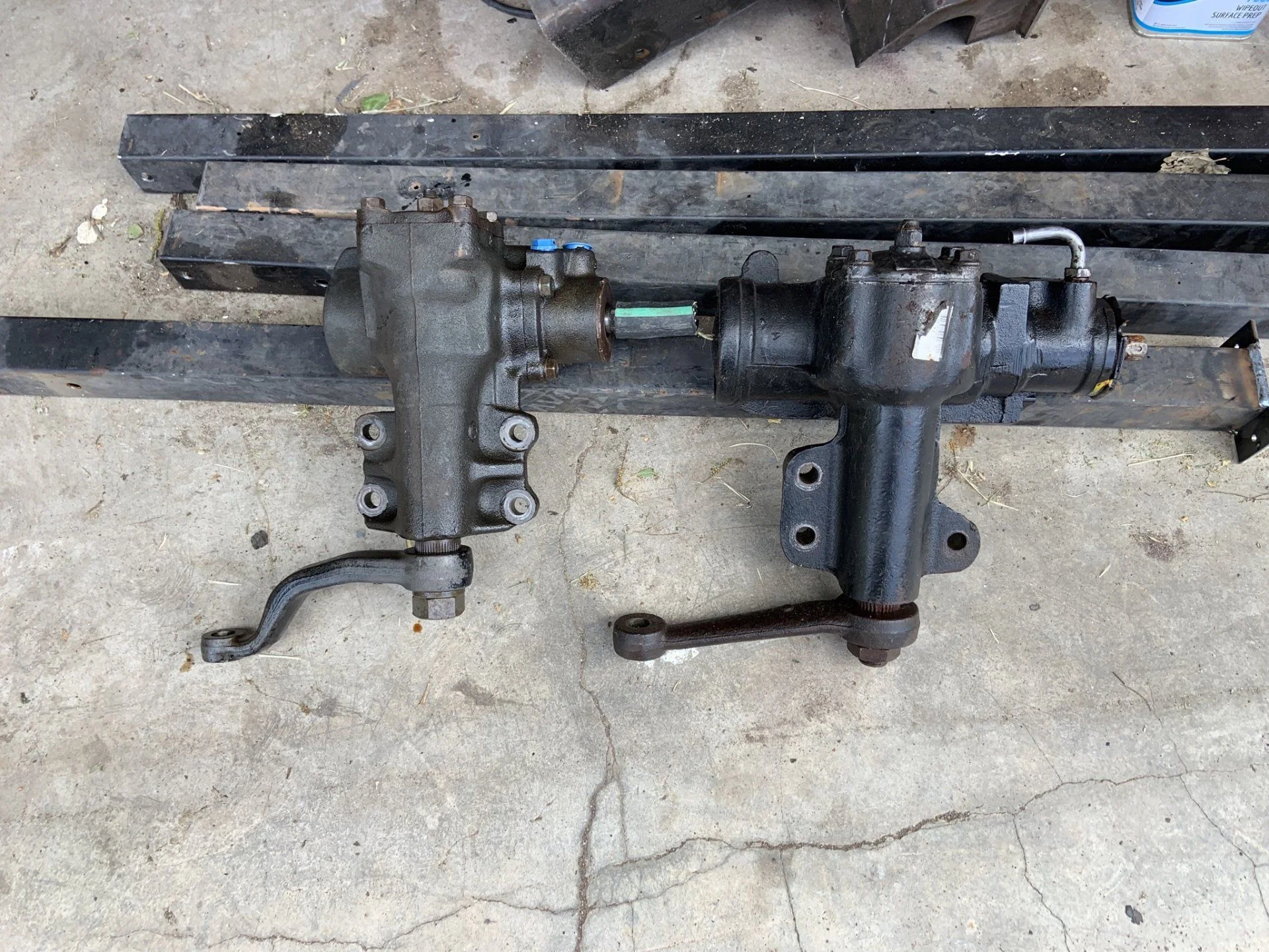

I think almost all modern american trucks and vans use the same pitman gear. My is from a Jeep and it fit my Astrovan box and also fits my '78 bronco box. I just had to get it reamed for the GM 1 ton tre.

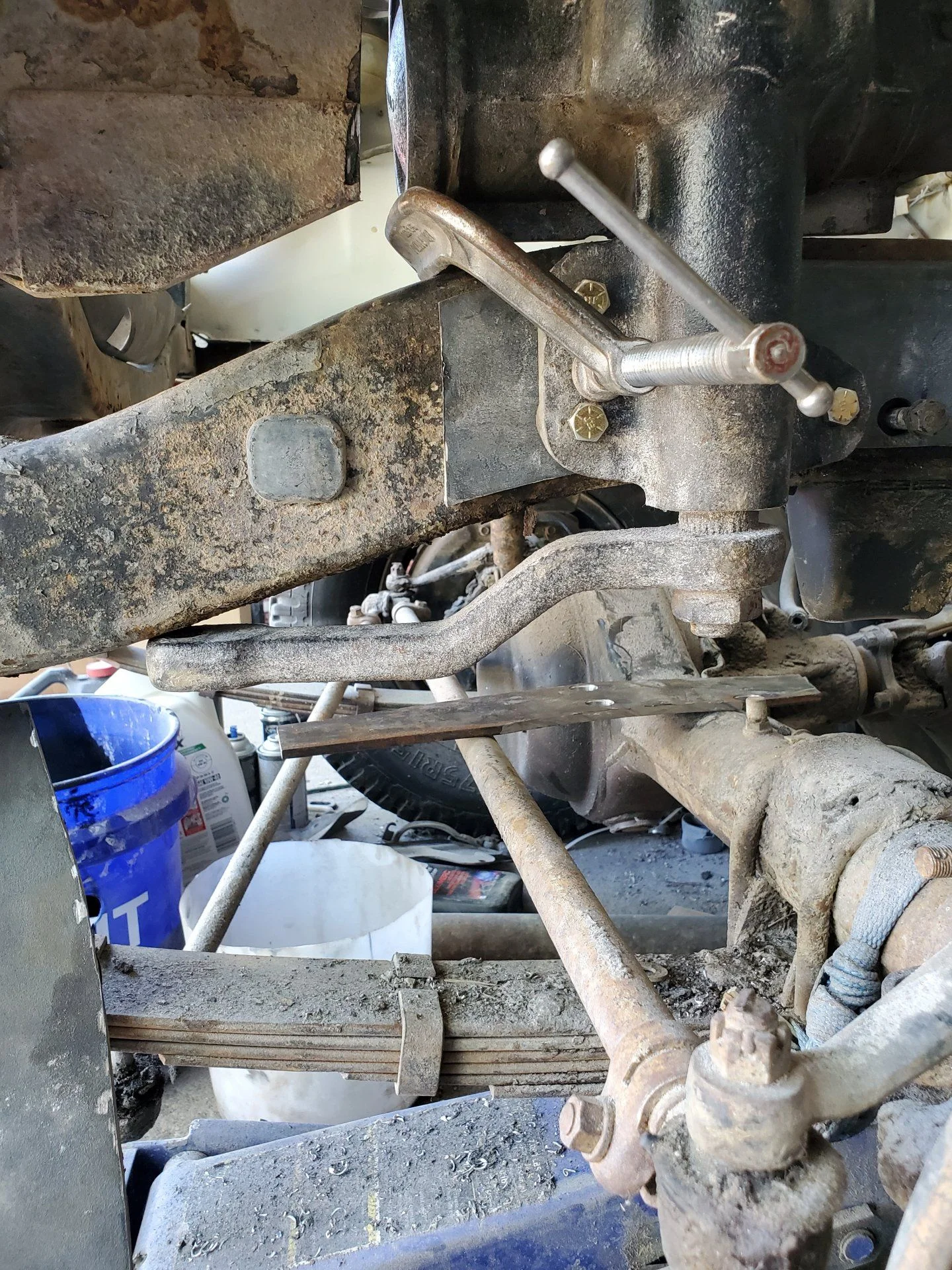

That pitman arm looks excessively long.
Want to say the pitman I used was from an early 80’s Jeep Cherokee/Wagoneer, but it’s pretty straight with no drop. Looks like you’d be doing pretty good if you found one about 2” - 3” shorter than the one in the picture. Can’t recall all the pitmans that are compatible with the Scout Saginaw boxes, but it’s quite a few IIRC.

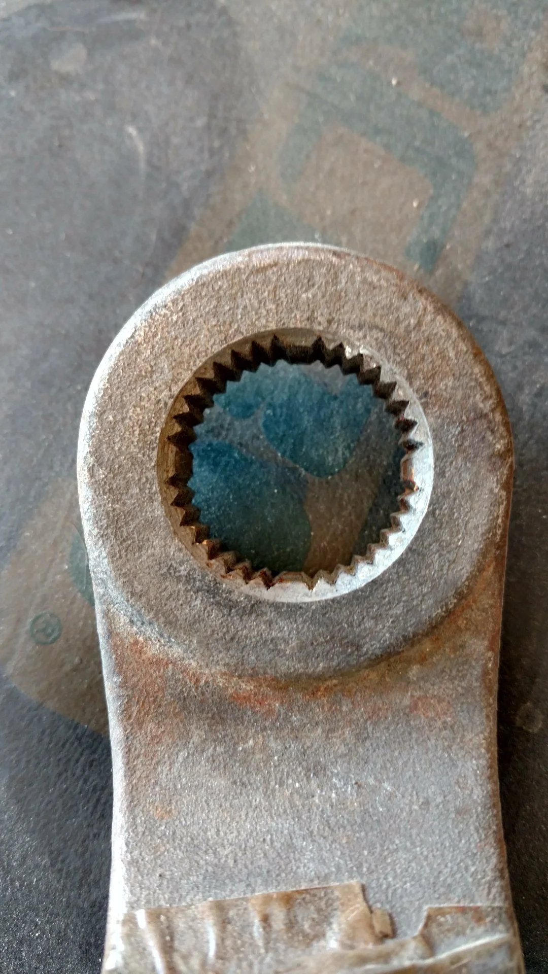

I will pull the arm tomorrow and look at the spline count and investigate if I can buy a cheap(ish) new arm. Before I order one I will see if I can convince it to bend a bit with heat - but these are cast aren't they? Not sure how it will respond, but will try it. For the record, this PS unit is from an International Scout of unknown year..
