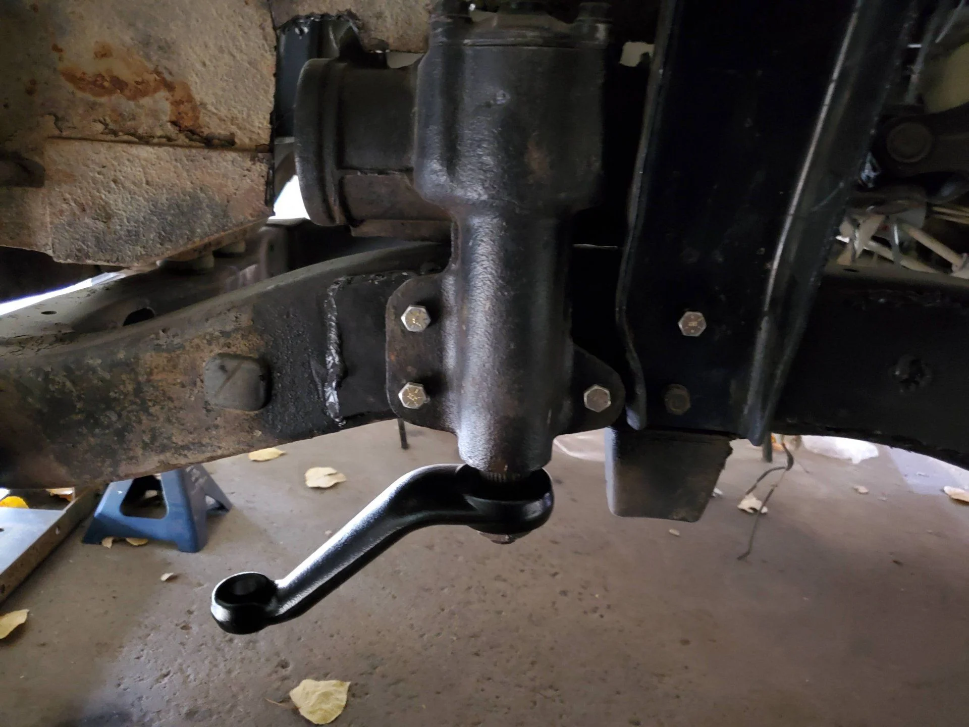

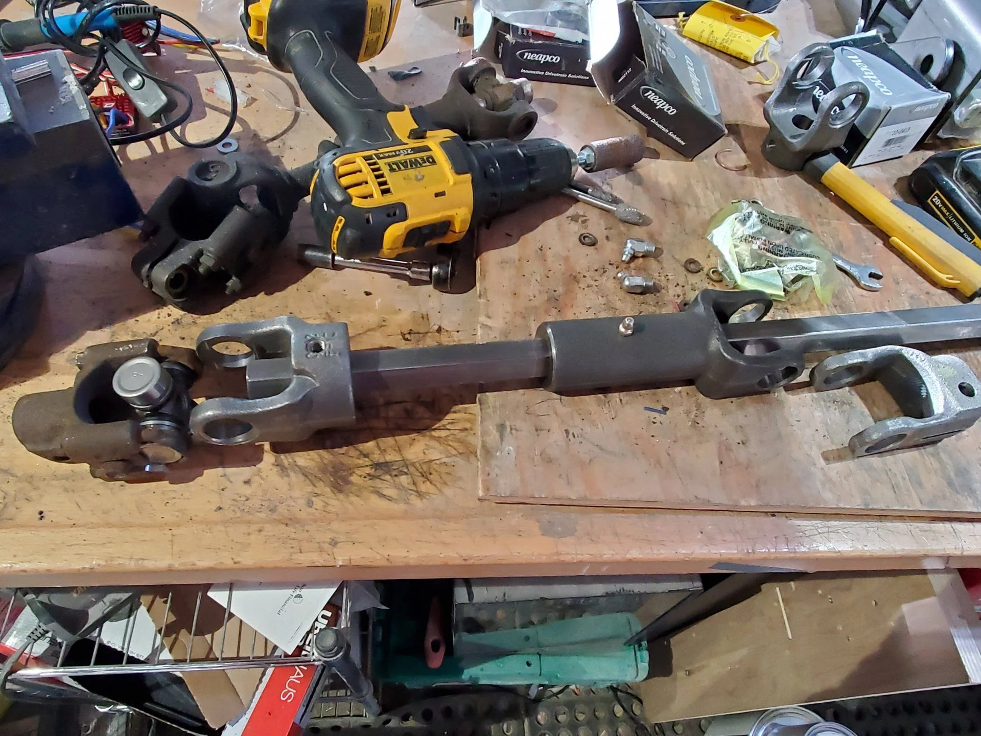

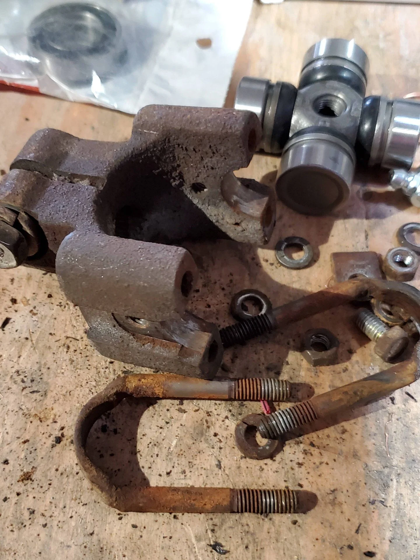

Because you all like pictures, My 4x4 lab stuff came last week and I finally had some time to play with it. The pitman arm clears, but is shorter, will have to see how that feels in the final set up. The 4x4lab stuff is certainly robust! Turns out the universal joint in the kit is just 2 mm wider in diameter and length than the stock so from the kit you can drop the first yoke and with a little light reaming, it just slides in there :)
