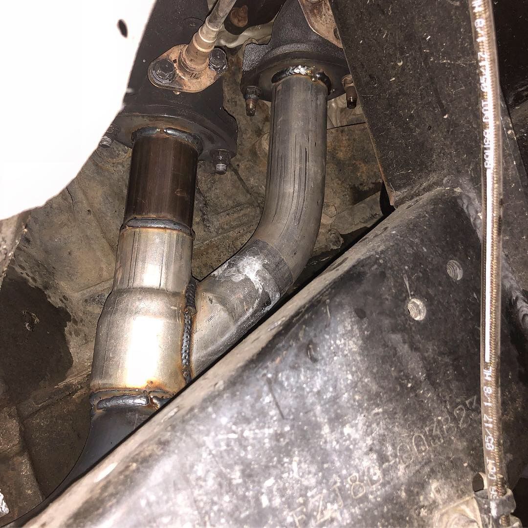

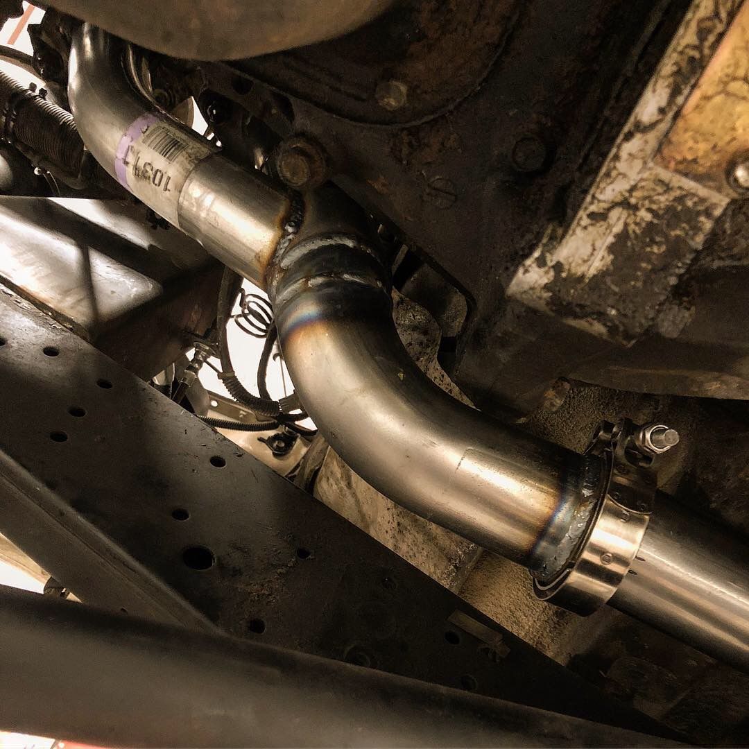

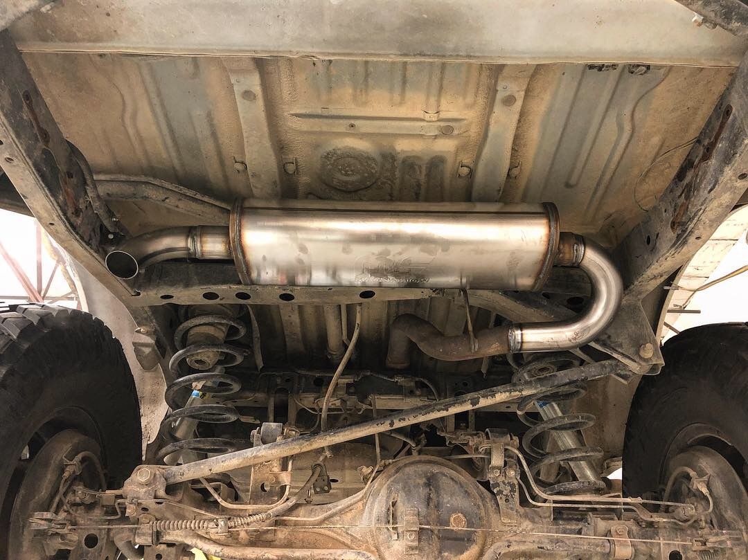

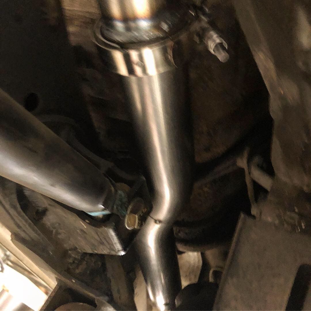

Custom exhaust tucked inside the frame
I put a flowmaster 50 series on. That was a mistake, it’s terribly loud and drones like hell. I called magnaflow and they said their quietest muffler is a “12276” and it’s 30” overall length. I purchased two of them, one will be installed in the factory muffler location and the other will be where the spare tire goes in the rear. I want this thing to be whisper quiet.
Do you have any pictures of the full exhaust? I am definitely interested in doing this mod. This past weekend when I was under mine the exhaust looks to get pretty close to some moving/critical parts if ran inside the frame vice outside.
How much did that new "Y" pipe set you back?
It will fit but it’s extremely tight. With labor and parts after I put these two other mufflers on, I’ll be in the whole exhaust around 7-800$. So not bad at all!
