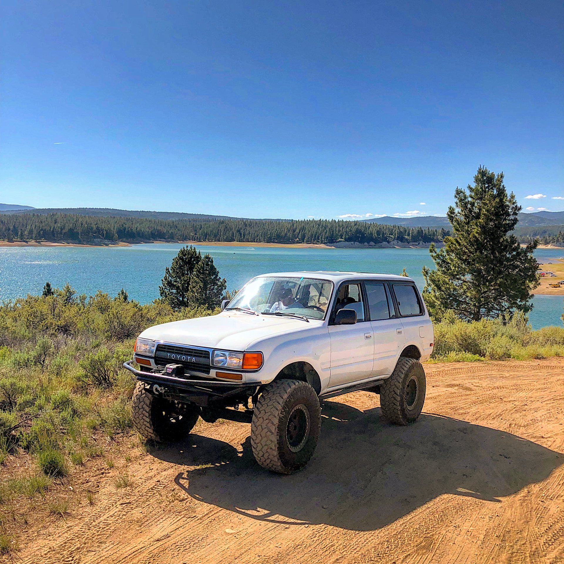

For sale. 18k obo
Lol, are @nukegoat, @jcardona1, and myself the only ones who have 3 linked our trucks and not sold them?
I don't think mine is marketable at this point
