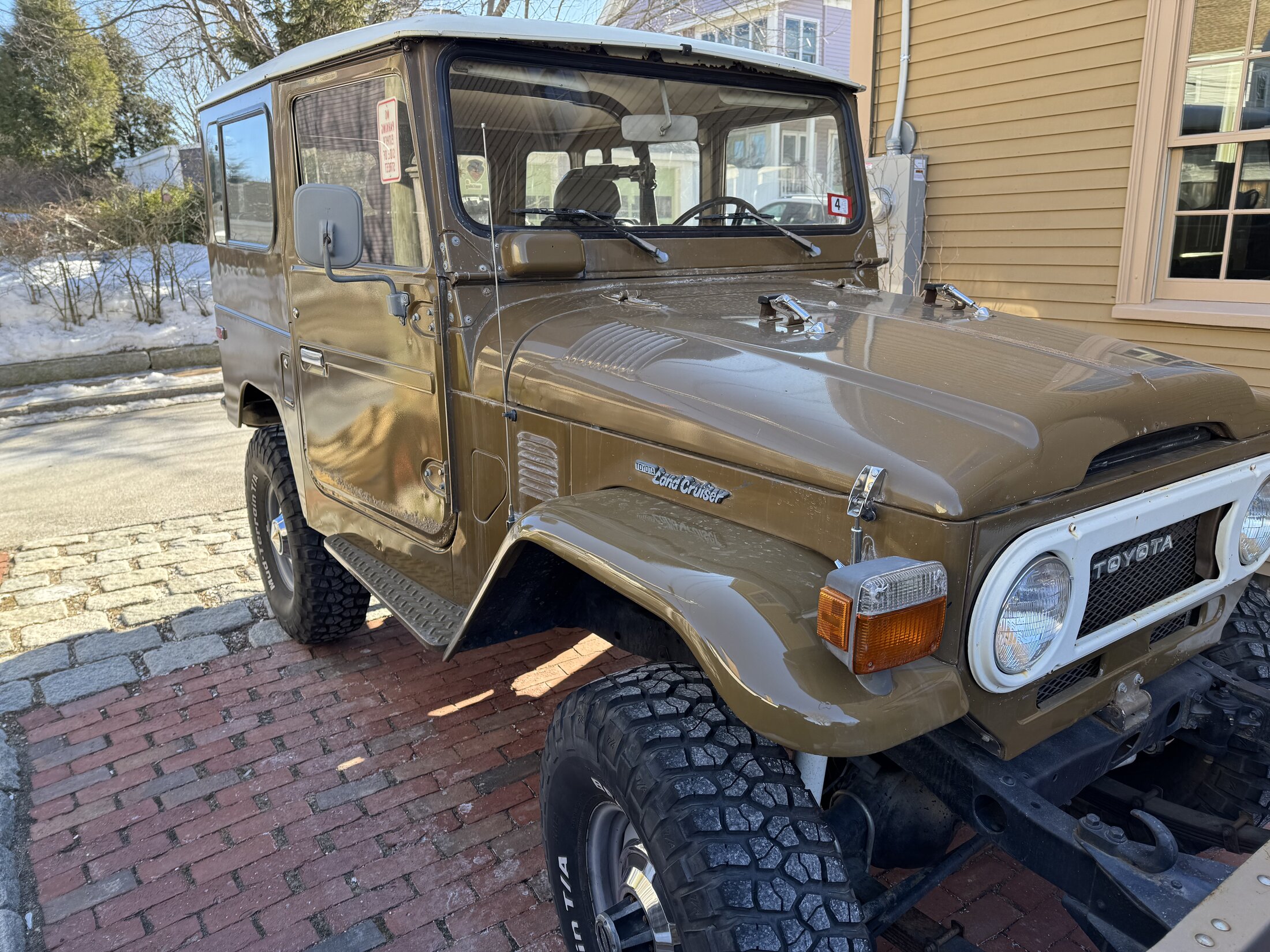

Good luck, it looks pretty good to me from the pics.

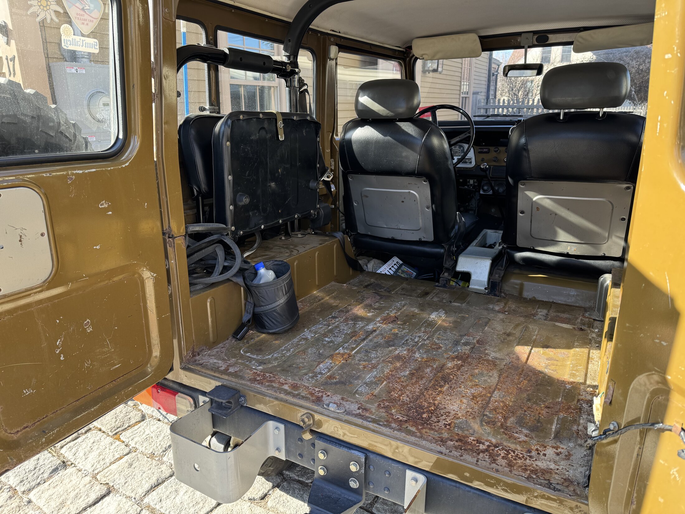

Seems pretty solid and I haven't seen any holes. I'll take, and post, more pictures of the backend when I get the chance.

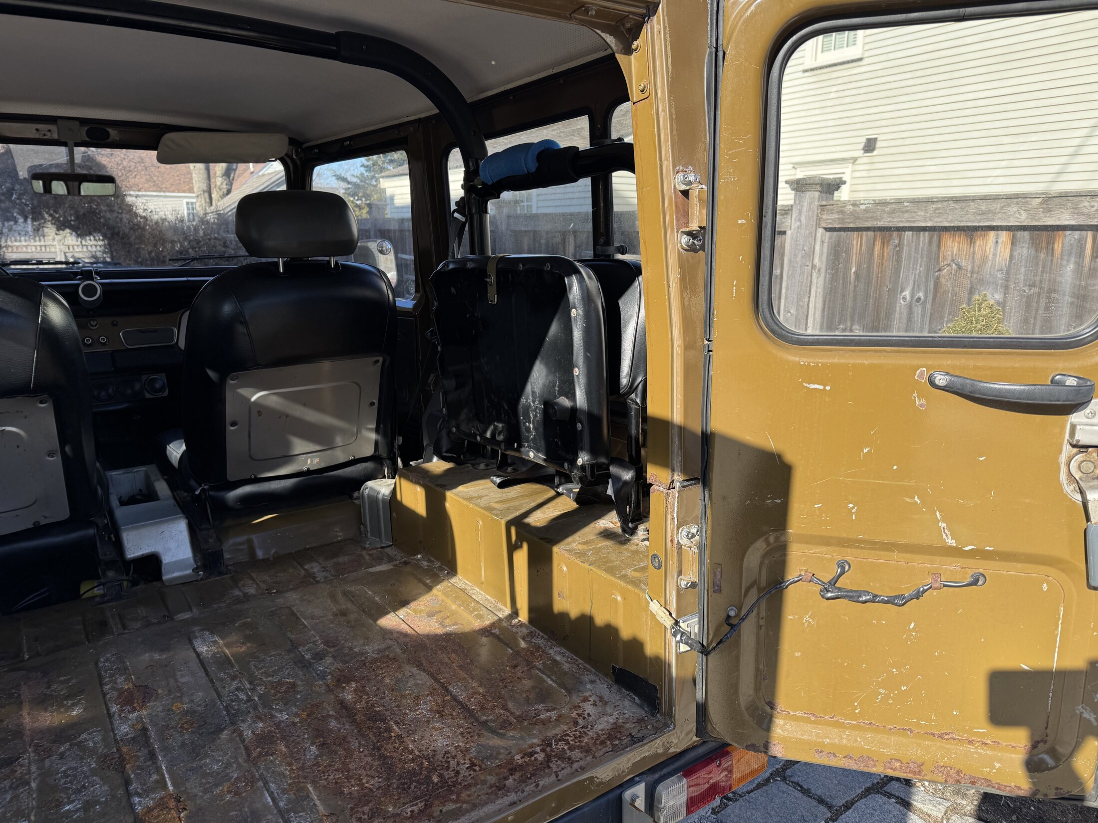

As promised ... More pictures:
I think that's in ok shape. I'd probably wire brush that rear floor to get most of the loose stuff off and treat it with a rust treatment, maybe something like osphos and.paint it with a similar color. Then find and cut a rubber matt. I went all out and stripped mine to bare metal, treated it, and 2 coats of rustoleum with a brush.
I've been reading through the thread by @dmaddox "1978 US Market Factory Restoration Thread." I'm both inspired and intimidated. I will likely do wire brush & rust treatment now, and then strip/treat/paint once the weather warms up.
I would try naval jelly first before you go to town with a wire brush. He might be surprised at the quality of the paint under it all.
In too good of shape to tear apart! We will all be good ideas buzzing around you on this - but I agree, use some naval jelly or rust treatment and clean everything up as best you can. Keep it dry and maintained. Restoration is a one way door, and I suggest taking a LOT of time to get to know the truck. It took 47 Years to get it to this shape, its not going to get any worse as you take even better care of it!
