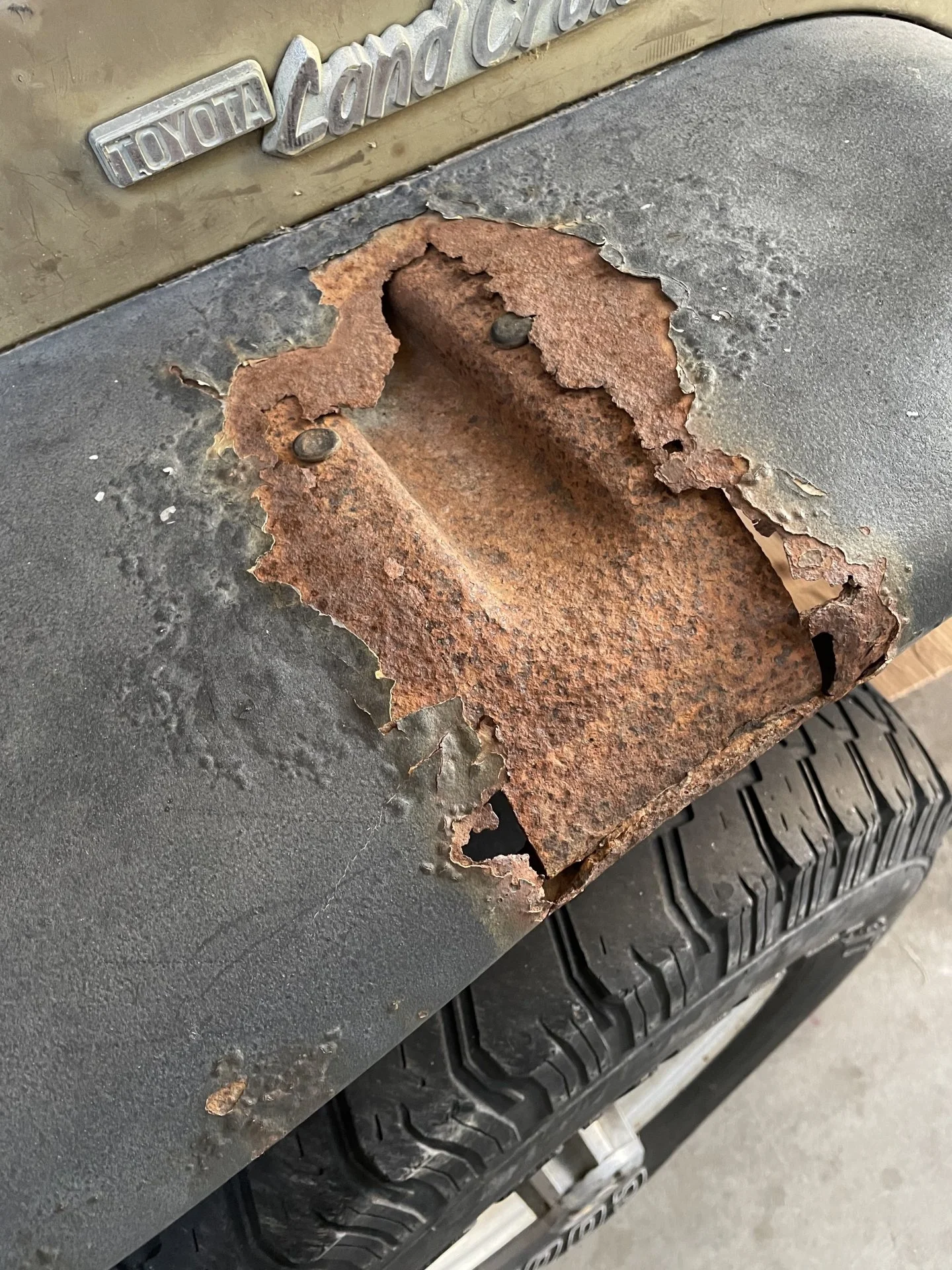

Still chipping away at this 78. Taking a turn toward this fender, other fender is much better. I'd rather fix than replace this fender. Anyone have any tips on how to tackle this? Decent metal and welding skills, just looking for some pointers. OR...not worth the time, just search for a replacement? Thanks fellas.

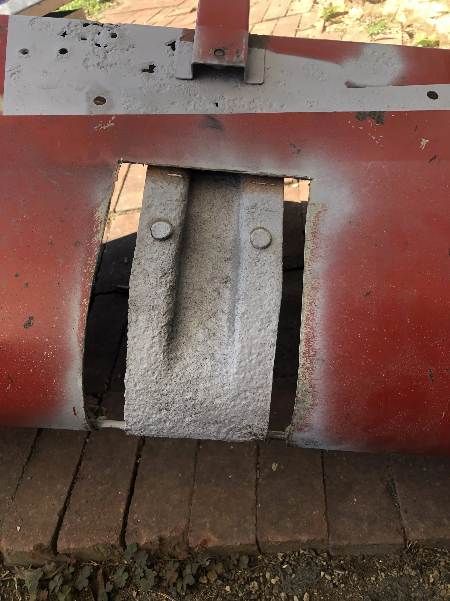

Mine wasn't rusted as bad. I removed the support bracket, blasted everything, cut out the rusted sheetmetal, fit and welded in new 18 ga, epoxy primed all areas that would be sandwiched, and welded the bracket back in. It wasn't too difficult. BTW, even though the passenger side was in good shape, I removed the bracket so I could de-rust and prime for posterity. While at it, I made a filler patch for the hole where the steering box used to be.

Certain regions of the country steel is find. It's obvious what happen here. The channel got plugged with dirt and was washed out. Dirt hold moisture and the fender rusted from the inside out. Skin of the fender is thinner than the support channel which is It's not gone yet. I have a few sixty year old cruisers with solid not rusted fenders. Wish I could say the same for the rear sill.

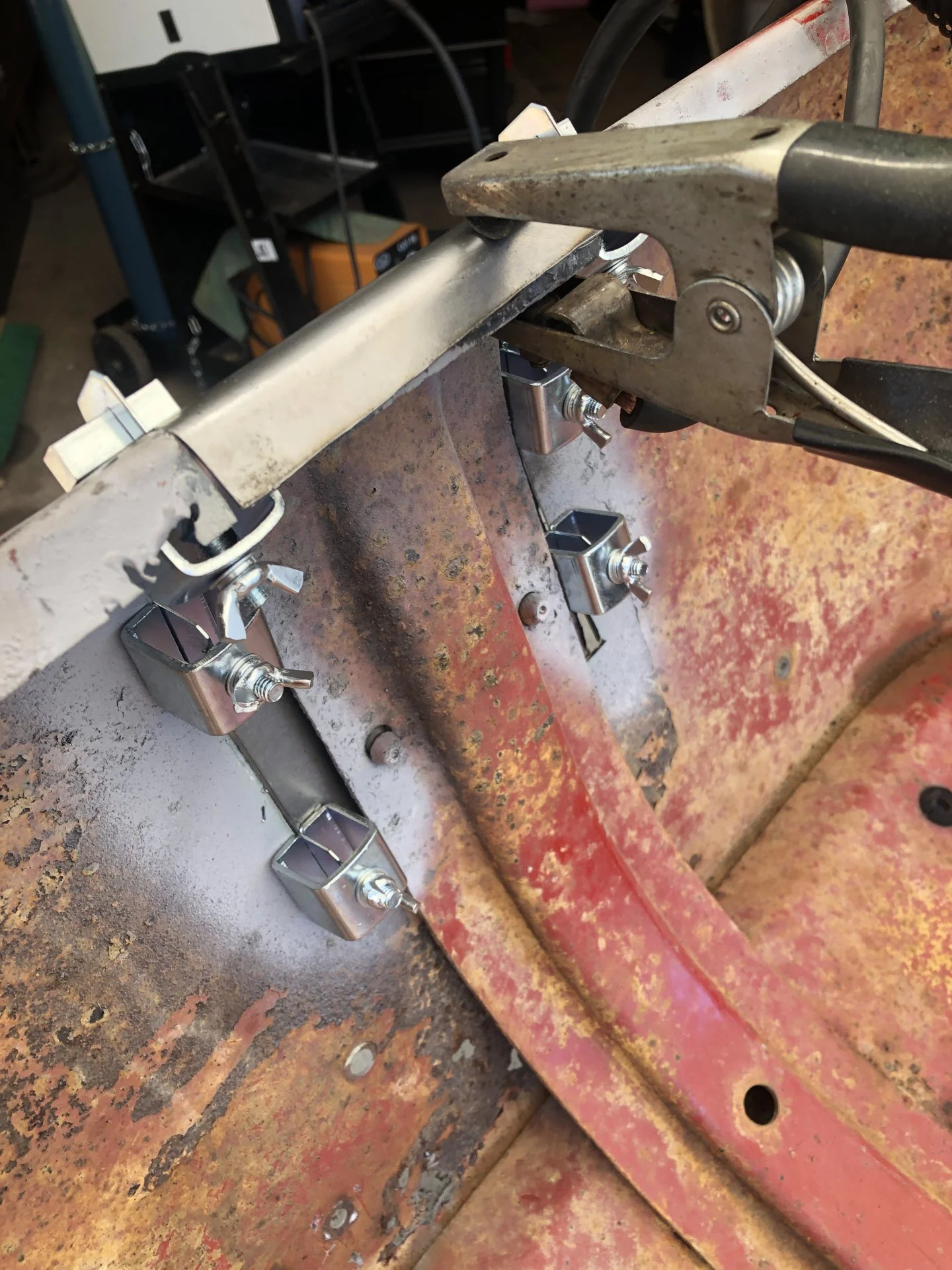

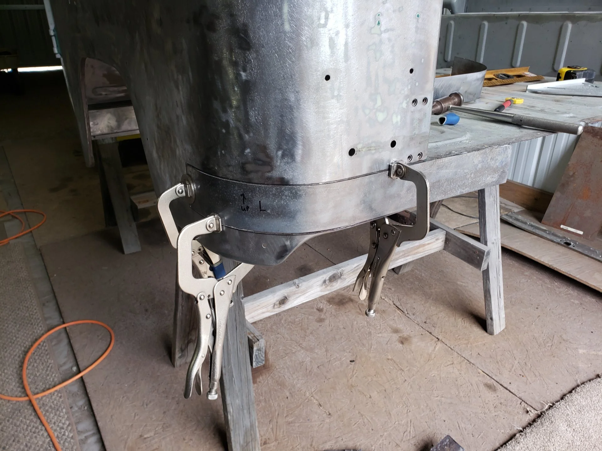

CAD design (cardboard aided drafting) 18 gauge sheet metal blank. Hobart Handler 140 with gas. Harbor Freight clamps. The need to take more time in between each weld as to not warp the metal.

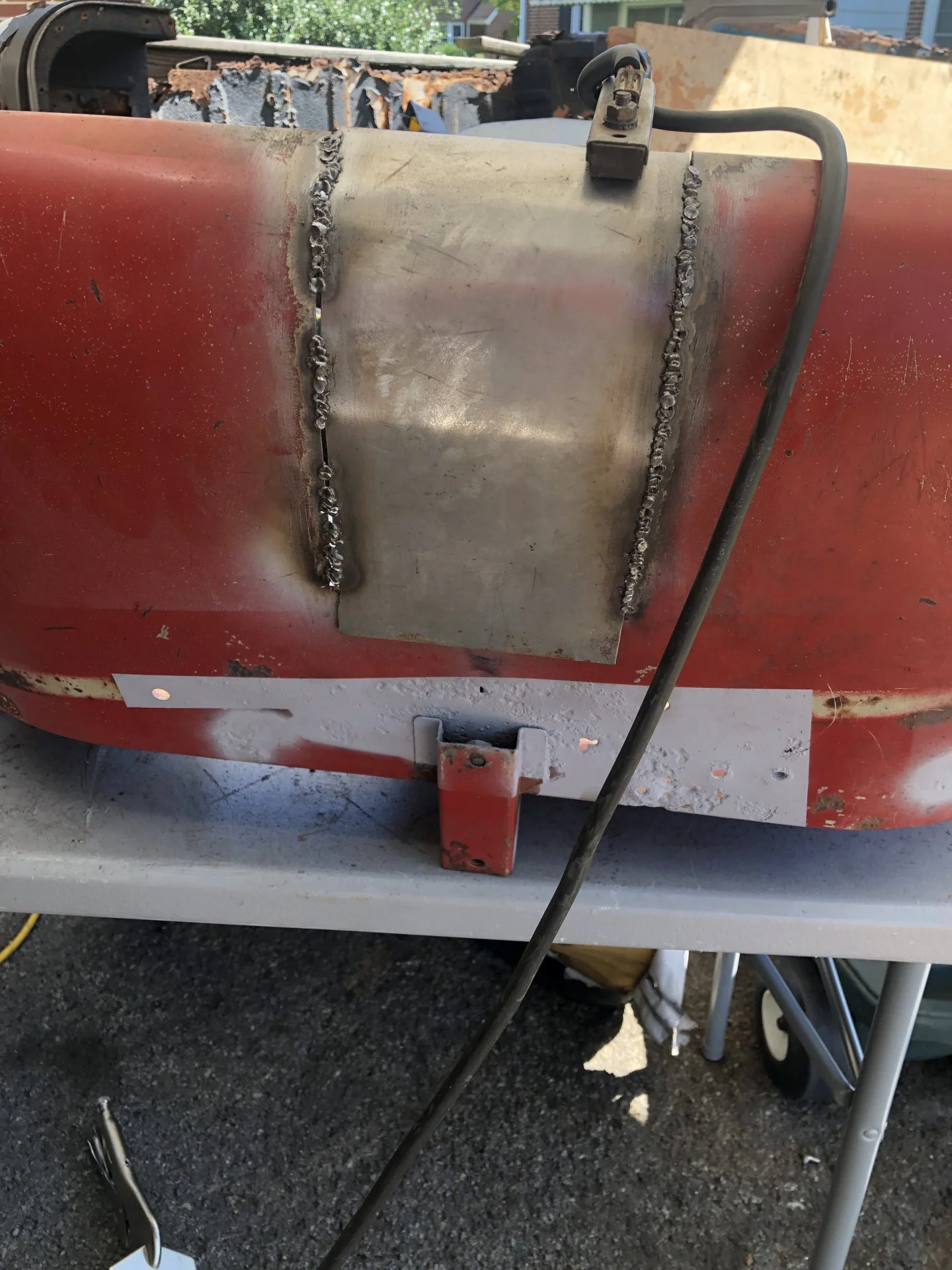

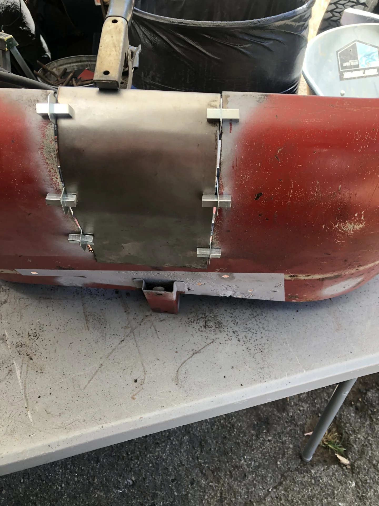

It appears you may already do this, but for others, stagger your welds. You wont have to do much waiting for cooling. I'll do a single spot, move to the other side and weld a spot, go back to the first side down 2 inches and weld another, etc. Then go back to the first and weld a spot connected to it. The welding isn't too bad, it's the grinding that takes forever. Also, I try to have zero gap and use the clamps in my patch photo, although that is a lap joint. Zero gap butt joint attached.
