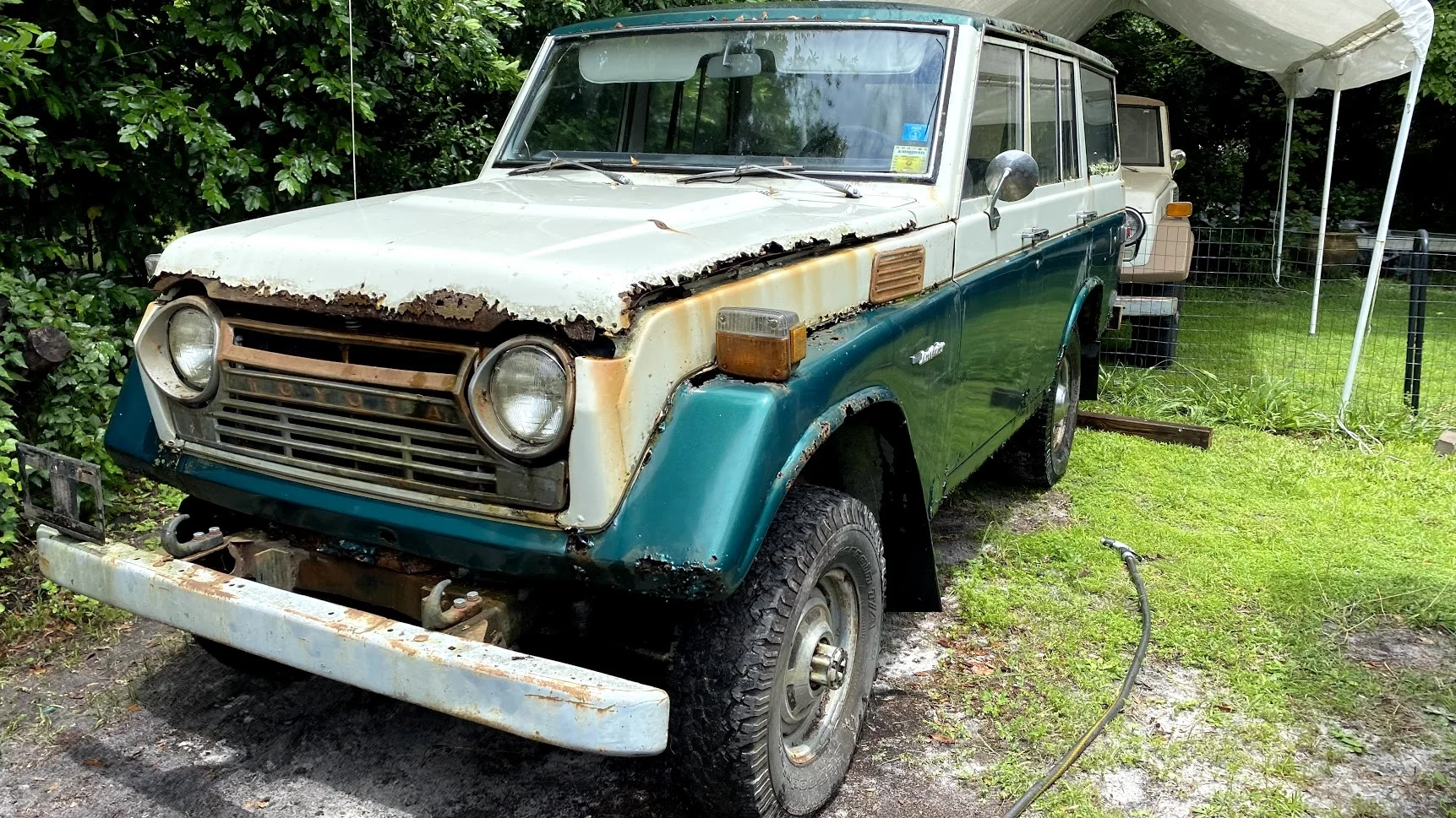

Cleaned it (kinda) and got it running after sitting for 10 years. Literally just shoved some starting fluid down the carb and it fired right up. Connected a 5gal gas tank to the fuel pump instead of running that crusty old gas straight into the engine and it runs amazingly. Really responsive, just doesn't idle, and it's LOUDDD. The exhaust has split apart in multiple places just from rusting through. Need to figure out how to drain the tank and then fill it up again, do these have a plug on the bottom of the tank? Need to get a brake booster for it as that's supposedly why it was parked... and then left to rot😞. Also, it moves, has 1st, 2nd, 3rd, 4th, and reverse, as well as Low Range. It was definitely restored (at least partially) at some point. The paint is really quite beautiful and the interior is pretty mint. Anyways here are some vids of it running and before and after the wash.

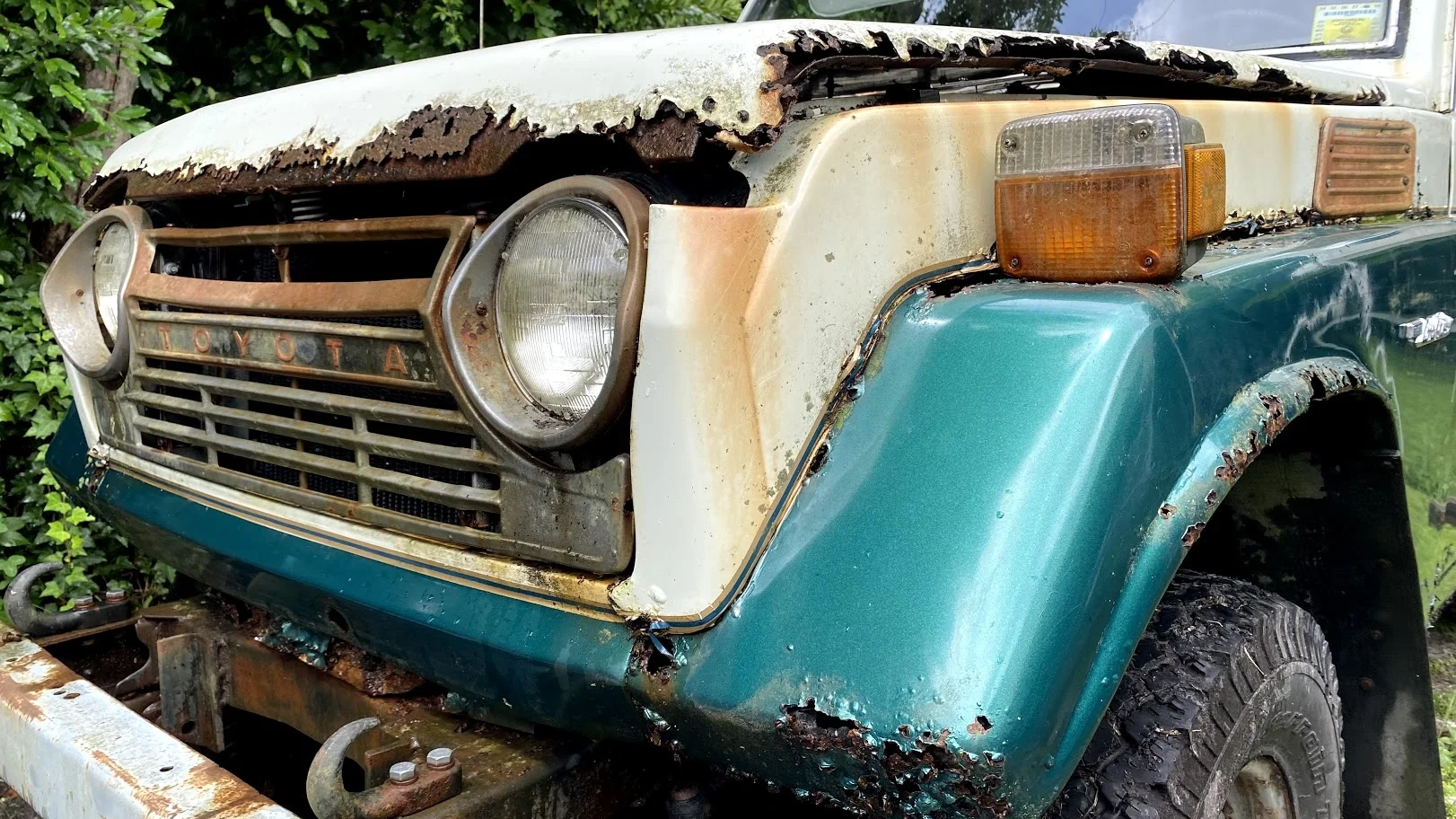

That body is gone.
Totally, I thought the turn signals were gonna fly out of the fenders on the way home! 😂

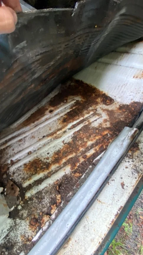

I’m thinking what do the floors look like?
Really not as bad as I thought, especially for the rest of the body. Very clear it rusted from the outside from just sitting under that tree in a coastal area for 10 years.

Rivet in some patch panels to hold the turn signals on, get a new hood, spray all the cavities/rust holes with fluid film, all new fluids an fully greased, and run it.
