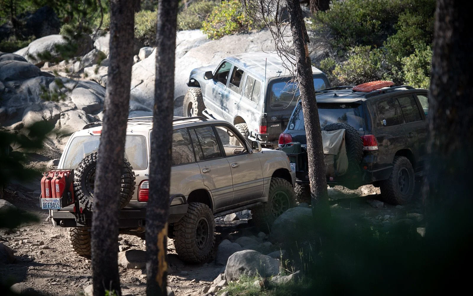

I ran the Rubicon in 2008 in an 80 on 4" and 35's, and was challenged considerably to keep the paint off the rocks. I woudn't take my 100 series through that trail.. just not meant for it. The 200 seems even more daunting honestly because of its size, there are spots where it's so narrow there just isn't much line selection. And many spots where one mirror was up against a rock, while the quarter panel on the other side was against another rock.. couldn't imagine if the vehicle was even 1" wider, or longer.
You would be legendary if you did this- but the guys having the most fun on that trail were the mini trucks & 40's, it's stressful in the wagons.
