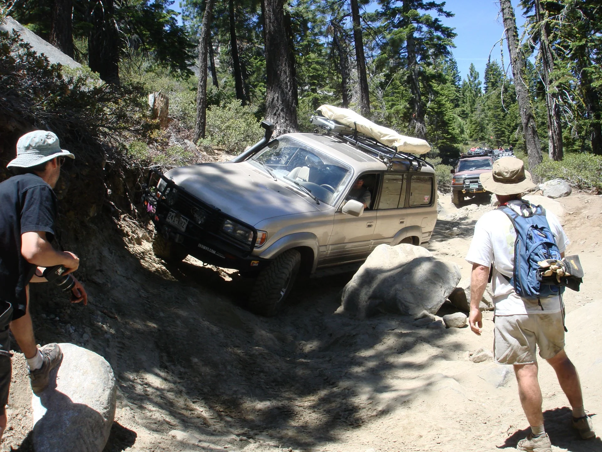

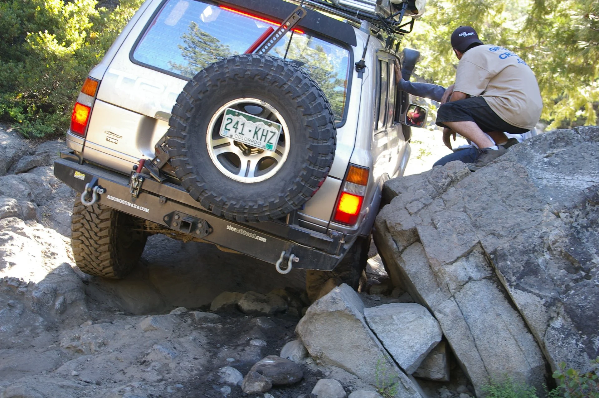

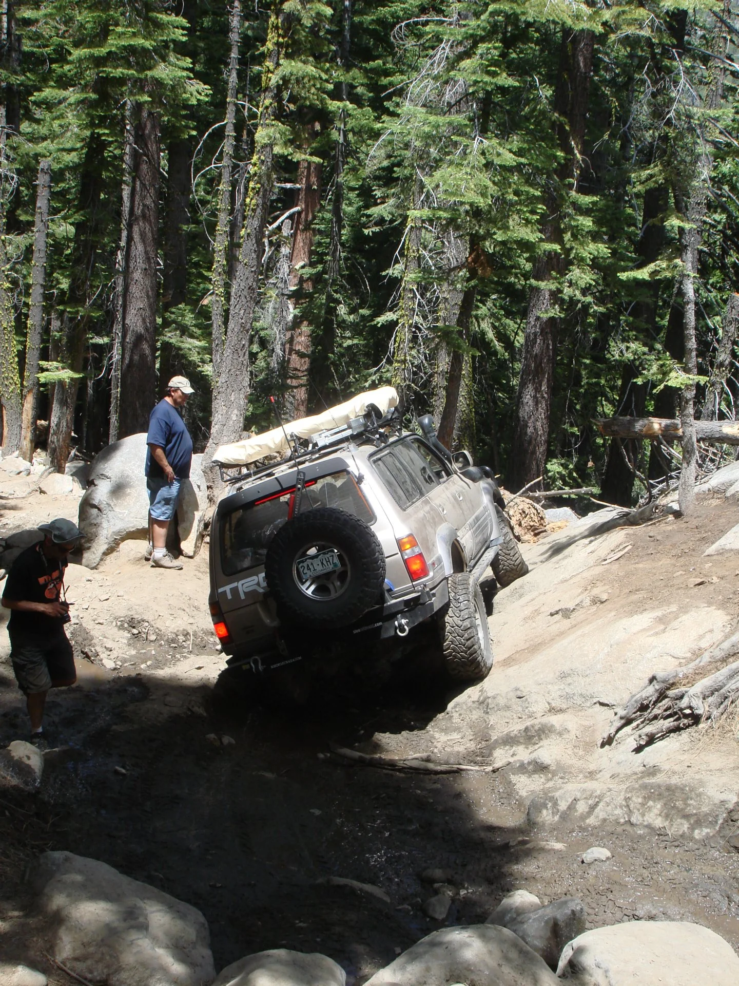

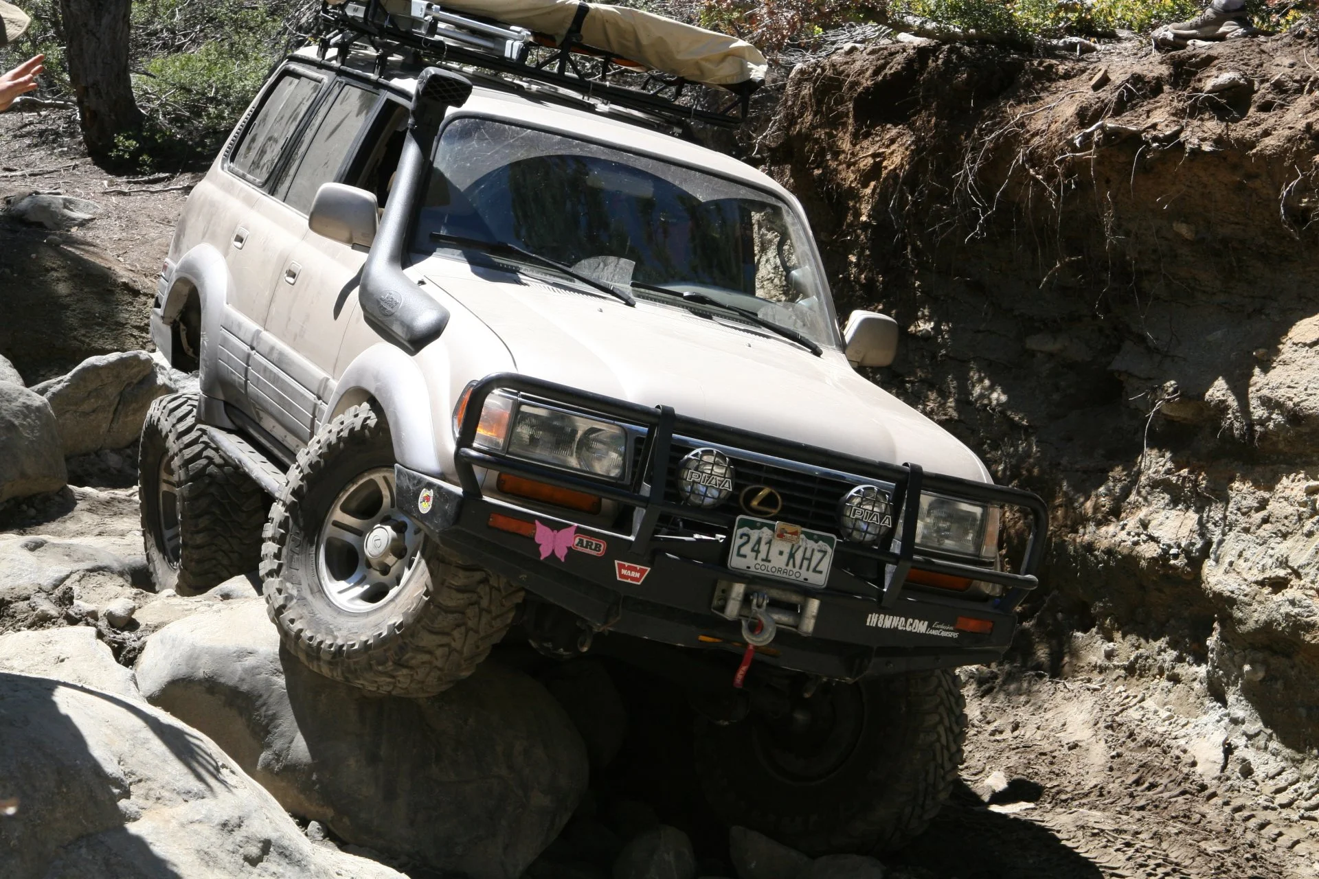

You need to be prepared for Body damage. It was tight in an 80 and I still got nicked a bit
You need to be proficient at power braking. If you try and use speed to overcome obstacles you will break something
From 2008, after you pass Little Sluice there are a set of trees that we had to have some folks push against the roof to clear
then followed by a Rock Garden Maze
Then on the way from Rubicon Springs, Cadillac hill is pretty tight
It is definitely a Bucket list run. You likely have run many obstacles as hard. It is just 3 days of non stop obstacles and easy to get tired so don't let yourself get dehydrated and lose focus
you will need spots in multiple places so going with a good group is key to succes

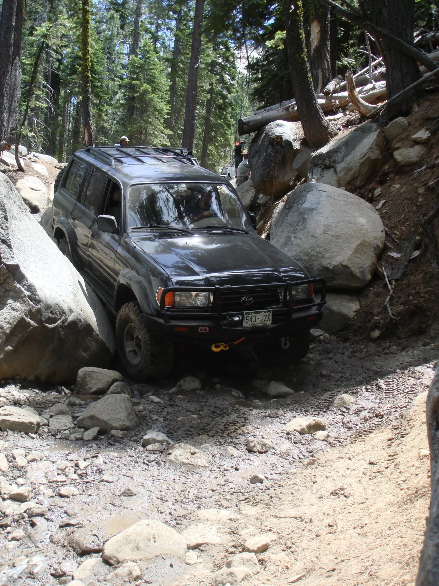

Little Sluice
