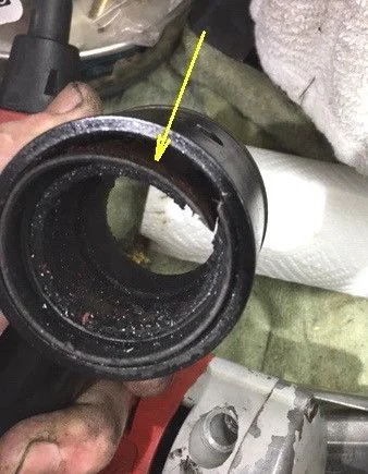

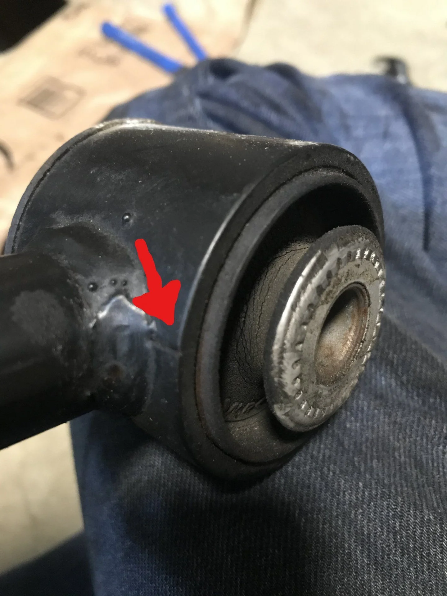

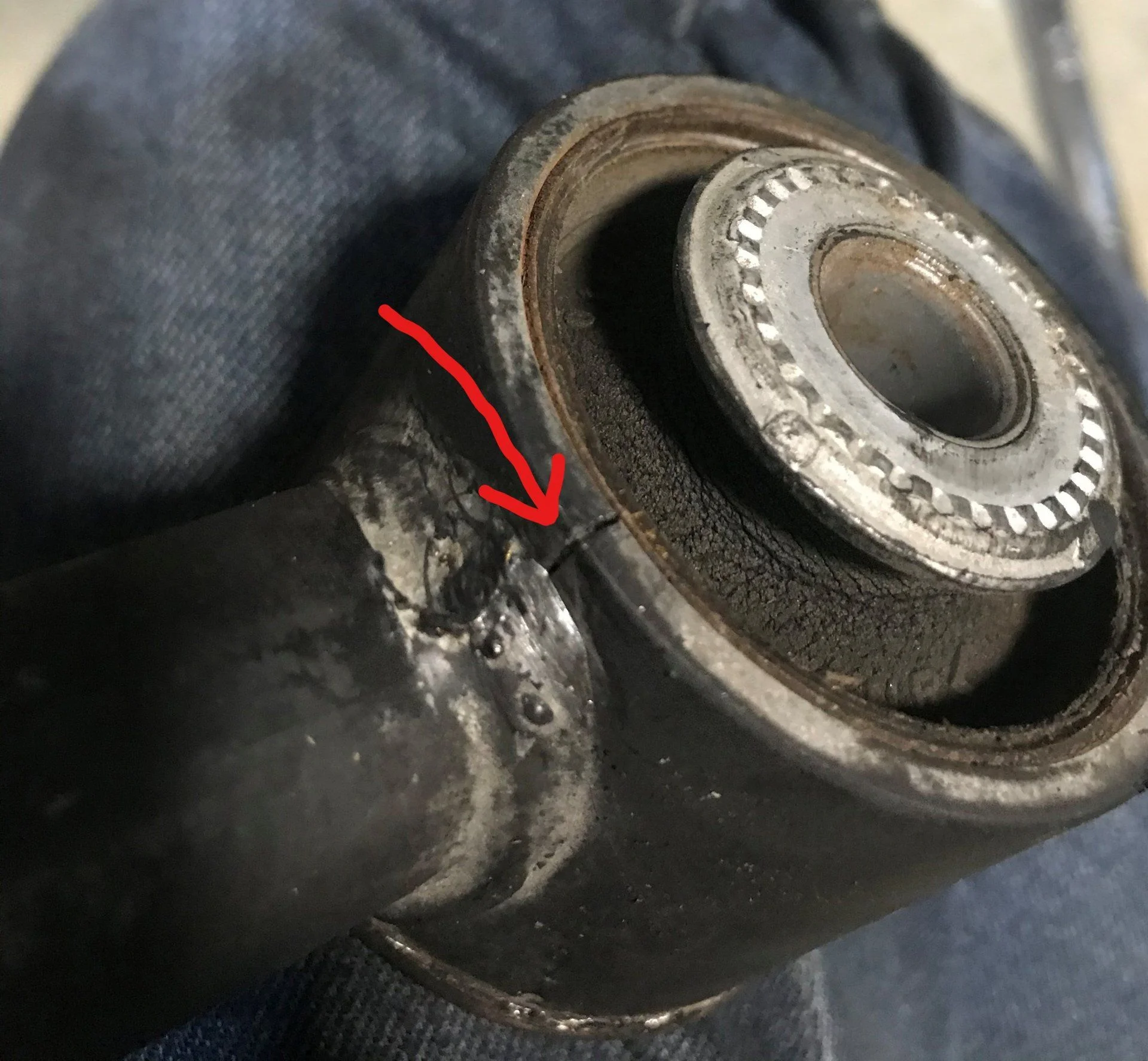

Working on pressing out my front end bushings/ball joints and all went well until the upper control arms. Working on the first one and I was pressing it in a not so great way and it didn't work. So I release the pressure and started looking at how I could make it better and I noticed a gap in the metal cup that houses the bushing where it looks like the two halves are welded together from the factory. I don't recall if it was there before I got started so it kind of freaked me out. I cleaned the area up a bit to see if I could see any cracks propagating from the gap, but I don't see any and it looks like the weld is still intact. Looking at the other arm It looks like the two pieces butt up against each other without a gap. What's the general consensus about this? Could it have come from the factory like this or did I bugger it up and a replacement is due?

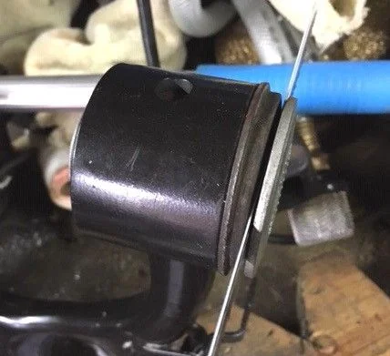

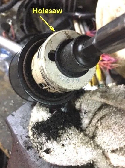

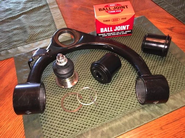

That’s how mine was from the factory. However, you will bend the UCAs trying to press those bushings out without heat and cutting the outer sleeve of the bushing. Torch ‘em.
Small update. Finally got one out. Drilled out the inner bushing material. Cut around it. Pressed out the inner stuff. Then cut the outer sleeve and worked on it with a hammer and chisel and the rest popped out. It sucks. Now on to the other three.
@flintknapper Your description and pictures is exactly what did it for me. Should add your comment and pictures to the FAQ for others to find quickly.
