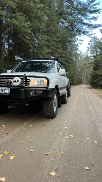

Pics to match! Ignore the scratches, she goes off-roading every now and then lol
