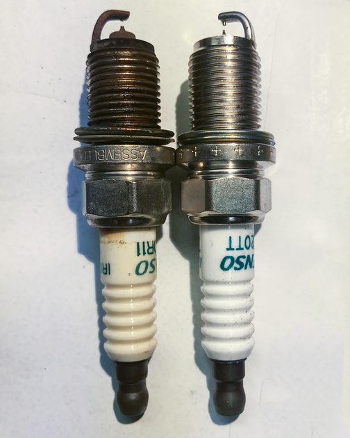

194k miles. Changed coil packs and plugs. Might've been the first time the plugs were touched. Some of them seemed to be very loose. Idk. Easy in / easy out. I used a 3/8" drive ratchet, 12" extension, swivel, then a 3" extension, then a plug socket with a magnet in it. I didn't have any problems pulling and installing #7. I dropped one bracket and that let the AC line move enough to pull and install the coil pack. Then pulled the bracket between #3 and #5.
Plug comparison:
