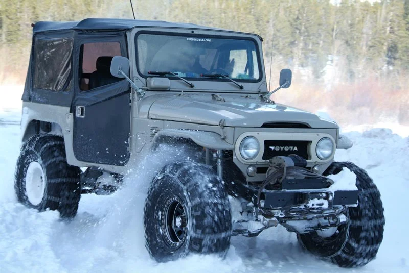

I almost missed it. More pics to follow...
My 1978 FJ40 shortly after purchase from Dave Armbruster (9/28/01). He says it probably had 400,000 miles on it when he sold it to me. The 2nd picture is from Cruise Moab 2006.
Specs:
12/78 FJ40LV
T416 Dune Beige
2F with well over 400,000 miles
MSD ignition
Weber 38/38
SM465 transmission
Orion 4:1 transfer case
Allied bead locks
37x12.5 Goodyear MTRs
1.25" Marlin wheel spacers
Lockright lockers front and rear
Fine spline 4:11s (I need to regear lower)
4" Northern Spring SUA
Flipped springs to lengthen the wheelbase to 96"
Downey cantilever shackles
Maf 4+ u-bolt flip kit
Metal-Tech 6 point family cage tied to the frame
Metal-Tech Fenders
Metal-Tech Nose Guard and Stinger
Metal-Tech Rear Bumper/Tire Carrier?
Metal-Tech Premiere Sliders
Longfields (I have 30 spline Longs and inner axles but haven't installed them yet)
Aisin hubs
Snackster
Hot Dogger
Trimmed rockers
Raised the rear wheel wells and extended them 8" wider that stock
Custom early bib conversion
Warn Belleview :D
Saginaw power steering conversion
Blue Torch Fab diff cover
I paid $2,500 for my '78 back in 2001. Added a 4" suspension lift and wheeled the snot out of it. Maybe you can help me understand what I was thinking when I bought it. :D

I help Mark out with banner ads, TT and Toy Owners adverts, and general graphic needs. In turn he lets me run his fine products. :) The 30 splines are for FJ60 axles;)
over 400,000, holy crap!! Has it been rebuilt??
Not that I am aware of. I do know that I ran a washer through the #1cylinder. I replaced the spark plug and she keeps on running. Oil needs to be straight 50 weight or she smokes.
You need a Quicktime video of the Evil Warn! :cool:
How do you like those cantelever shackles? Unloading issues?
Maybe if I take a video of the Warn it will steal it's soul! The shackles really don't open up like you would think. They do offer a better angle and that in turn allows the springs to lengthen.
i still want to know what happend to the mailbox.
I hammered out the dents so it pretty much looks like my rockers now :D

The hot dogger is on the headers, the snackster (Nakman's creation) is bolted to the valve cover. In the 2nd pic I was cooking corndogs and the mice found them when we were stopped for a bit.
