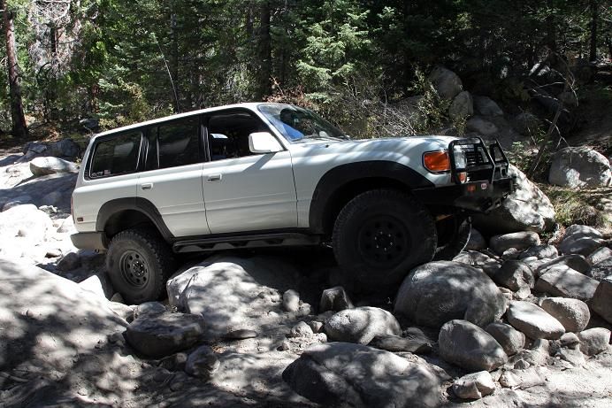

How would you compare FOR to OME springs (ride wise; stifness, and etc)?
I like the FOR springs very much, the ride is similar to the OME's but they hold a load better (less sagging with same weight). I really had hoped to replace my OME shocks by now with some valved according to what Nay and Frankie decided on so the shocks would be properly tuned to the springs. I imagine the ride would be even better. That being said it still rides fantastic, controlled but not harsh and minimal body roll. I still have both swaybars but dropped 1" each. Pretty good considering the truck weighs in at 6k lbs with all the crap we put on and the fact that we take that extra weight lift it higher to do the exploring/wheeling that we all love here. Except LX_TREME of course! :flipoff2:

Can you tell us more on your roof solution.
Nice rig!!
I removed the factory rack and drilled out the wellnuts, then I used aluminum tape to cover the holes and marked out the pattern in tape. I just followed the molded ridges in the roof and the basic footp print of the factory racks to cover up all the scuffed and damaged paint. Then applied Durabak like "normal" on the rest of the truck. concretejungle has a great write up on his Durabak process that I used when I did mine.
Can you post the link for this? I couldn't find anything on Google. I have convinced my Tundra owning friend to remove the flares he is complaining about coming lose and rhino/durabak the fenders. I have offered to lend a hand and want to get schooled since I convinced him to use his vehicle as a giny pig (SP?)

Forgot to mention earlier and these flare/roof rack and roofrack adhesive threads by Brent might also be helpfull. Glad you found concrete's threads. Oh, guinea pig. ;)
All I can add about the durabak is prep, prep and prep the surface and you will be just fine.
