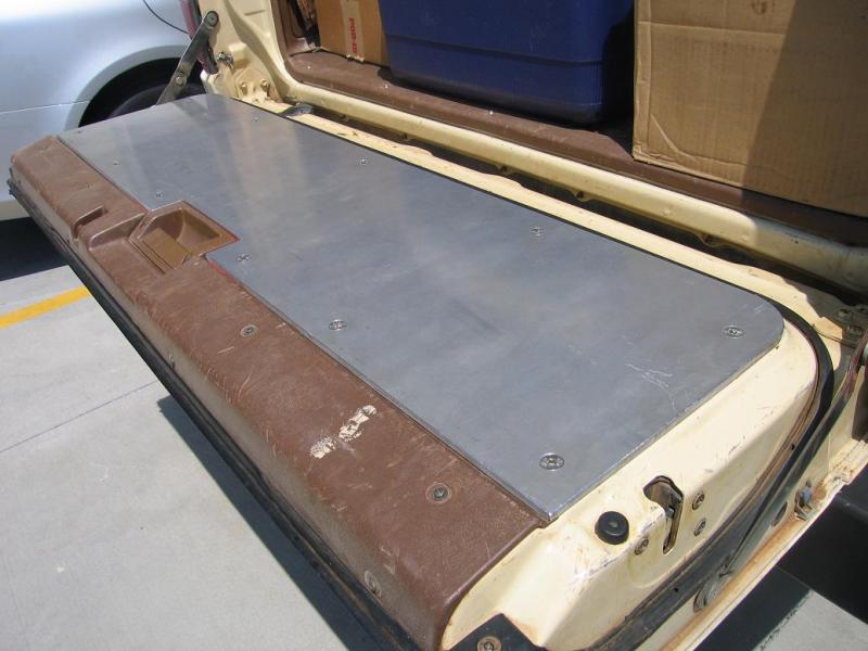

I installed the aluminum plate tailgate cover that I had cut last winter. I also replaced the factory screws and inserts on the cargo trim strip with stainless nutserts and stainless, allen-head cap screws. That stupid piece of trim has never wanted to stay fastened in place but it does now. I also did the same to the factory door threshold trim pieces while I was at it (not that they were ever a problem).

Here's a pic of the tailgate. Not sure I took one of the engine with the new intake. I will have to check the camera.

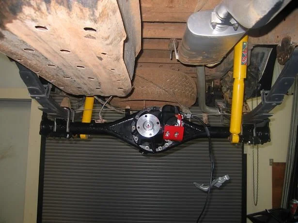

Nice 4runner...Ive been following this thread since the beginning...love to see someone caring for one of these old classics rather than chopping it up for a rock crawler...:clap: Just curious how the OME springs are holding up for you?
Ive got an '85 runner as well and seriously considering the OME springs because I dont want to have to modify the truck.
A vendor just told me that the OME truck springs do not have the military wrap...is that right? Do you have close up pics of yours?
Also I didnt see in your thread where the difference in height between the passenger and drivers side perches is mentioned. OME shows the has the same part # for the front springs..CS008FA. Did they provide a spring pad for you? What am I missing? :confused:
The springs are great. Just enough lift to not be obnoxious and you can easily fit 33s if you are so inclined. They do have full military wrap (see photo of front and rear). They do not come with a plate or anything for the front and I think my front springs are identical. I have never noticed a lean but I just went out and measured. The front passenger side is 1/2" higher (axle to fender well) than the driver's side front and 1/4" higher in the rear. You really can't see it even if you try to convince yourself that it's leaning. The last photo was taken on a side slope (left to right) but I moved the 4Runner to level ground before taking the measurements. You could always put a small plate on top of the spring perch if it bothers you.
I'm sure it's somewhere in the thread but we went heavy up front and medium in the rear.
