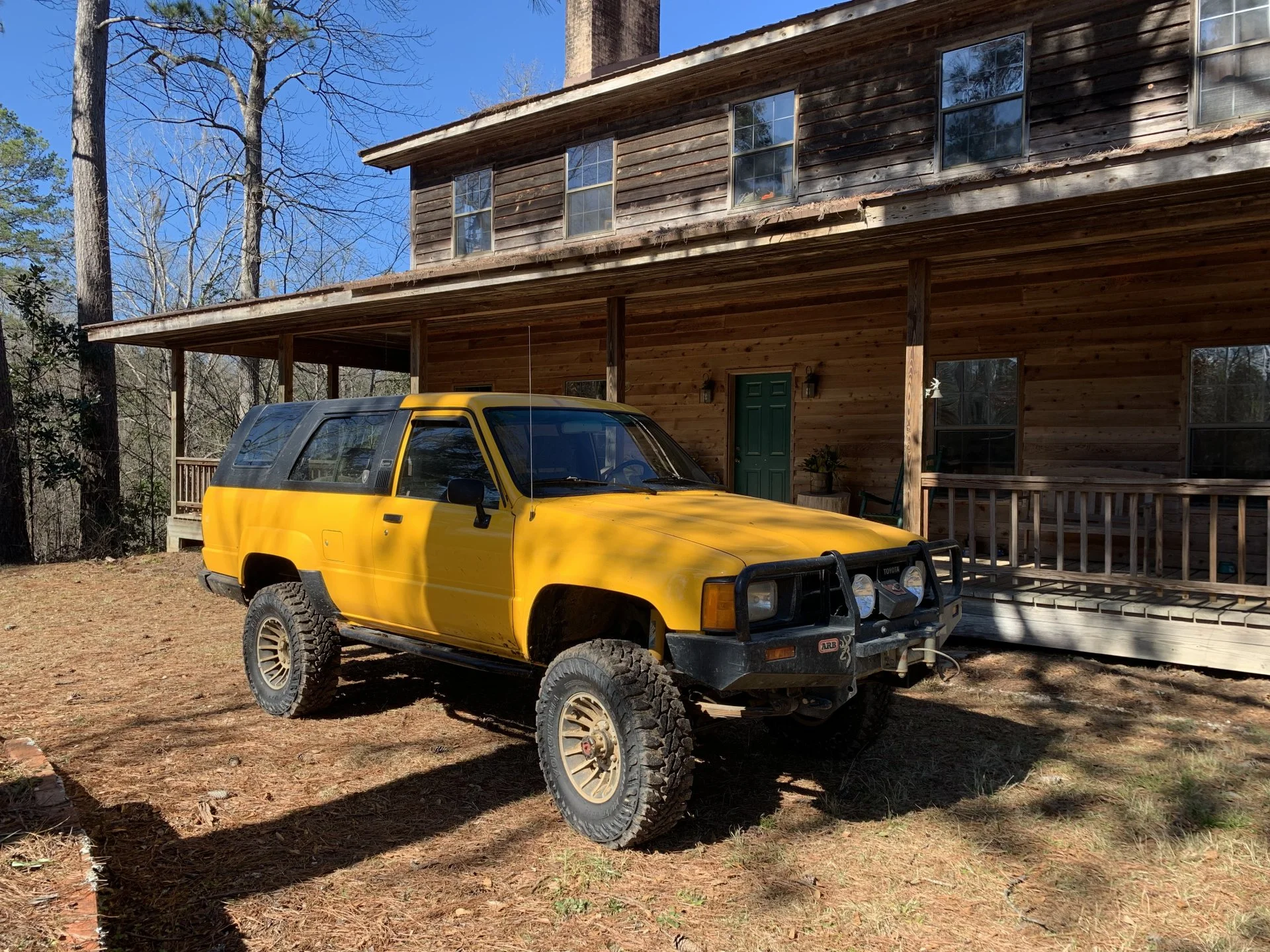

Thought I should update this thread with some photos. New paint (Toyota Sun Fusion yellow), new carpet and new seats front and rear (1995 SR5 4Runner).
Exterior first:

Super nice! I'm new here, bringing up an 87 that's been neglected. Question about the fender flares. Bushwacker Extend A Flare...not cutouts. They don't show those EAF's available for T4R on BW site, but do for pickups. However, pickups of same model years have a fuel door cut out in the RR flare.
I don't see picks of your passenger side, so don't know if your flare has that cut out.
What model number did you get? Perhaps things have changed at BW.
Help appreciated, and way nice rig! Thanks.

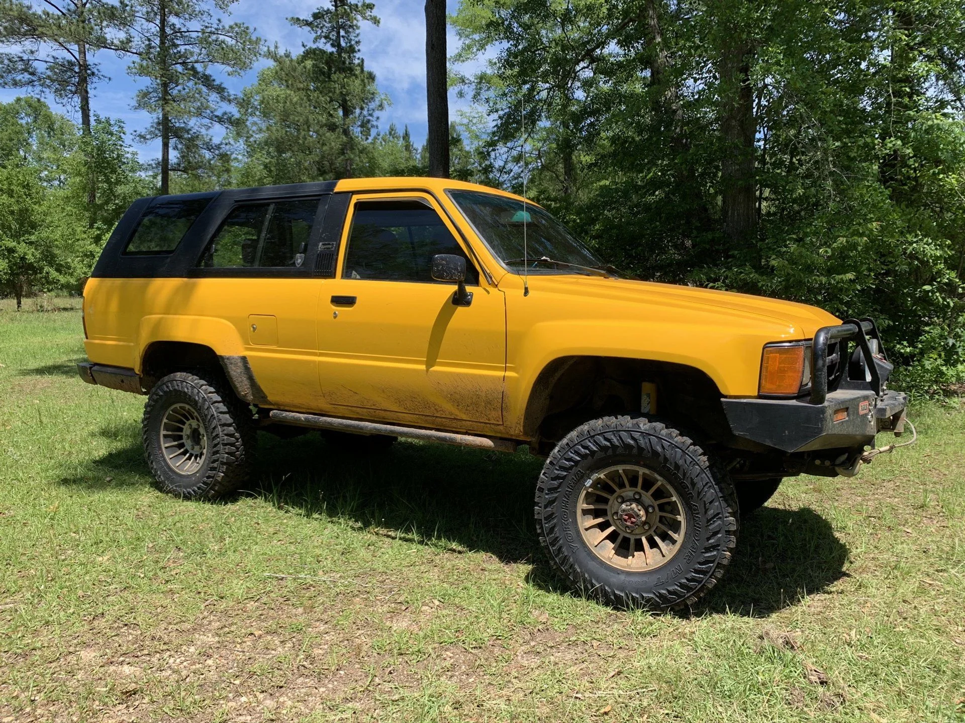

New shoes to replace the 12 yo BFGs.
Spent a couple of days on our property this week and pulled the 4Runner out of hibernation for a spin in the woods. I keep it on a battery tender with seafoam in the tank. Cranked right up and ran well. :princess: is pushing to take this one back to the OEM paint color. I might have to accommodate her given her support with all my Land Cruisers.
