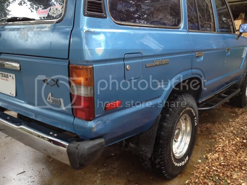

It sucks but nothing I can't fix. Fixed just about everything else on this haha
Thanks for the condolences :)
those are just character marks :D.... You are lucky, it doesn't matter where i dent the quarters on my 60 i always bust a tail light lens... But that will soon be fixed....
:crybaby:
Notice how nothing was broken. Gas door is fine. Tail light lens is fine. Side marker is fine. Just got some nasty dents.
:crybaby:
NOOOOOO NOT THE BEAUTIFUL!!!!!!!! :crybaby:
