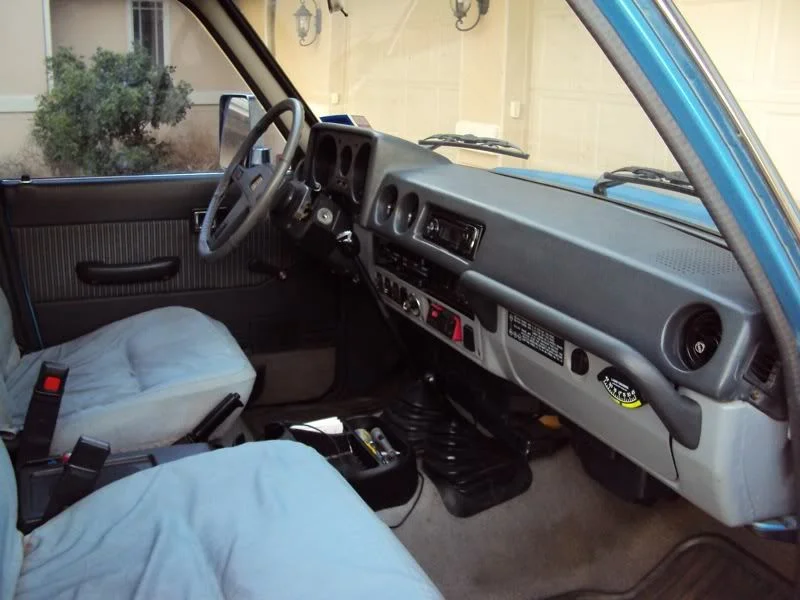

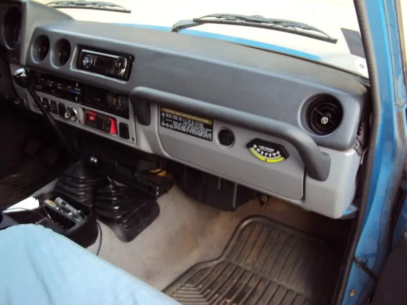

Found an FJ62 with a hand throttle and a grab bar in my local junkyard.
Had to post some cruiserporn!
Freaking awesome stuff.
And the 60 :D
:cheers:

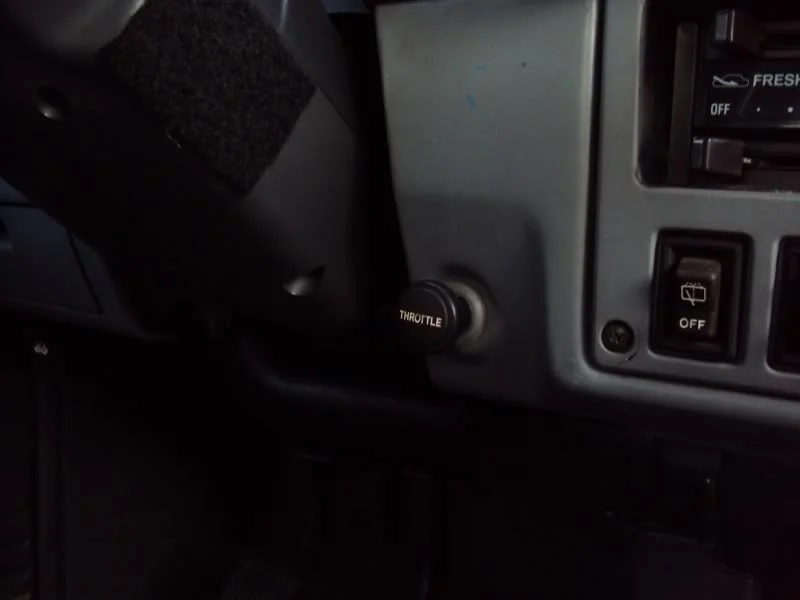

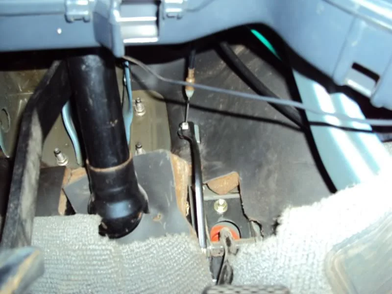

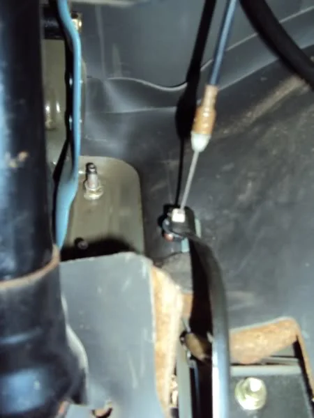

sweet!! is the hand throttle functional? any pics of the linkage?
Of course it is!
They are kinda blurry but its the best I can snap under there :D
Just took a short drive.

Thanks for the pics of the linkage! thats awesome. i want one!

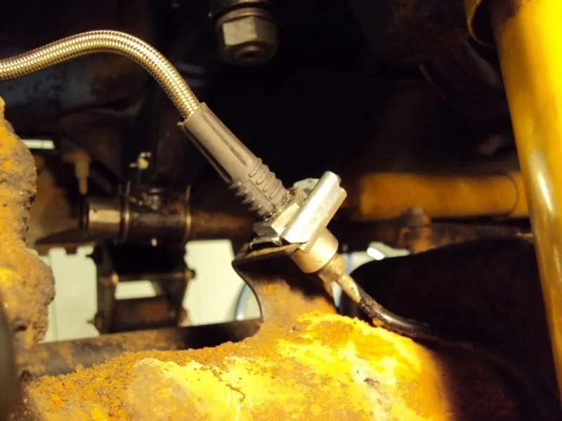

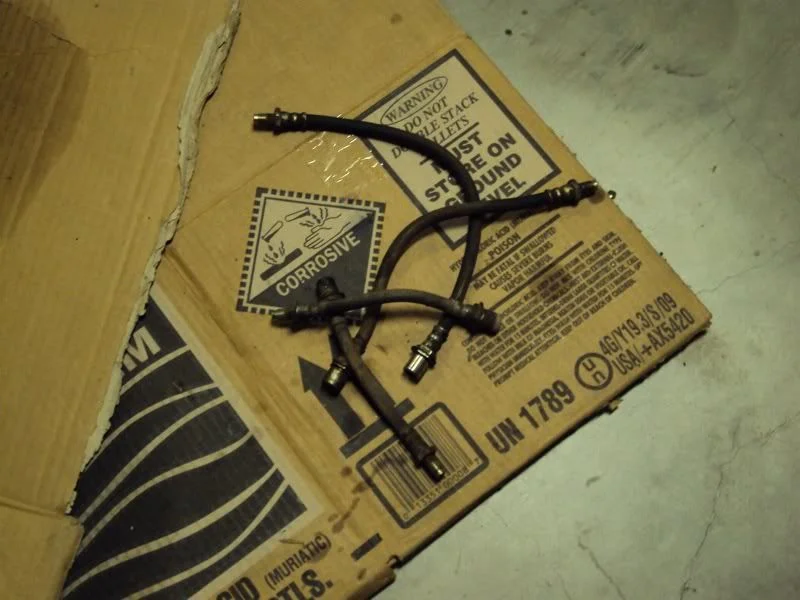

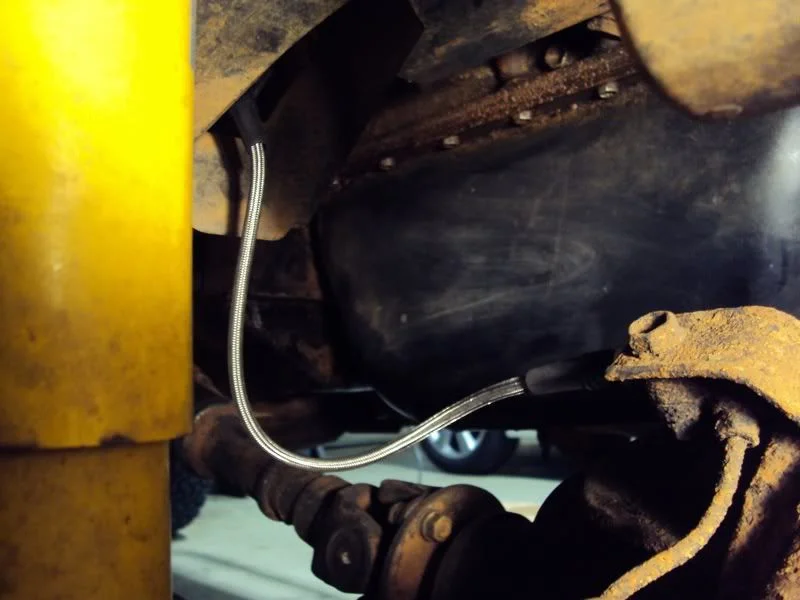

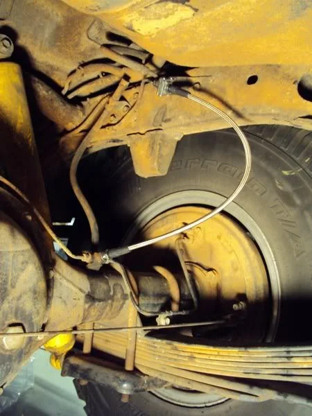

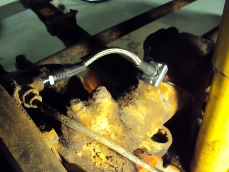

I finally got my Man-A-Fre Stainless Steel brake lines installed. Very nice quality. I had to file one bracket on the front axle to get the part to fit properly. No harm done. Worth it.
Now I can actually flex my suspension :D
Little line to the knuckle
How I used the clips Man-A-Fre included. And the stock clip in the original spot.
Front Line
Rear Line
Old, cracked, and plain worn out!
Also I tightened up my Tie Rod Ends because I noticed they were loose, love the easy fixes!

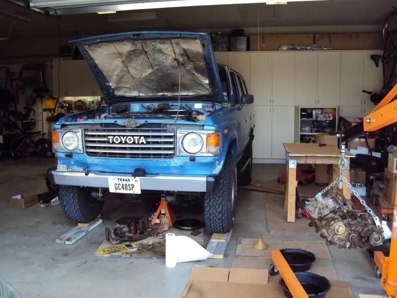

Been working on the cruiser lately.

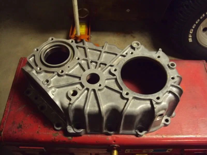

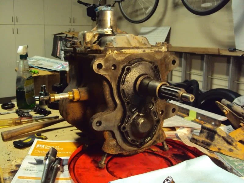

The transfer-case was leaking everywhere but the front output. The engine was leaking from the galley plug behind the bell housing.
Got everything apart a couple days ago. Been running to the dealer for parts. Free shipping and the prices aren't that bad. Especially for the odd things I need.
On with the pics!
Nasty bugger
Oil leak
The work area:
Yummy
Rear output was hard as a rock. It broke when I took it out.
Moved the rest of the pics and text to post #131
Stole the "feet" idea from Kynot 62. Thanks Tony!

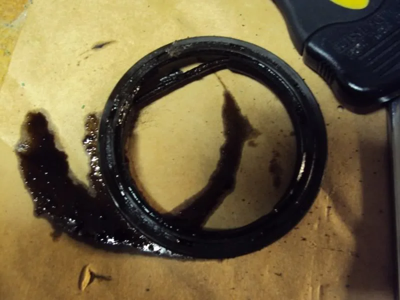

Failed transmission to transfercase seal. Yes there is a hole in it.
Cleaned up with BBQ Grill cleaner! Must be some nasty chemicals in that haha

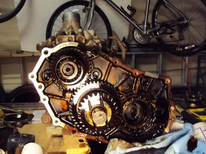

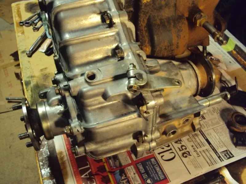

Cleaned up and starting to reassemble

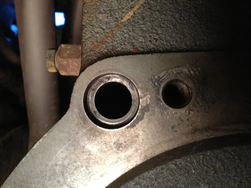

The new plug for the back of the motor. I bought two just in case.
Part #90330-24013
About to head back out there. t-case wants some gears back in it :)

Excellent. How do you get the old plug out?
I haven't yet :hillbilly:
Probably gonna drill a hole in it and pry it out with a screwdriver. I don't think it'll be too hard to get out.

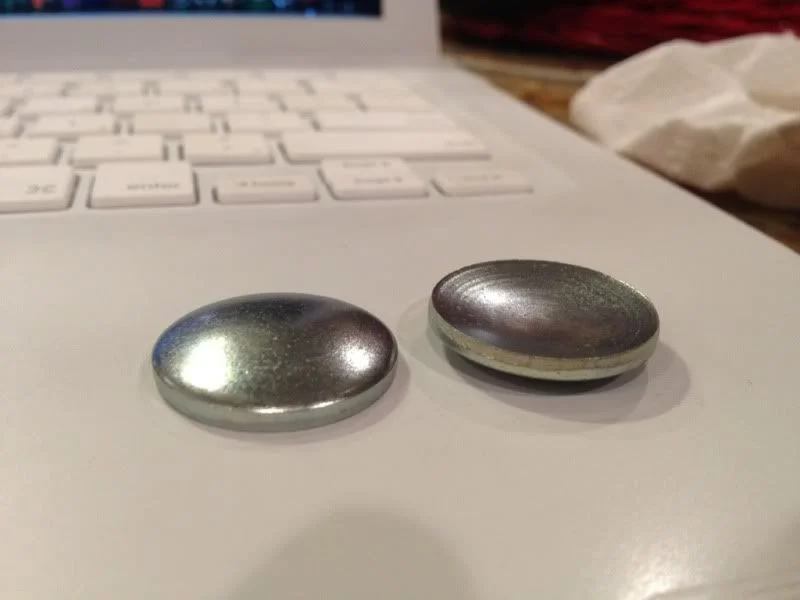

Got that old plug out. I just drove in the center with a punch and it loosened up and came out. My machine shop did replace it. It was an aftermarket plug that was already driven in too far. Hence the leaking. The Toyota plug is much thicker, kinda hard to hammer in. I'm including two photos one of the blank hole and one of the plug I installed. I can't really get it to flatten out.
The marks are from the wheel stud I used to install it. Shouldn't really impact anything I hope. I have another one just in case :) I also put a very light coat of silicon around it. I'm scared this is gonna leak once I have it back together.

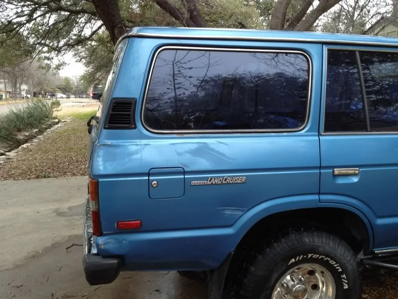

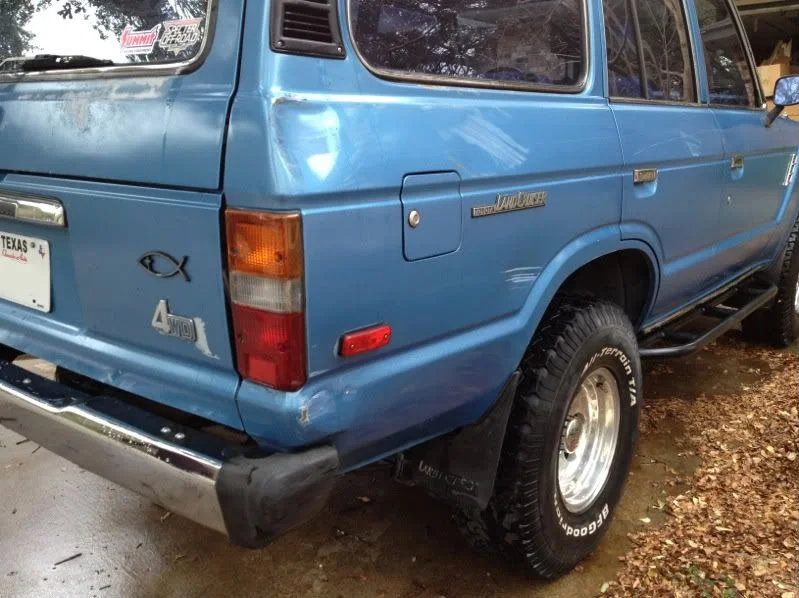

I got the leaks fixed. Been driving it around. Took it to Hidden Falls before I went back to school and dented it. Sucks, but I'll get it fixed in the future. Along with a paint job. That will be a costly experience. Then no more tight trails for me. I don't like denting my 60 its a :princess:
:crybaby:
Notice how nothing was broken. Gas door is fine. Tail light lens is fine. Side marker is fine. Just got some nasty dents.
:crybaby:
Ouch! Unfortunately that won't just buff out. Looks like it'll pop out fairly easily with a stud puller though. This last year I bought a weld-on stud puller to work on my FJ40. All I'll say is that the days of drilling and pulling are long gone! A cool side benefit to them is that they shrink the metal, so as long as your dent isn't crazy you can get away with very little filler.
