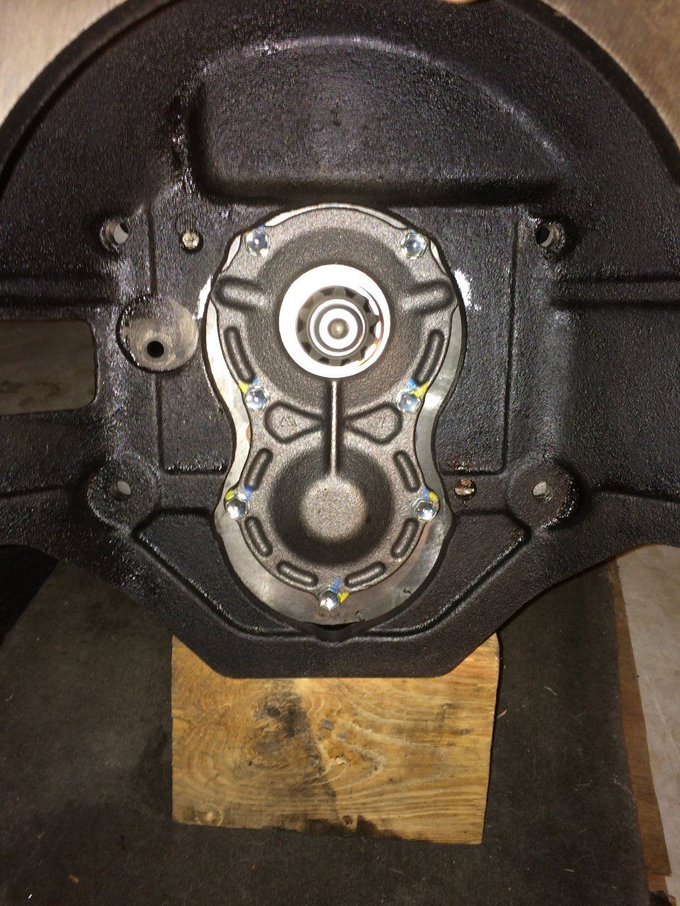

I also modified my 1984 bellhousing to fit the 5 speed. Just a little bit needs to come off so it can bolt up. I tried to match the look of the other cut-outs but I got to a happy spot and called it quits.
In this photo you can see where it's not going to fit. I marked in the right spots, but couldn't get a perfect hold.
The front bearing retainer of the 5 speed.
Where I called it good.

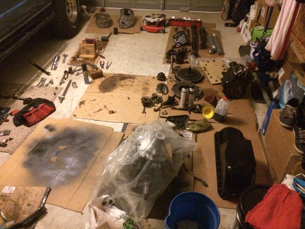

I have been working on this. Worked all night Saturday. And until 3am last night.
Finally got the oil pan on. Had to repaint the repaint because the paint must have been bad and I didn't notice. So that slowed me down a little bit.
I have lots of pics on my digital camera but probably won't have time for that tonight. Gotta start putting the transfercase back together with new bearings, etc.
This must have been Sunday night:
Last nights progress

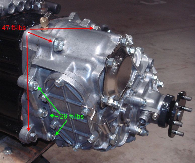

17mm hex = 47 ft-lbs
14mm hex = 29 ft-lbs
The transfer case uses a few different bolts to clamp the two halves together. The two top bolts are 17mm (hex) and torque to 47 ft-lbs (since they thread into cast iron). They should be torqued first. See attached.
The remaining 14mm hex (10X1.25) are torqued to 29 ft-lbs since they thread into aluminum. There is a longer 17mm (hex) bolt (or two ) at the bottom that threads into the cast iron transfer adapter..so it gets torqued to 47 ft-lbs too.

The transfer case does uses two different bolts. The top bolts are 17mm (hex) and torque to 47 ft-lb. They should be torqued first. See attached.
The remaining 14mm (hex) (91651-61040) are torqued to 29 ft-lbs.
