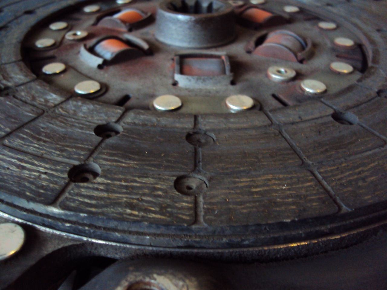

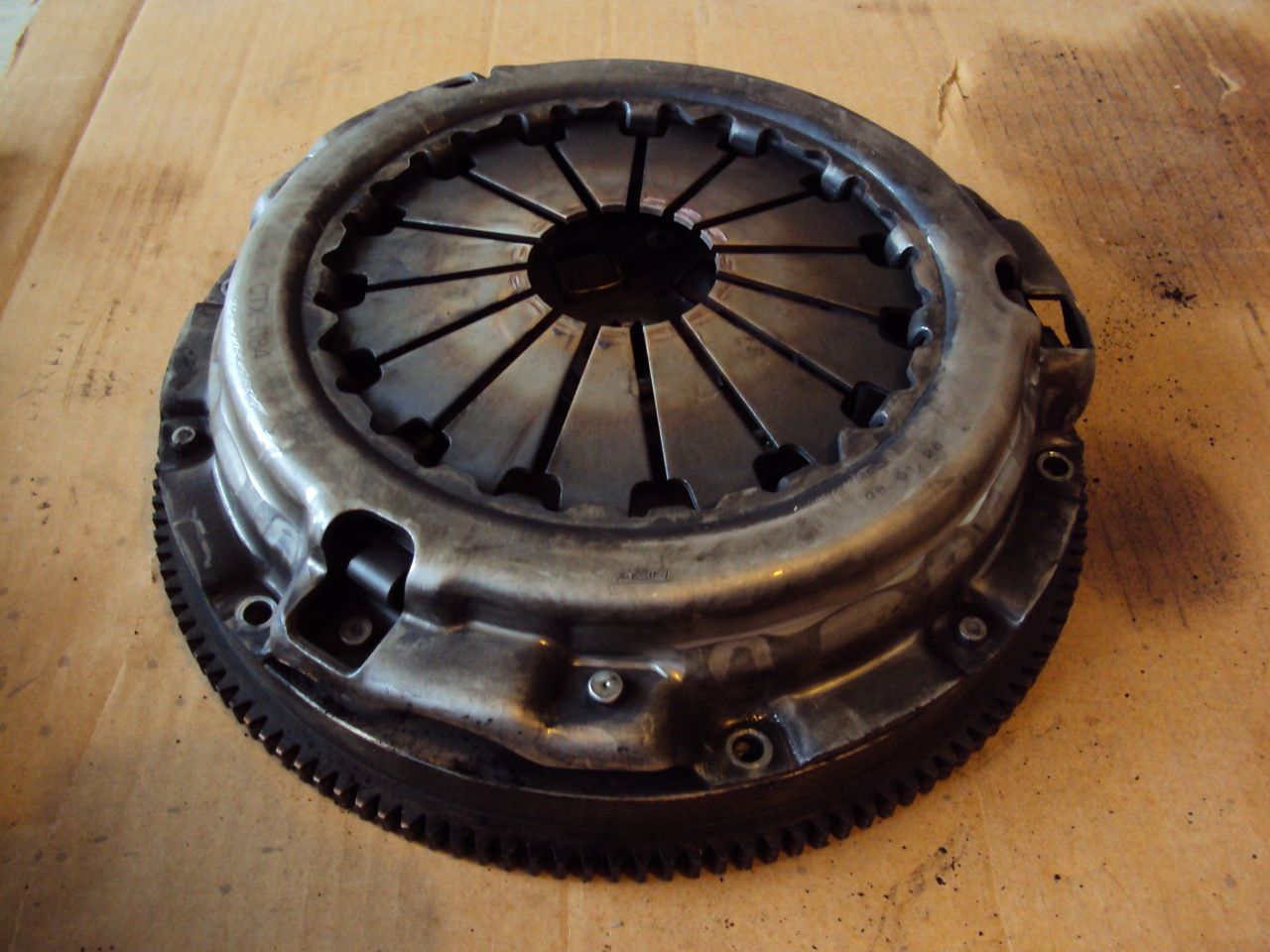

Got some more work done today. I am suspecting I need to just go ahead and replace the pressure plate, clutch disk, clutch slave cylinder, and clutch master cylinder. Looks like I was riding the pressure plate with the throw out bearing even with the slave rod at its shortest length. All of these issues I had were just caused by this I guess. It never made sense though. I would adjust and adjust the rod and pedal, it would never fall within spec. Not sure when this issue started, but I'm done with that crap.

Clutch disk. Pressure plate side.
Close up
Pressure plate
Shots of the wear on the pressure plate

You could probably get another 75K out of that clutch and a new one will go for 100K.
Well that's good to hear, what about the pressure plate, and flywheel? The wear from the throw out bearing is kind of worrying to me, and I'm not sure about the flywheel. @Pin_Head

Also I would appreciate some opinions on the clutch/ pressure plate/ flywheel. Good to re-use? Or not?

Yeah my clutch disc could explode, but I'm seeking advice on the condition of the components, @Pin_Head already chimed in, just wanting to get a few more opinions. New parts are cool and all, but it sounds like these components are still in great shape. Wouldn't even be questioning it if this wasn't apart. And besides, I'm only planning on taking this 300 miles from the house :)
It is normal minor wear and isn't worth worrying about. I would reuse the whole thing as is. If it bothers you, for another $250 you could get a new clutch and resurface the flywheel.
