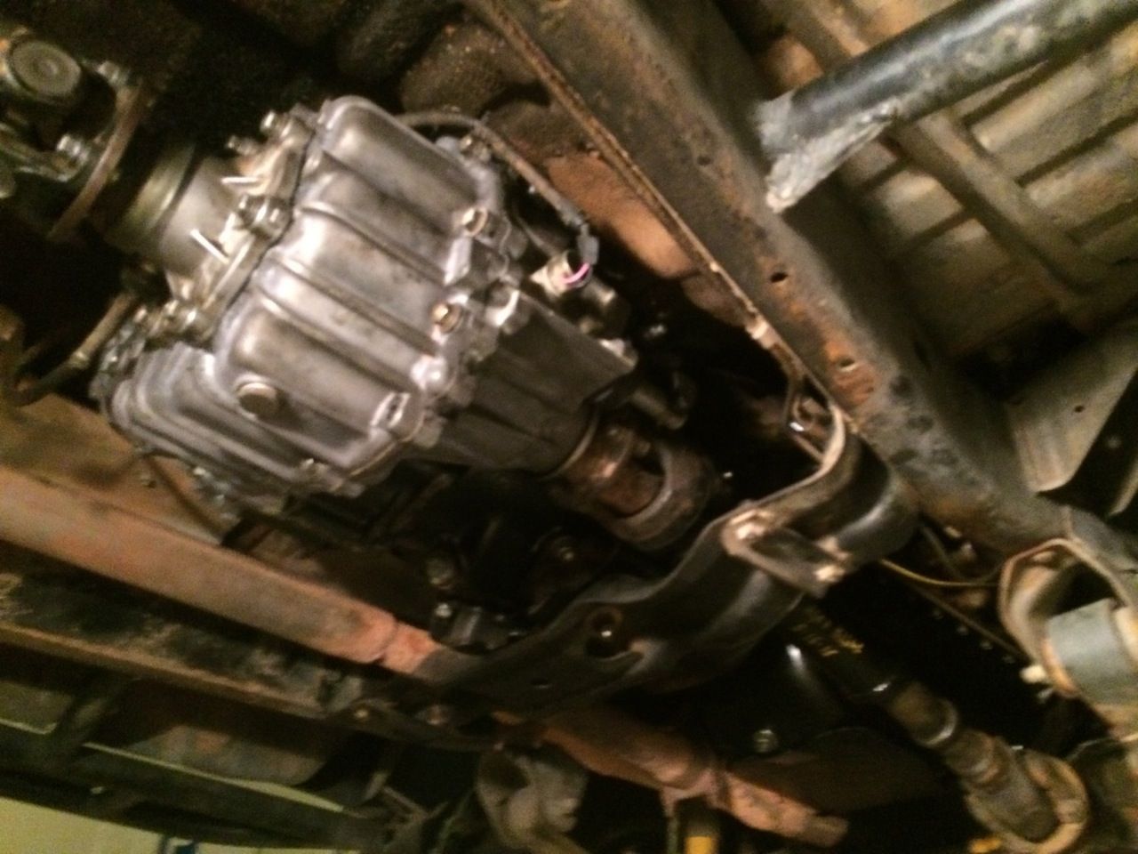

Had to pull off the transmission tunnel cover to gain enough clearance to install the 5 speed. I installed the t-case lever after stabbing the transmission. The clearance issue was due to the "taller" 5 speed
Reinstalled

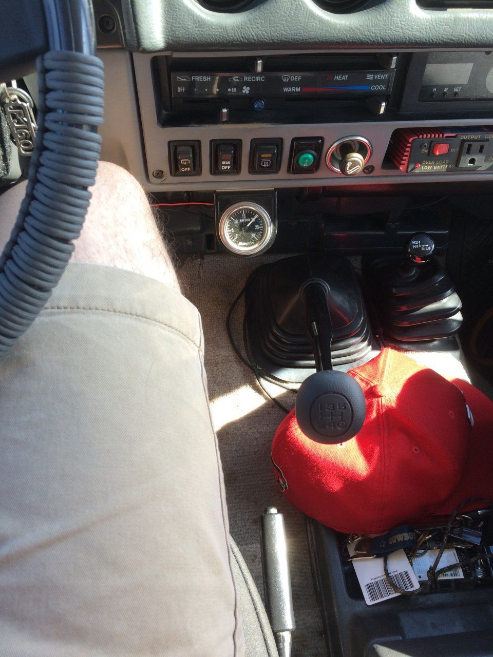

The annoying shift lever in 2nd gear

Fixed the shift lever. I'll get a comparison shot soon. It's MUCH better now.

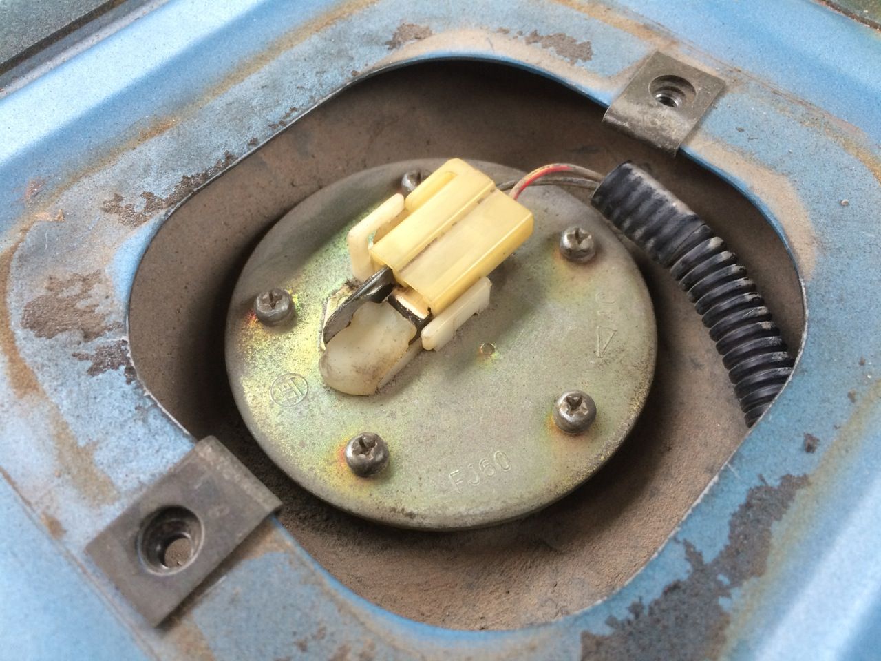

And while I was camping I got these annoying ants in my car. So I pulled the rear mat and decided to clean the fuel sending unit connector. It needed it! Initial observations is that it really helped the gauge reading.
Before
After

did you not move your transmission cross-member? I though it had to move back the 3" because of the transmission length? If not that means I can bolt in an H55f myself now ! :)
In the FJ60s the cross-member is located in the same location no matter what variety of H42 is being supported. The extra length of a later H42 or H55F is behind the transmission. Differences in FJ60 cross-members are related to whether the tranny is mounted level (earlier and non-spacer H42s) or clocked (later H42s with spacer).
If you've swapped in a 4 speed into your FJ62 you're ready to jump up to the H55F. If you've installed an earlier non-spacer H42 you'll have to swap out drive shafts when going to the H55F.
That's what I thought, after looking at my H41 realized the mount is at the front.
Yeah. The cross member doesn't matter. It still bolts up all the same.
That's why I loved doing this swap. I hope it makes everything easier for people down the line. You can't rule out an early truck for a 5 speed swap :)

Well I haven't gotten a chance to check the gas mileage yet. I did get a new shot of the shifter though before putting it back in the garage on Sunday.
2nd gear. Compare this to the before above.
