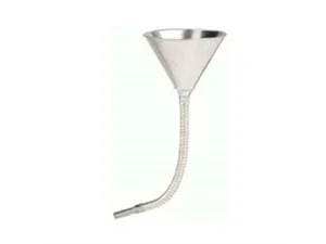

I was planning on doing the rear diff, but I spent like 30 mins doing the front. Didn't have a proper funnel or filling method. What do you guys use?

I don't use a funnel I get the little 1 quart squeeze bottle gear oil things from napa and you can squeeze/pour int othe fill plug. its messy but it works well. the other method I have used with luck is a transmission funnel with a long tube. since min is on a lift and my rear tire is not in the back I can pour everything relatively upright.
The quart bottles do work well. I didn't have one. Needed like two gallons of gear oil. Diffs are 2.6 quarts and the transmission is 3.3 quarts.
The funnel is probably the best idea. I prefer buying the larger bottles.

No worries K, I used the squeeze bottle method for years :D.. just got tired of ketchup bottle frustration... Ha.

Kline get this ^^^ you'll thank me later. Ive used mine so much Its probably one of my favorite tools. Buy a longer piece of clear tubing.... then just sit along sit vehicle (not under - uggh) and pump till she starts drippin'. Cheers Dan
I definitely will. That looks awesome.
