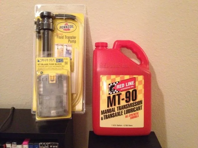

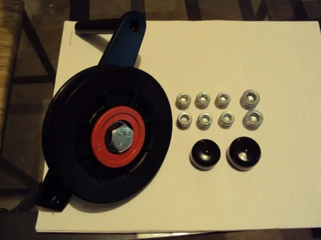

Ordered some stuff recently.
- Blue Sea Fuse Block PN5025
- Fluid transfer pump (That thing is awesome. Thanks dbleon!)
- Redline MT-90
- JimC idler and plug kit

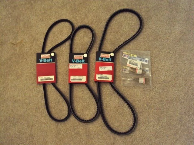

- Belts for the 2F (Thanks beno!)
- Fan clutch oil (Thanks beno!)
All of this is to prep for rebuilding and re-installing my factory carburetor, and some maintenance. Hopefully have this done soon (for sure the belts and pulley).
I put the Redline MT-90 in my transmission. It definitely helped a lot, but I'm afraid the transmission is screwed up. Shifts are still notchy. I need someone to properly diagnose what may be wrong with it. I know of a shop in Houston that a mechanic recommended "Armando's Transmissions" IIRC. Garrett I may just take yours if it feels better than mine. I'm tired these transmission problems.

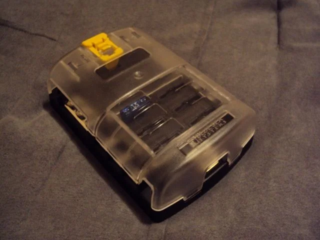

Fuse block is to un-crowd my battery, idler because I don't like the SOR milled one that I have on there now, plug kit for factory air intake and get rid of my home-fab plugs, M14x1.5 oil drain plugs with the heads lopped off :hillbilly: I needed the vinyl plugs so I figured why not get them all, it was cheap. Plus I just have broken BVSVs in the thermostat housing.

I need to get wire and a breaker/fuse for the fuse block. Would y'all recommend a breaker or a big fuse? Links to good ones? I have a hardware shop that can get wire and ends. And as far as wiring it. Positive to positive, but I really would prefer to ground the fuse block to the frame or something (not the battery). Is that okay to do?
I grounded my fuse block and then ground each circuit as well.. I used a breaker on mine. Got if off Amazon. works as it should, 100 or 150 amp IIRC..
I went with the breaker so I could trip it if I don't run Marley for awhile or leave her unattended for sometime.. I have 4 always HOT outlets on that block...
J
Fuses:
Look at total load (AMPERES) that will actually be run in your particular setup..... (not the max than CAN be run with the fuse panel). That way you can engineer your fuse/breaker according to the actual loads handled by the panel.
You might way overshoot on fuses by picking one that is suited to the max possible panel load.
Hope that makes sense.... Im sure you already know this, but just throwing it out.
That fuse panel lookls N I C E !!
Hope that makes sense.... Im sure you already know this, but just throwing it out. That fuse panel lookls N I C E !!
Thanks for the words. I actually don't know that much about electrical stuff. It's scary. Draining oil can't kill you but electricity can haha
And this thing is really high quality. Can't wait to get it in. J had a spare breaker, so were squared away. Just need time to install it. I'm not gonna be running that much on it. So it should be okay with 100 Amp breaker. I'll research my stuff though cause I do have a small power inverter in the dash.
You want to undercut your total draw (ie. with all your high draw electrics all running at the same time, at full power/amperage).
Do a little research on this Kline.. before you commit to that extra breaker someone had laying around. Not saying it wont work, but might be improper sized for YOUR setup.
Someone smarter than me will chime in.. im sure.
Cheers, night.
All I have running off the battery right now is my HID headlights (35W), my power inverter (I think it says 350W peak on it), and my subwoofer amp power wire (which I probably won't run through the fuse block, it is fused already)
What do you mean when you say "undercut your total draw?" Say I draw 80 amps, a 100 amp breaker would be okay?
i = w / v
350 / 12 = 29.167 amp
35 / 12 = 2.917 amp
So thats a total of 32.534 amps

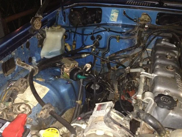

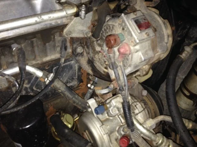

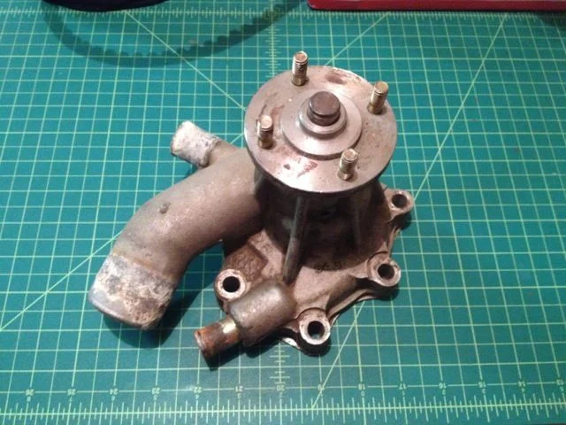

In other news my Landcruiser decided to blow a coolant hose. Right off the water pump. Largest one.
Photos show where it blew, and the spray all over the engine bay. It actually shut off the engine. Ignition coil got wet (is that normal?)
Photo of a spare WP I have so we can visualize this together.
Why the heck would that blow? Freak accident?
Looks like I will be installing those BVSV plugs sooner than I thought I would :wrench:
I was wrong. It's the smaller hose. I was stressed last night. Looking at the picture now it's totally obvious haha
Now I get to figure out how in the heck to get it off
