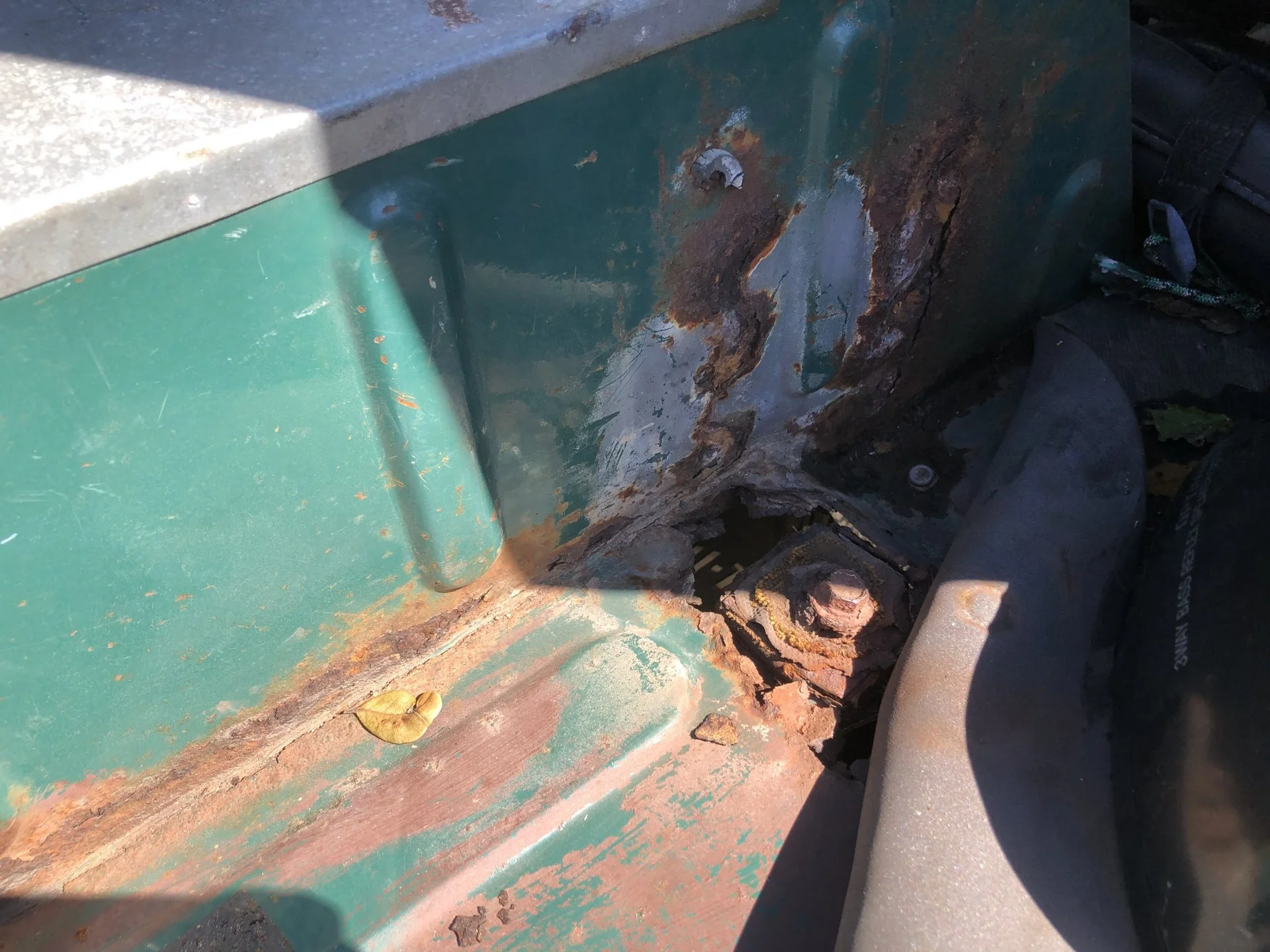

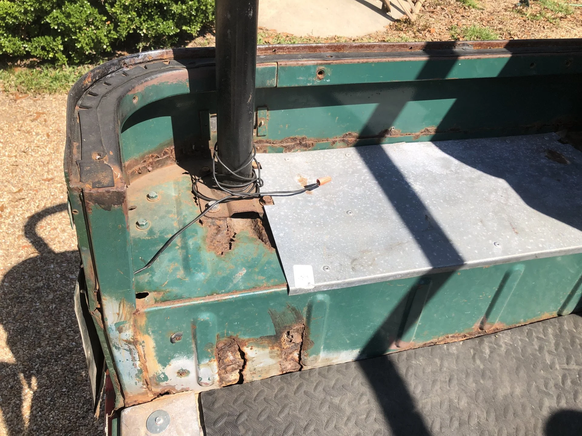

Hey all,
I have never owned a classic or vintage vehicle, but just bought a 1975 FJ40. I live in rural Mississippi. The good news is the front half has minimal rust, it turns over easily, it runs strong, and the previous owner(s) got the frame mostly rust free and redid the entire rear end (suspension and axel etc). The down side is the rust on the body, particularly the back half. Both wheel wells need to be entirely replaced, in my uneducated opinion. I'm assuming there is a good bit of rust on the rear quarter panels underneath those diamond plated panels. Same probably goes for the rocker panel area that also has black diamond plating. Most of the rear bed looks pretty good, except where it is bolted down just behind the front seats, which is probably an important area! The mid-bed section right underneath the back end of the front seats where the floor steps up an inch or two is also really rusted. Finally, the support channels underneath are very rusty.
The floor pans under both the driver and passenger seats are in pretty good shape.
My goal is for this to be a decent Sunday driver. I don't want it to be a show car, but I don't want to neglect it or butcher it. And, like most people, I don't have unlimited funds, so I need to be practical.

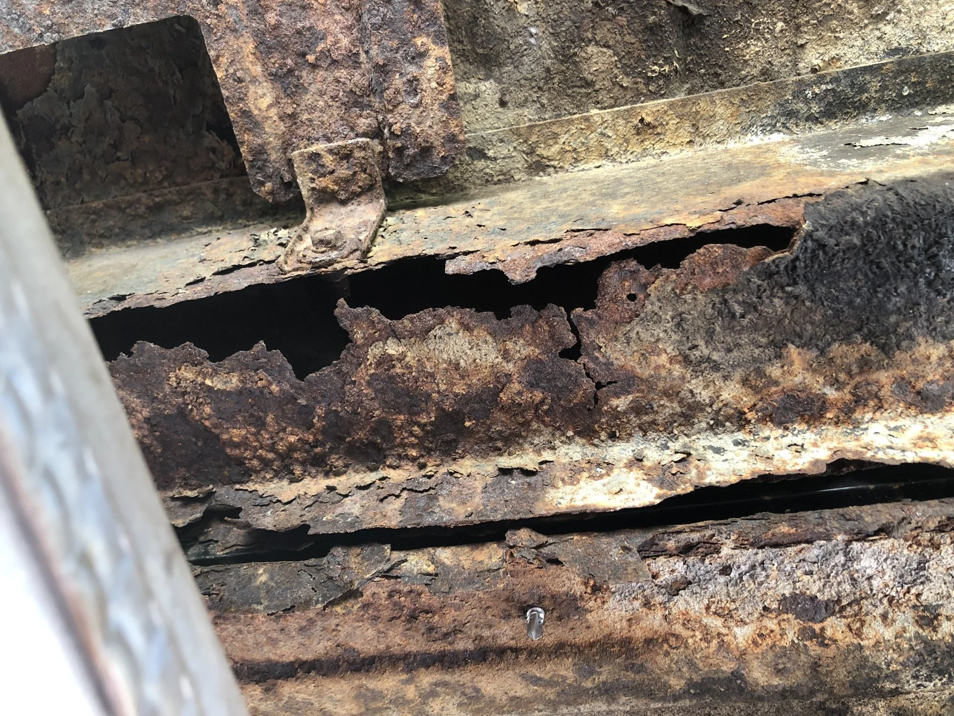

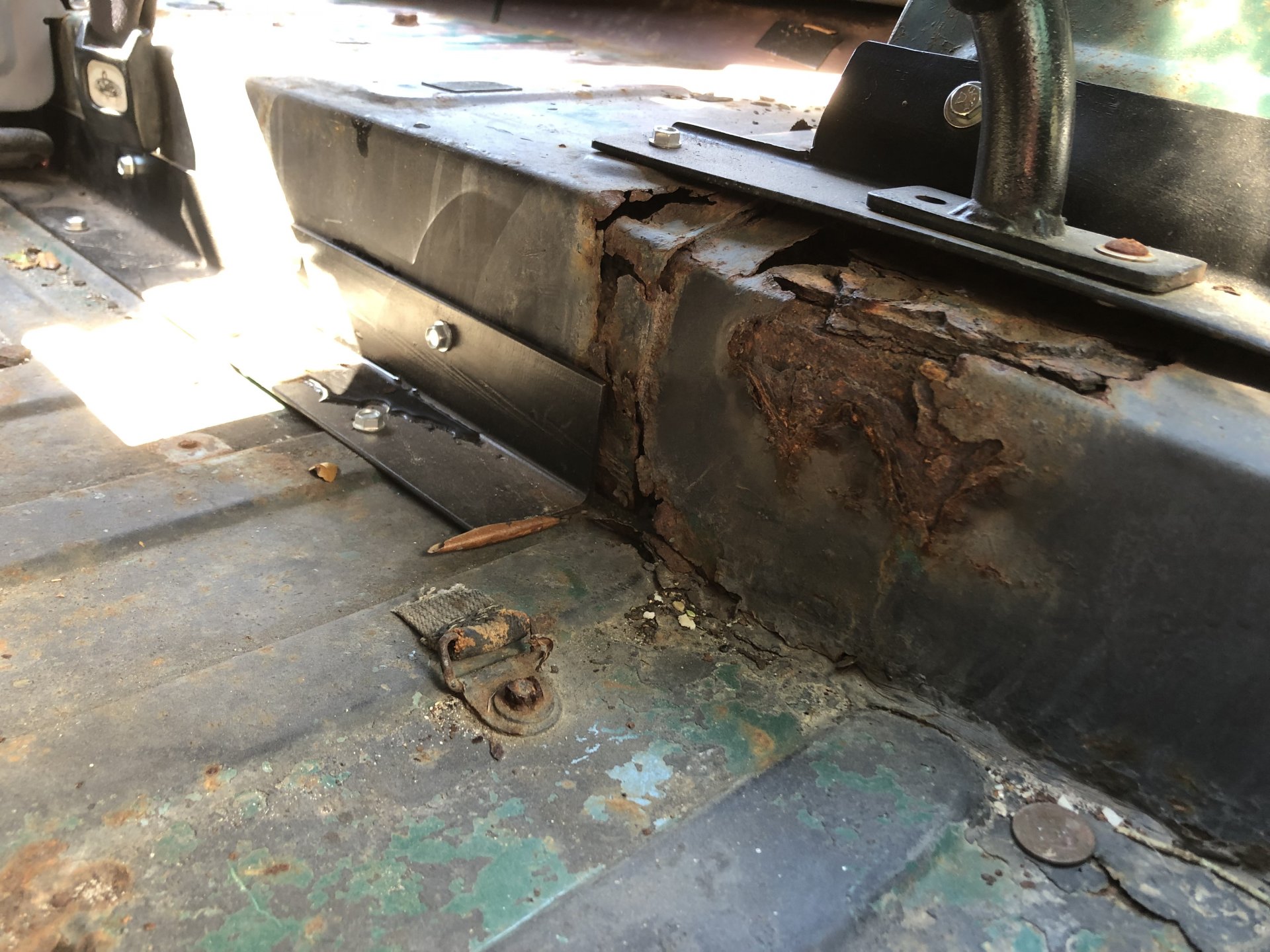

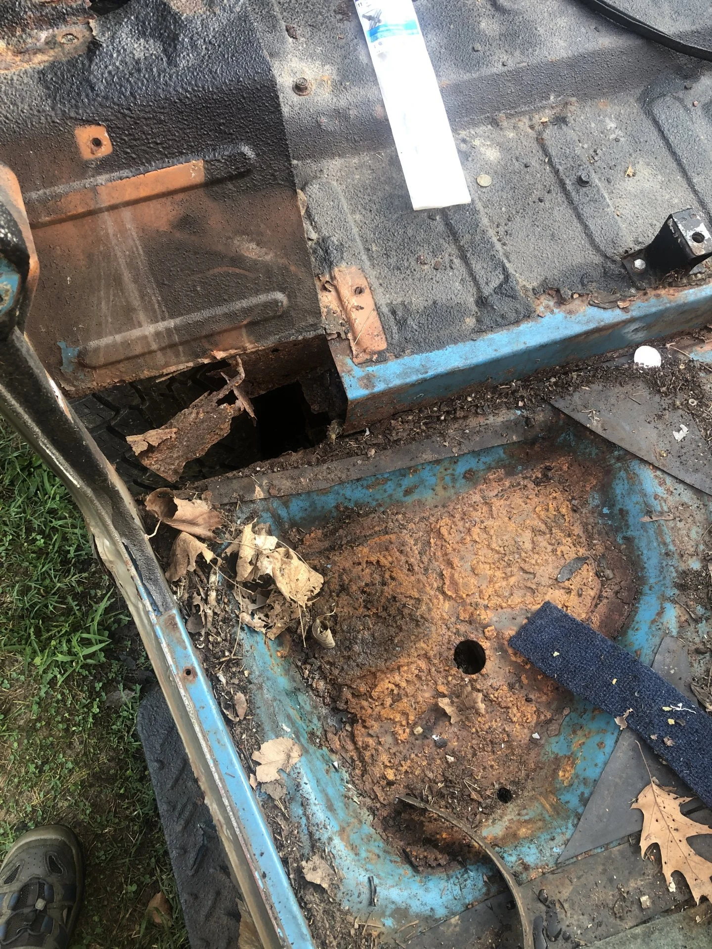

This is where you need to do some soul searching.
Usually with the amount of rust you've shown there is more you don't see. My suggestion is to find a reputable shop that can give you an honest second opinion. If the frame has any serious rust issues putting a new tub on it will solve nothing. You're going to have to decide how much work are you willing/capable of attempting and are you willing to spend what is needed if you are unable to complete the task.

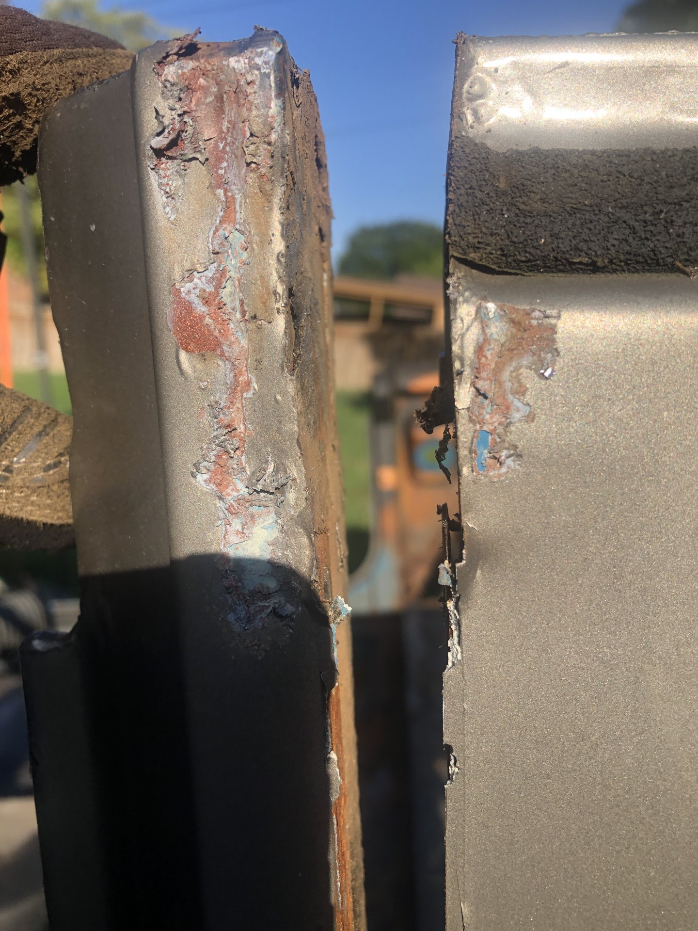

Okay. I brought my FJ to a body shop yesterday. They confirmed that the frame is in great shape. The back half of the frame appears to be rust free and painted. The front half of the frame has some very minor surface rust. What type of paint should I use on the frame after I remove the surface rust?
The bad news was he said it would cost a couple thousand to repair the front fenders (cut out rust and weld in new material). Therefore, I am thinking of replacing them. Should I replace the front fenders with one’s from CCOT to keep the front half steel, or Aqualu? CCOT is less than half the price for front fenders.
