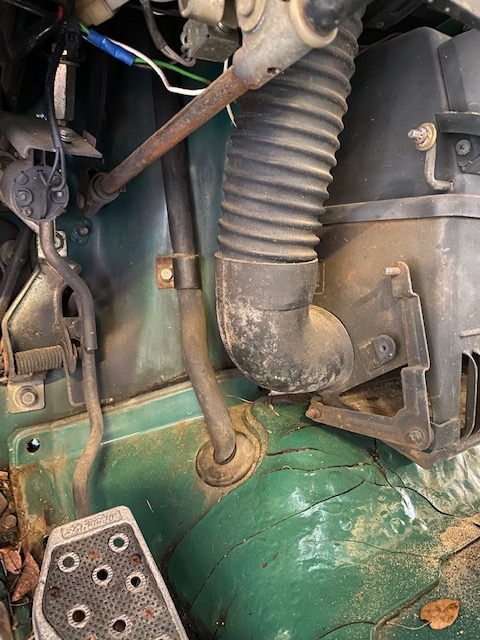

2) I am getting ready to remove the trans. tunnel and cannot determine what this small hose is that runs up from under the trans. tunnel, through a hole in the trans. tunnel, and runs up somewhere under the dash. (See picture) What is this hose for? Do I need to save it, or can I easily replace it?

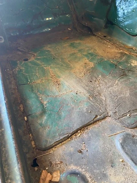

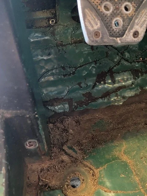

3) Aqualu's instructions for removing the existing tub say to "grind the spot welds along the front seam. There is a factory seam along the floor underneath the driver's and passenger's feet." I can see this seam on the passenger's side. However, I cannot find the seam on the driver's side floor as there appears to be an additional layer of metal welded to the driver's side floor. (see pictures) Has anyone ever come across this before? Is this factory work on a 1975, or is this a patch job? How do I know where to make my cut with the cutting wheel when the seam is covered by this additional metal?
