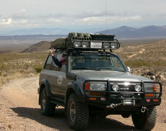

OK, I had a full length roof rack design all planned out for the the past few weeks (long before I actually got my rig)
Here's a professional paint rendering :D
From the top:
Now, I got started on the base and mounted it up over the weekend for a test spin and it's solid enough to jump up and down on, but damn the wind noise is a killer :doh:
It's weird cause I never had an issue with wind noise on the full rack I had on my Previa :confused:
Thing is, this time around I used square tubing for crossbars and with the Previa's rack it was all notched round tube, so I'm wondering if the square tubing would really make such a big difference in noise :confused:

Couple of ideas....
Your previa has a mesh design and the basket is full. Wind isn't allowed to go up/down through the floor.
Your 80 Rack has open floor. The wind is going over & under the floor of your rack. Two things to make an open rack quieter:
- have a wind fairing. But that's not enough as the wind will be trapped between the rack and the roof top.
-have a solid rack floor. This usually cures the wind buffeting sound that you're hearing now.
Experiment with a sheet of plywood on the floor of your rack and you'll see the difference.
For one of my previous home built rack, I used a frosted color Lexan as the floor of the rack. It was 1/4" thick and handled the U.V and normal abuse quite well. The frosted (like a shower door) allowed some sun light to come through.
Your roof lights will also add to the noise factor. While they look cool, you may notice increased wind noise and loss in MPG. I'd make a tilt down design so that the lights lay down when not needed. Just my opinion.
Cheers.
Well, the 3 rear crossbars are all touching the rubber rail thingies on the roof, so it won't go any lower.....
The front crossbar is higher cause of the front drop (and lack of rubber rail thingies)
Actually, I just made a ghettofied fairing by adding an old bugshield to the front crossbar using zipties and it seems to have reduced the wind noise quite a bit :)
I'll work on some more fixes and tack weld a few joints before completing the rest of the rack....

i don't think you can do much about it other than live with the noise. My 3/4 ARB rack is loud. Super loud if you open the sunroof. So i just take it off for the most part. I'll put it back up if i'm taking a long camping trip and need the storage space.
Did you use a conduit bender to bend the conduit and what dia is it?
Thanks
Nope, just regular 90* elbows (my pipe bender sucks for tight bends)
It's all 1" conduit that was leftover in my shop...
I just bought a few threaded joints, threaded them in tight (a few ends had to be heat expanded to fit), laid them flat on the chassis rack and just welded them together :cool:
I have an idea I'm gunna try out once it's up there :idea:
