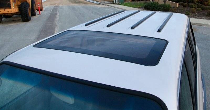

I’m going to be checking out this 80 soon if I can and from the photos there’s no roof rack, which I like, but I still see the plastic sliders along the roof. So I have a question as to whether it came that way from the factory or maybe the rack was deleted and then the holes filled. From the pictures it looks like it may have been repainted at some point too since it looks to be such a good condition although pics can be deceiving.
Also any guide on removing the slider sliders on top? I like the look of the roof without them

The ribs come with the roof rack and are attached at the port.
Your truck had a rack, someone removed it, filled the holes, and repainted.
I THINK the ribs are glued on except for the bit at each end. I think there's a screw in each end but not positive. I'll bet they just painted around them so if you remove them, you'll have mismatched stripes on your roof.
My roof is the same. It never came with the rack, but does have the ribs. I have a 95, but it has cloth interior, manual seats, and the 94' style rear swaybar mounts.
The ribs are metal, sliding on a grooved plastic strip that is glued/double sided tape. It has amazing adhesive, especially with weathering. The end caps are screwed into rivnuts. Beware, these rivnuts tend to rust around them.
IF you choose to remove the ribs, you may have rust issues to contend with. Also, the double sided tape can take paint off if you're not careful.

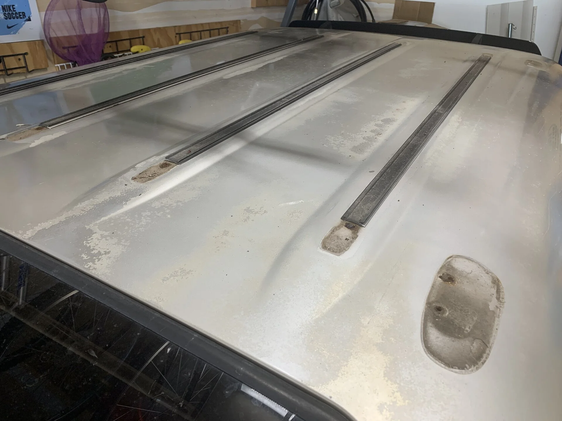

Working on removing mine now.
266ptv6P41F8eEm1eTHWhgI2Dgxo2q_v4ILszo8W1EfipWHYlSNaT92Pi5p1wccKwTz7pwewv73b1l-SNn02brfnuXF4ZFS8J68-dEEA7uRuol1i8ul7Aoim7EXRnzcy-PpHOR3bMNXKQ6WXdU3kedPvA0mWfbsSTpXSwXWSjvTw90Ahs0ekJ7PaPTA29FMvLxW63f_apRsp2ukmflNzXRXFIEBH23lQRa70aPjILE58aOGQOgBoKTaBlt-vCjXyCZTpvDFwm6vY02PS_RVscUpq05fNg_Ypb15A4fec8bKCycDvsQSbhs5s81q0nJT1Mu_xq6kdRJxSvQkIeLPufVchH1LAfhP446te3TzJwrB19njGGkvLUjVASWdqSeXjmcfWLiyaMYYQrwgfXiYbywXq7twVnqf6j2rxe9NUNEZlPv1_DkFVSyvdEpLCSynODc7KOG2PlnjwNXnVwDMPeDMSVtypVhb6R0BUh86K1o4TEWYSZUQ1XG8IawHFt3gGdXkT8hnIc6ixwOtaT4ei--FGKb1F-cKla9bLFVAOMK1CGpFw0DrXSJaKLFzPGjMkY_9a6FG8c_t_Jhwez7d8N1y9a3pNMubSTLzZ97hlP_8fEAT_5P7JW89HRib1duwofsAT3rc_u-hO41Yxuyl8W0gU8l2G3N5tr5TBEDLoTwjL3VYJV7ICaeSiCpk22H71lBiuHVdqBAdoSNg1_0kKqRg2aXEp4KmDqL78BlhTHr9YG5Gk9dCgol4KOexeb7SX_RgN-GPj-g3UyBn12dm1fH9U6_suSpGSZ3hpLOTm_Nd75cG8lzfTGOfYrYXUy1WD3MlrLDQhoV0vXwO0GlwYjFLYWMANphUNxFZJrlaB7eGAd9YyTVn8dsM4MRusGfNkvvXtc_qfmExGHue7JhhnOD1TUzpUR_K52jnresRVGTQdCg=w1252-h939-s-no
It would be cool to see where the holes are on the inside view
I not taking the head liner down and I used a drill bit stop when I drilled out the rivnuts as to not poke holes in my headliner. 😝
If you look closely you can see I dimple the holes and cut little notches in with a cold chisel then I filled them with fiberglass impregnated Bondo and sanded them flush.
This way you don't have to worry about Rust starting on the inside I used the same method when I remove my flares and have not had any issues or any of them fall out simple and effective.
