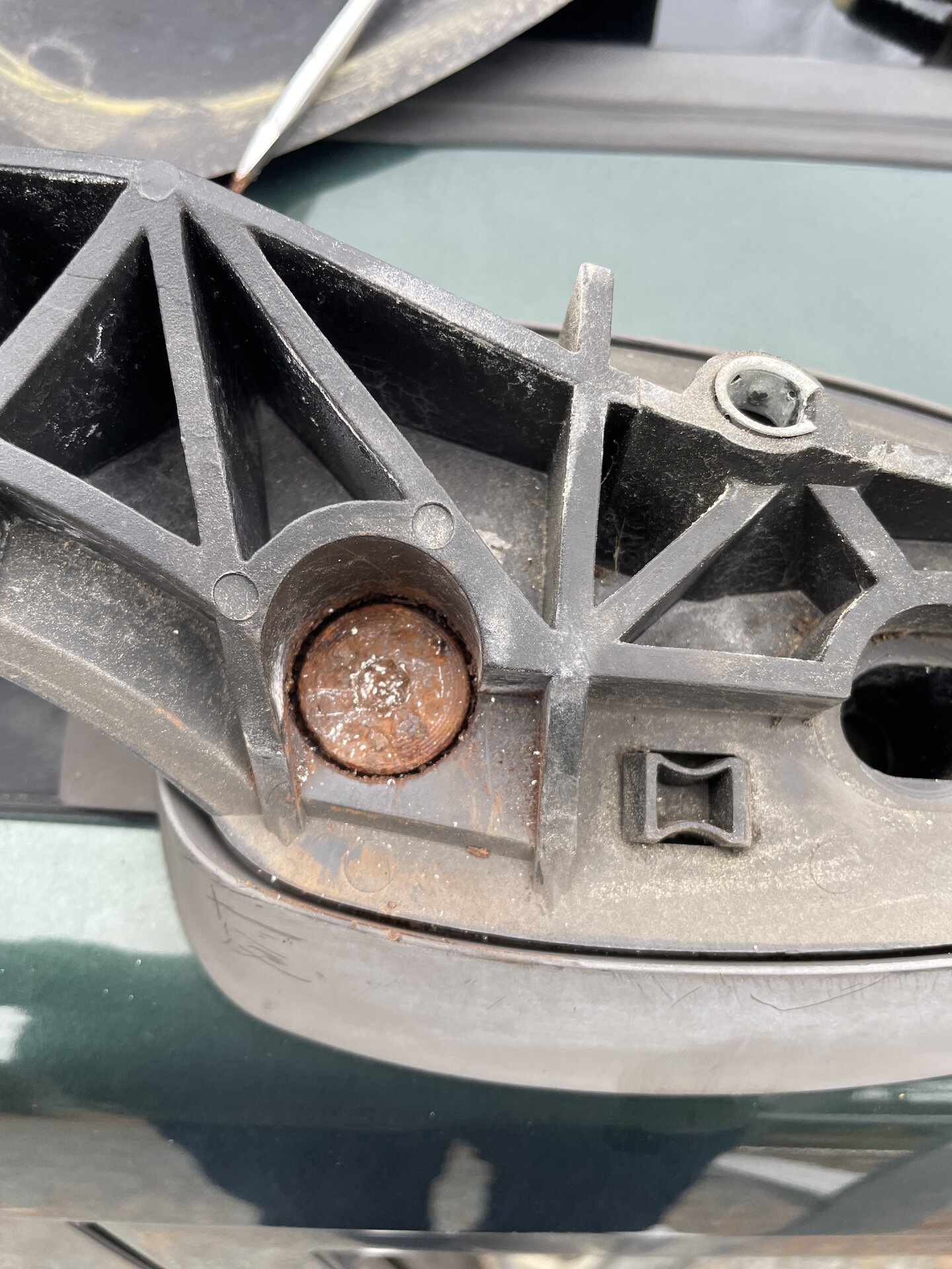

Tried to take my roof rack off my 2000 Cruiser to clean the channels and a bunch of the hardware is rusted.
Anyone know the part number for replacement bolts? Or can you recommend what you substituted from the local hardware store?

The hex head bolts are what's in place in the unused points, they should be able to be used where the torx bolts are since it appears those aren't available. The racks were post installed, so not something Toyota had in their parts systems it sounds like.

The pro on the stock bolts is that PTFE sleeve around: it’s a bit longer than the shoulder of the bolt and when bolting in it seals on the perimeter towards the towers. The caps and tower don’t seal if off properly and water in the tower can than possible leak into the column and (on the driver side) might flow all the way down over the fuse box into the footwell.
Found it out when I had the rack removed and cleaned/ rinsed the channel out 😂

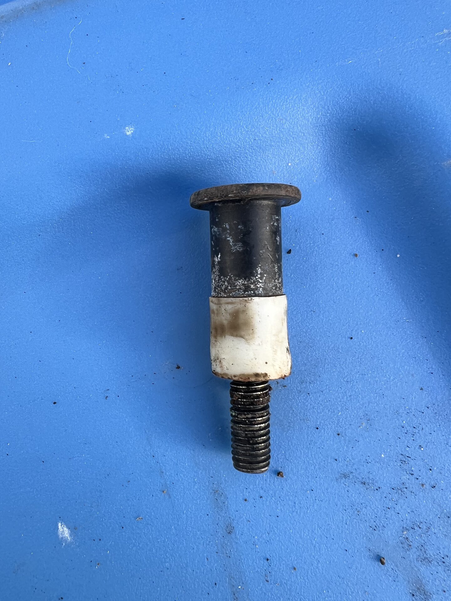

This is my „bolt“/ screw.

Edit: and these are all torx
just coming back from a Toyota only "junk yard/ builder/ I do everything". He had a 100 series rack laying around, pulled the plastic cap and gave me 3 perfectly fine non corroded bolts for $20 :-)
