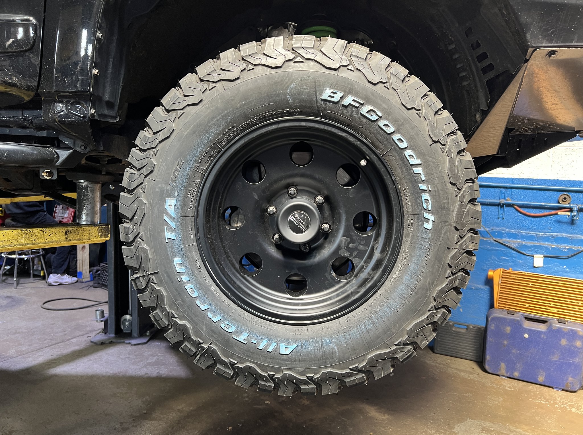

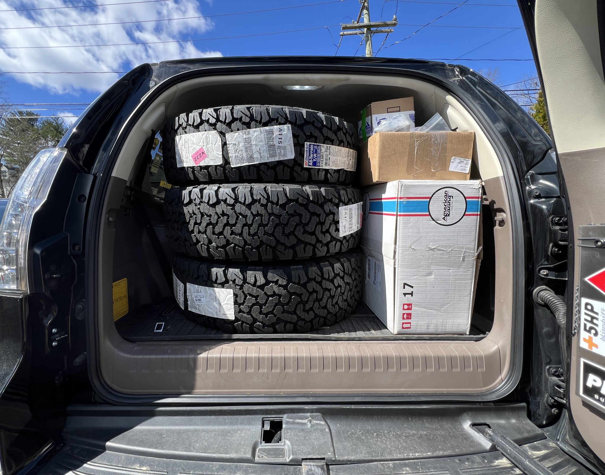

A few months back BFGoodrich sent me a set of 34x10.5R17 KO2s to test. I've been running Toyo Open Country A/T IIIs in 285/70/17 for the last 2 years, and the two tires are direct competitors. As I posted in the skinny tires thread, the E-rated Toyos weigh in at a reported 55# with the new D-load rating BFGs being 54# each. I'm also testing a set of American Racing AR172 Bajas courtesy of Real Truck. The 17x8" size makes more sense for the narrower Toyos than does the 17x8.5" Motegis that were mounted on the Toyos. The new Bajas weigh 25.31# to the Motegis at 24.54# each, so the overall wheel/tire setup went from 79.54 lbs/corner to 79.31 lbs/corner-- a negligible difference.
Yes, you can fit 5 tires and 5 boxed wheels in the GX460:

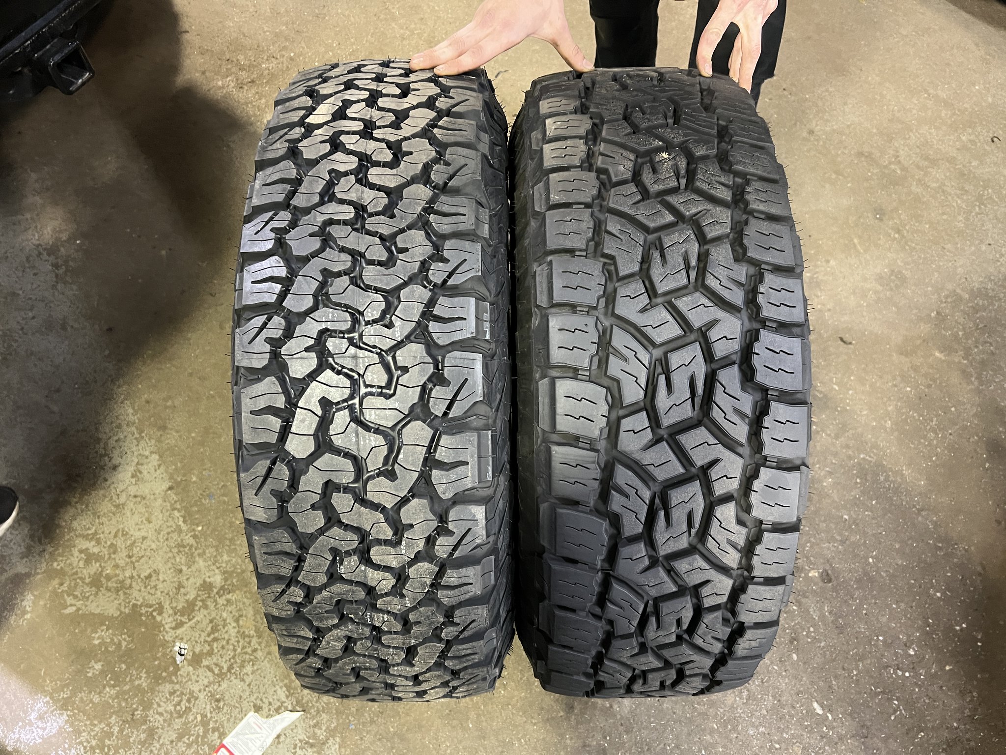

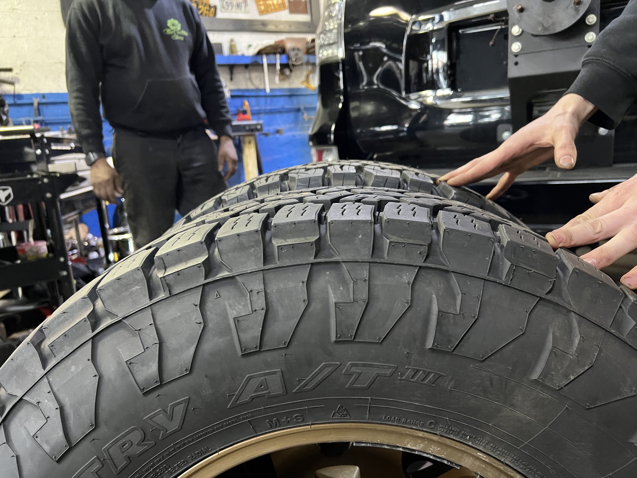

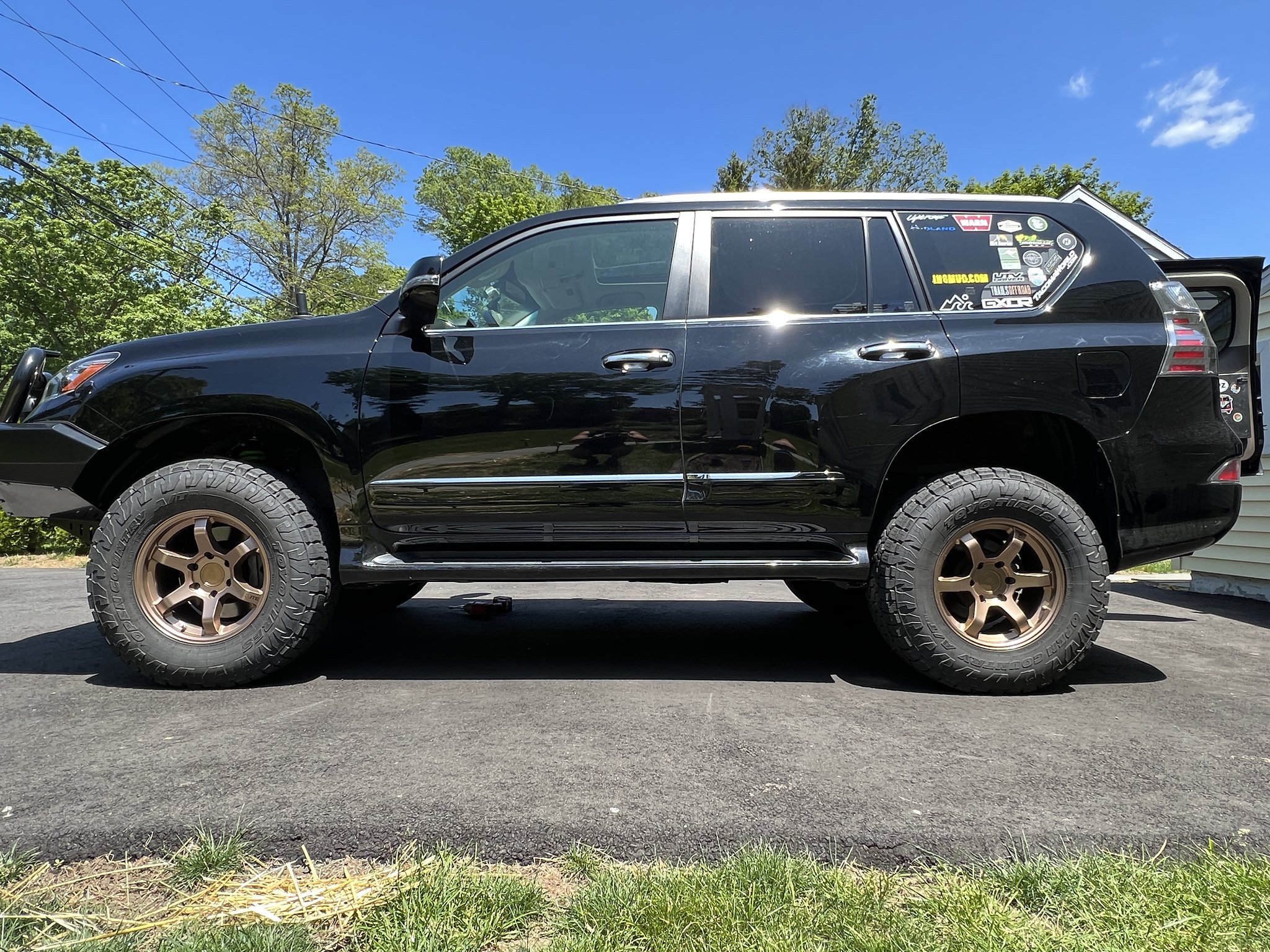

The goal in swapping out the Toyos for the BFGs was to get a little more height and a little less rolling resistance. Dimensions come into play here: he BFGs are quoted at 33.5" tall by 10.5" wide, and the Toyos are reportedly 32.8" tall x 11.5" wide. It's not a huge difference, but it's noticeable when the two are placed next to each other:
[IMG]
[IMG]
I've wanted to try the KO2s for a while now and am especially curious how this size fares in comparison to the common 285/70/17s. Initial impressions are strong after about 400 miles. Here are some thoughts:
  • Less rolling resistance with the narrower KO2s (and coasting is subsequently easier)
  • The GX is maybe 5% less excited to drop down a gear on long highway climbs, but more time and testing is needed to verify this
  • Equally quiet around town
  • KO2s are new and subsequently slightly quieter at highway speed, though they do have slightly more vibration at highway speed
  • Ride quality of the BFGs is better, thanks to slightly more sidewall and lighter load rating
  • BFGs have worse wheel lip protection; outside of the bead is more subject to rock rash
  • Off-road is hard to compare apples-to-apples, but the KO2s seem to be a little happier on dry rocks (again likely thanks to the greater ability for the tire to deflect/flex), water/mud performance is a wash, jury is out on wet/loose climbs, and KO2s are a bit better to run trails with as they are a little more direct but are also slightly more "floaty" (for lack of a better word)

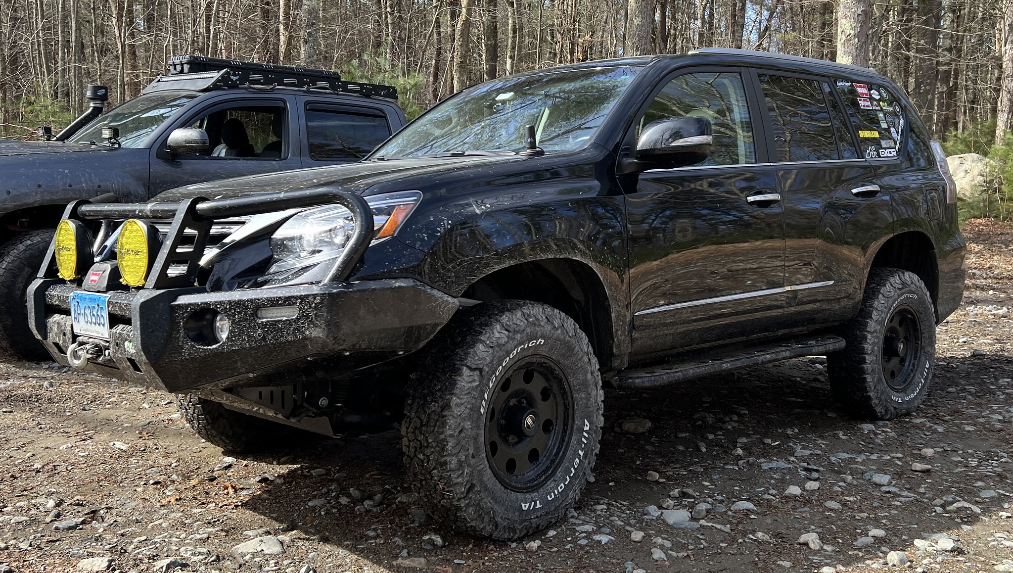

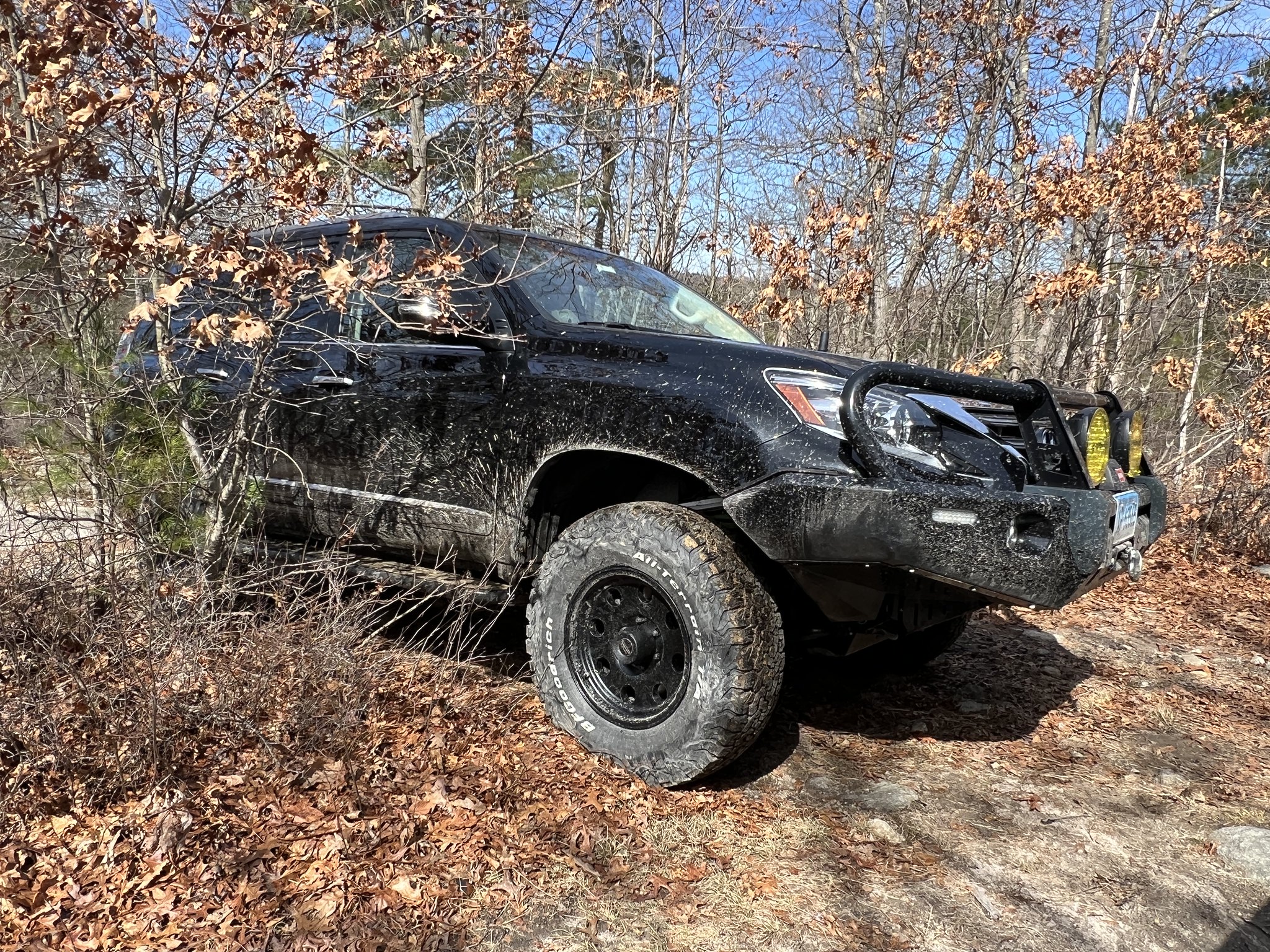

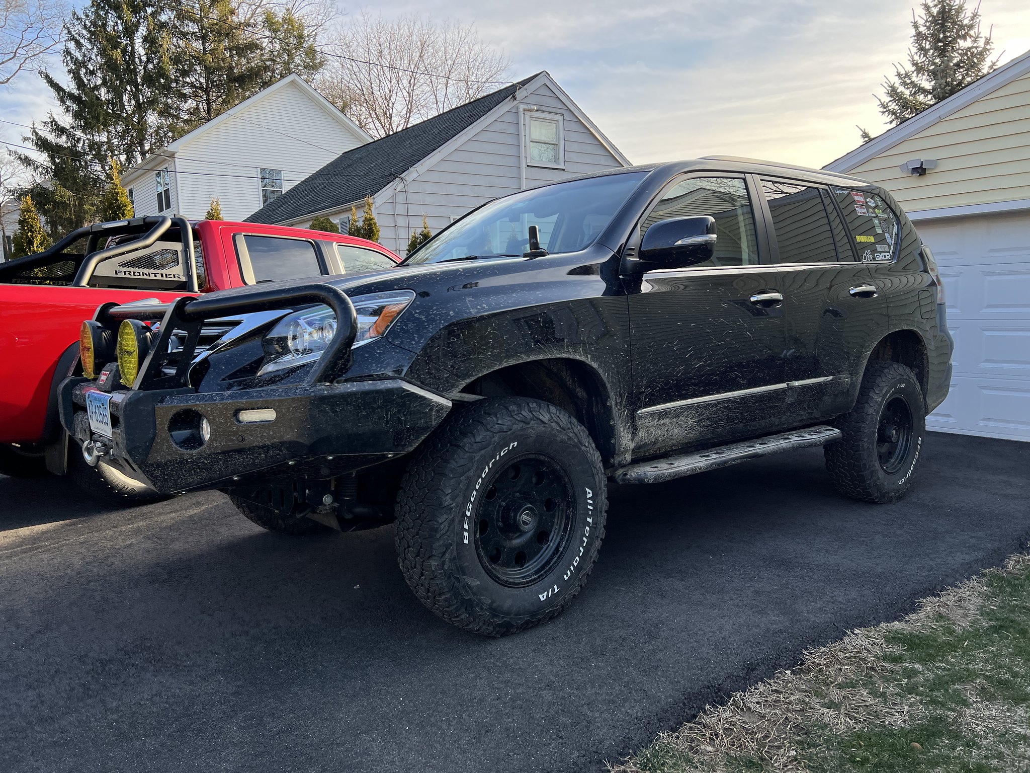

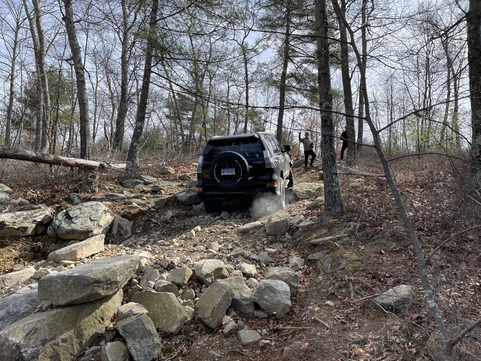

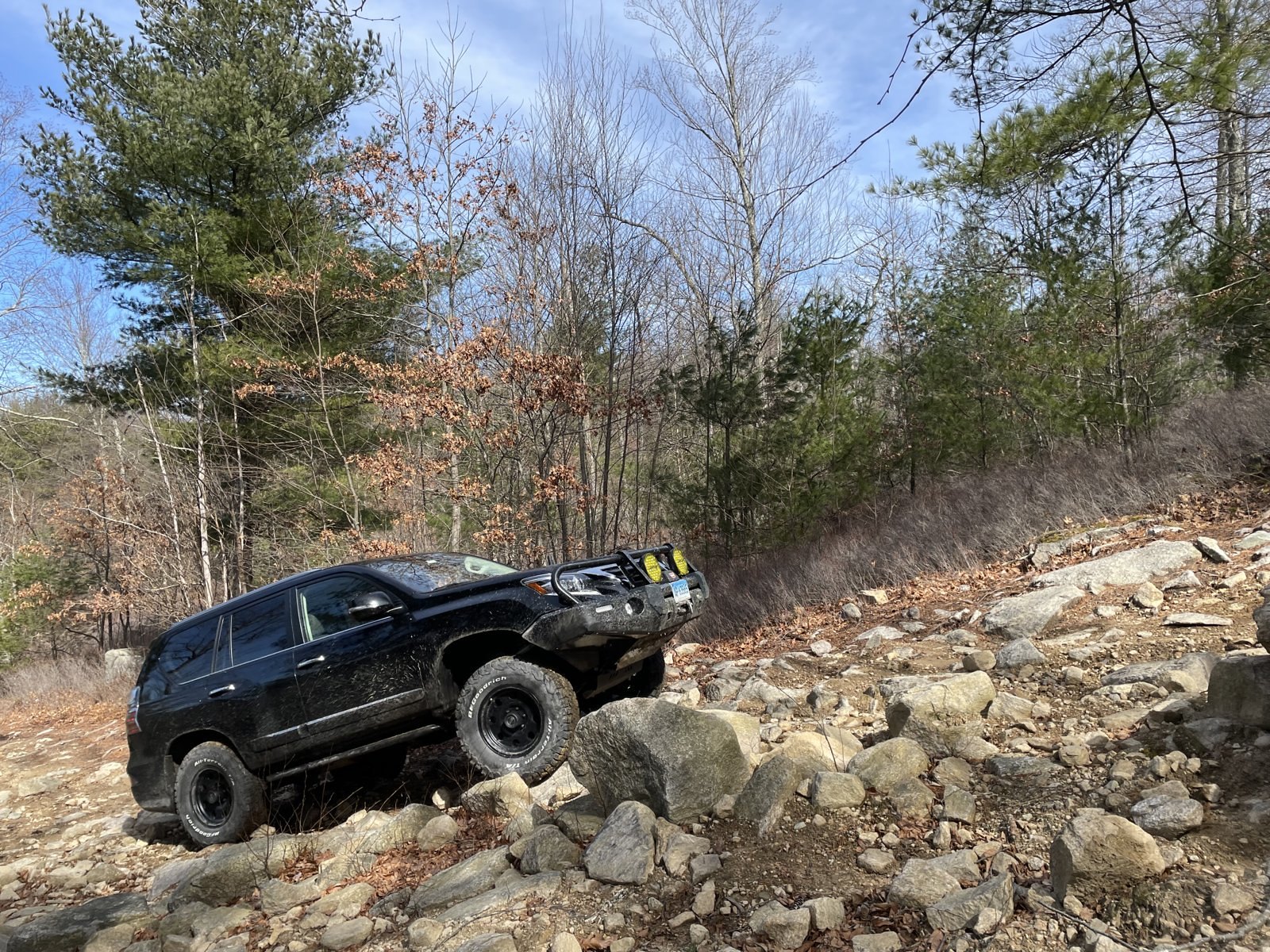

Speaking of off-road, part of those 400 miles were wheeling with some of the Northeast TW guys who are great to wheel with and great friends, too. The KO2s did very well on our little adventure. No grip issues whatsoever, and while it wasn't a particularly taxing or difficult day of wheeling, I am still pleased with the performance thus far. Gratuitous pictures from this past Sunday, some courtesy of the guys I was with:

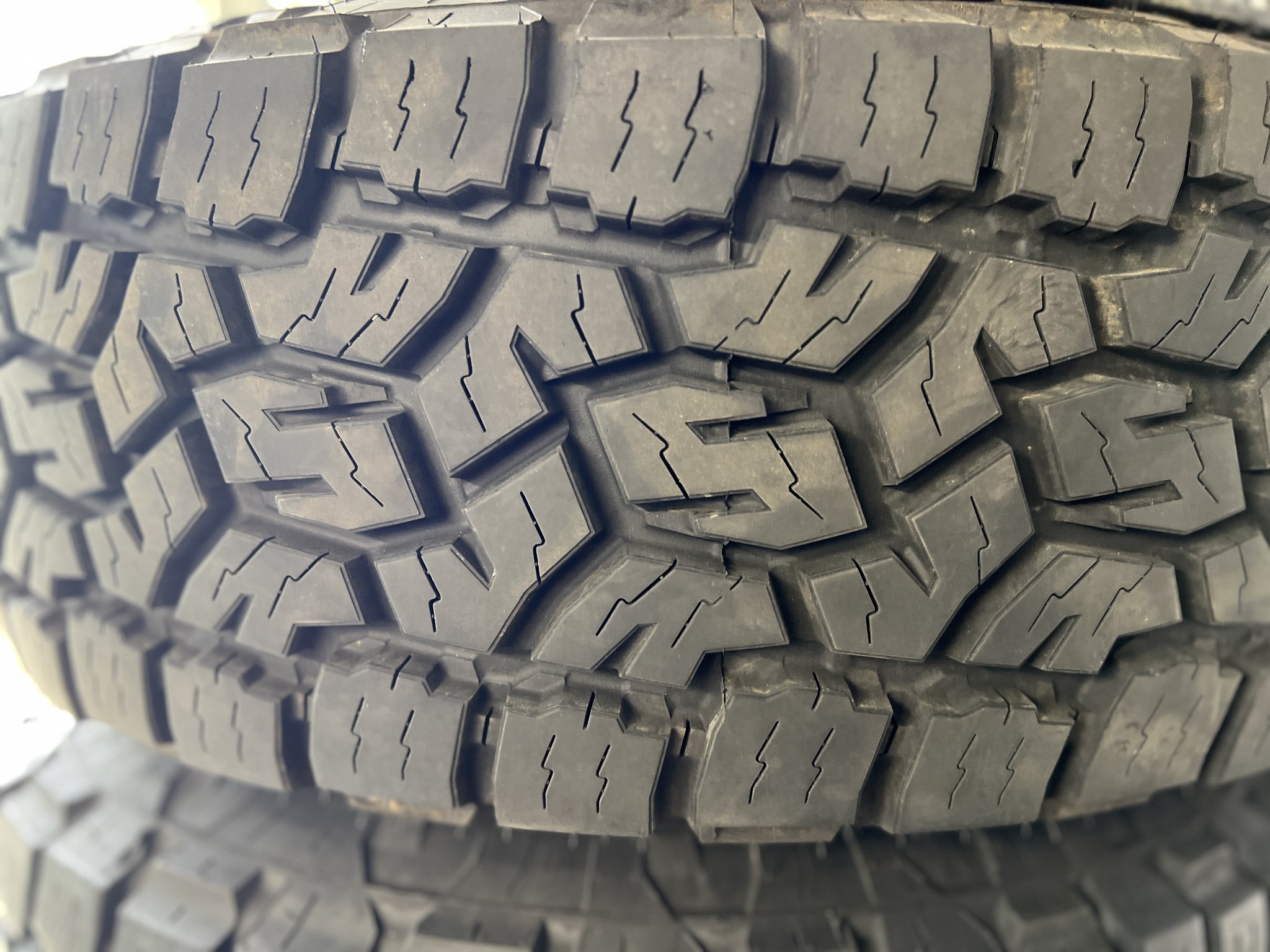

Quick closing report on the Toyo Open Country A/T IIIs after 2 years and ~8k miles: These are truly fantastic tires. Quiet, comfortable, confident in every single weather condition, and so on. Between my dad, my brother, and myself, we have put probably a half million miles on the A/T 2s, and the A/T IIIs are even better. They were fantastic on my GX, handled everything I threw at them, and held up incredibly. Given, I didn't put much mileage on them, but I drove them in every condition: Dry, rain, ice, sleet, snow, mud, rocks, sand, dirt, and so on. They never broke a sweat. Great, great tires, and I wouldn't hesitate to recommend them to anyone who is even considering them.

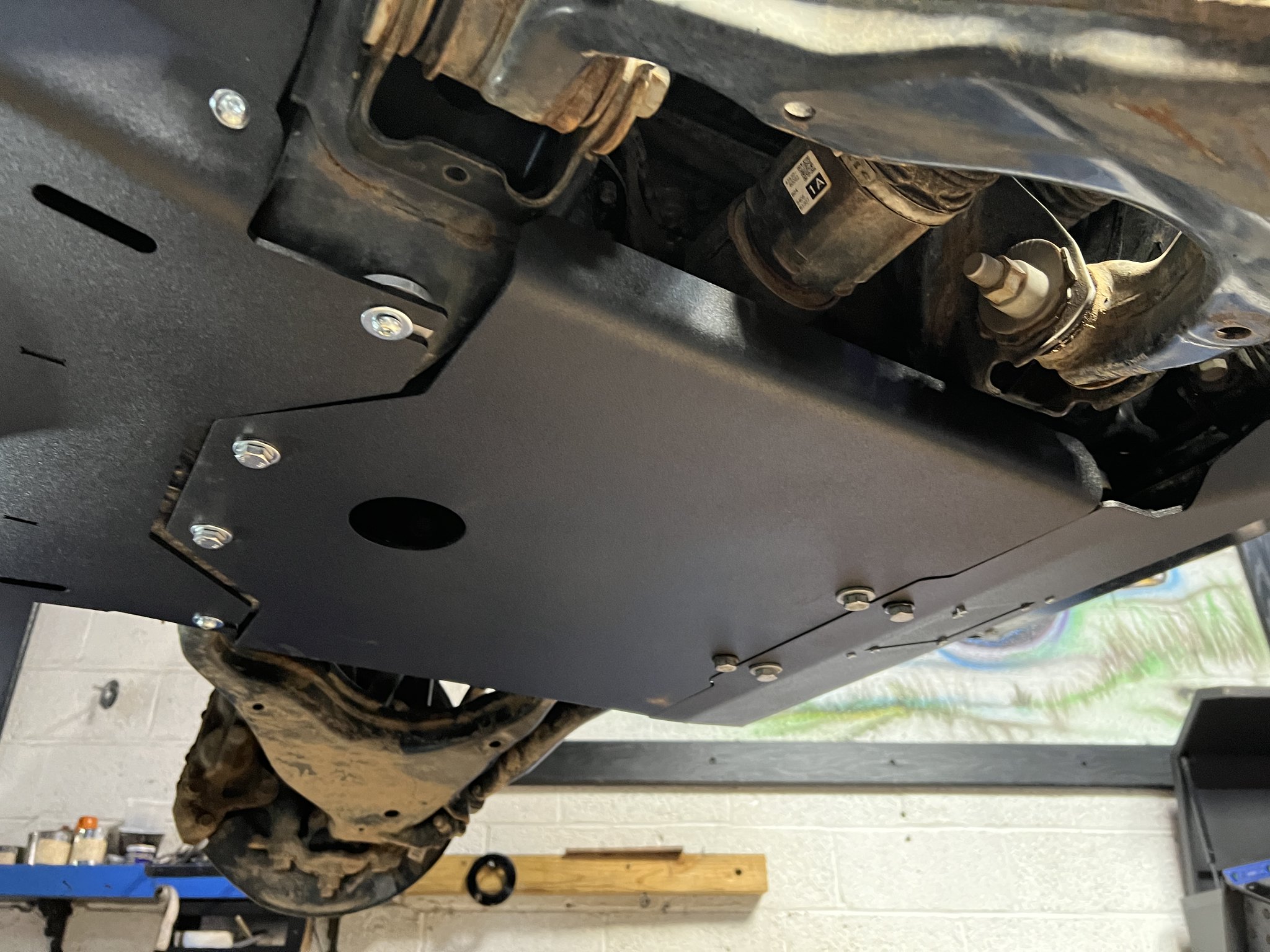

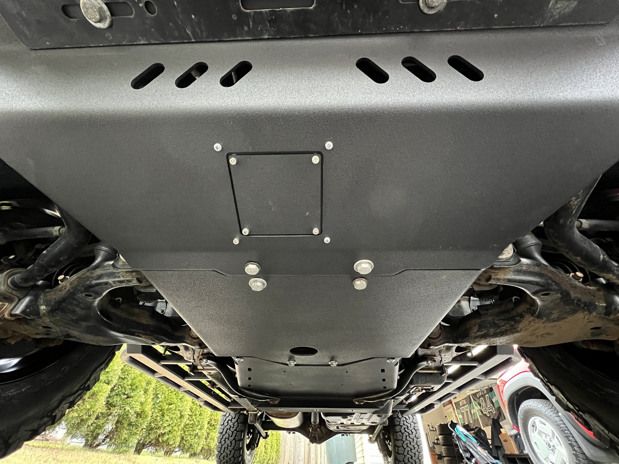

Also on the list of recent upgrades was a set of skid plates from Talons Garage. They usually make these out of aluminum for the GX460, but conversations with the team there led us to make steel skids as a prototype/development test set. There's three main pieces: Engine, transmission, and transfer case. Talons Garage isn't one of the big names in the off-road armor, but the caveat here is "yet," as the quality of the product shows what a passionate company they are about what they make. This is a super high quality set of skids and has already been a great asset to my GX460.
Installing them was perfect timing, too: The wheeling I did two days after they were went on the GX came with the territory of a bunch of smacks what would have been exposed components had the skid plates not been there.
Talons Garage skids installed:
[IMG]
[IMG]

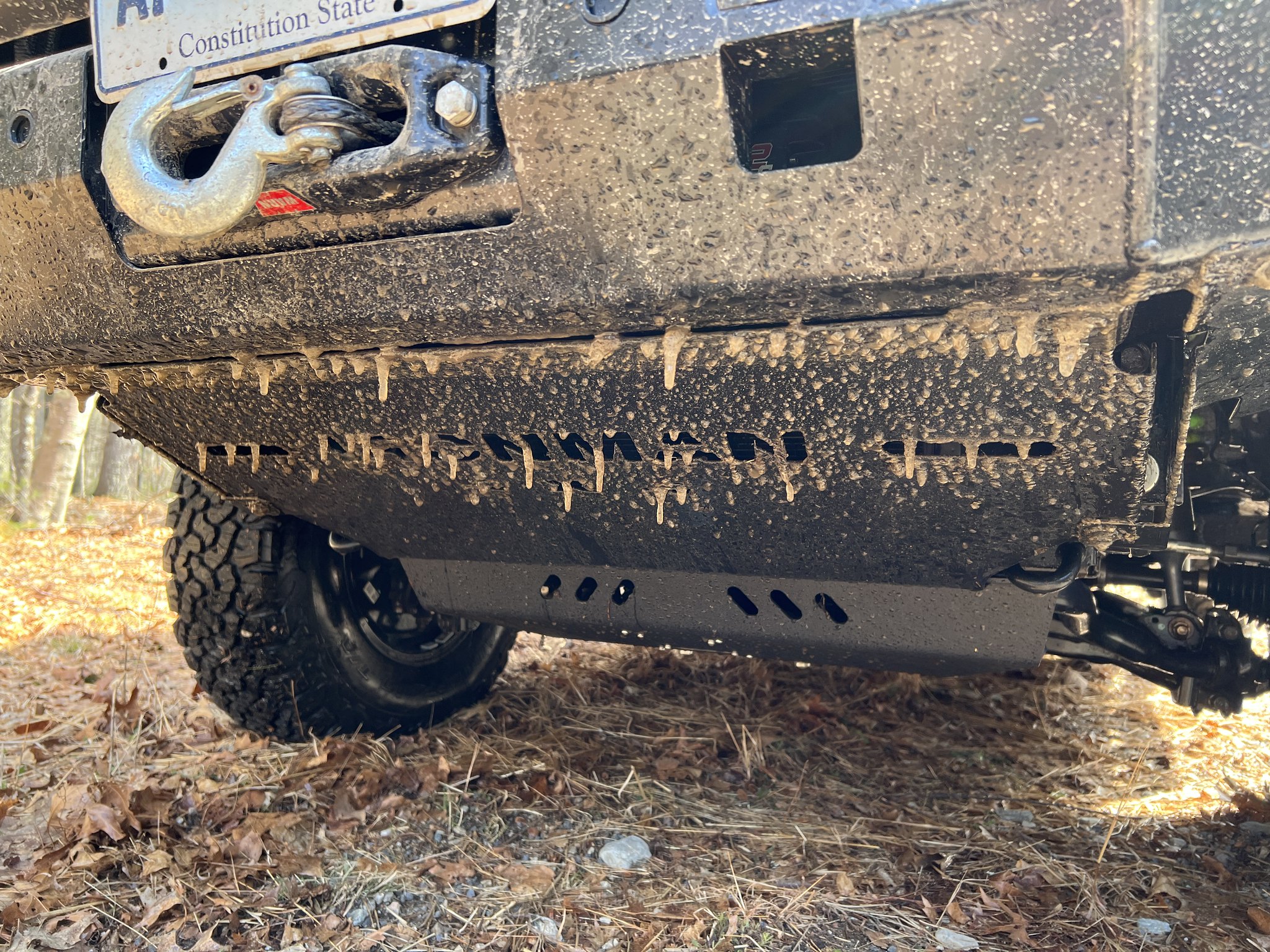

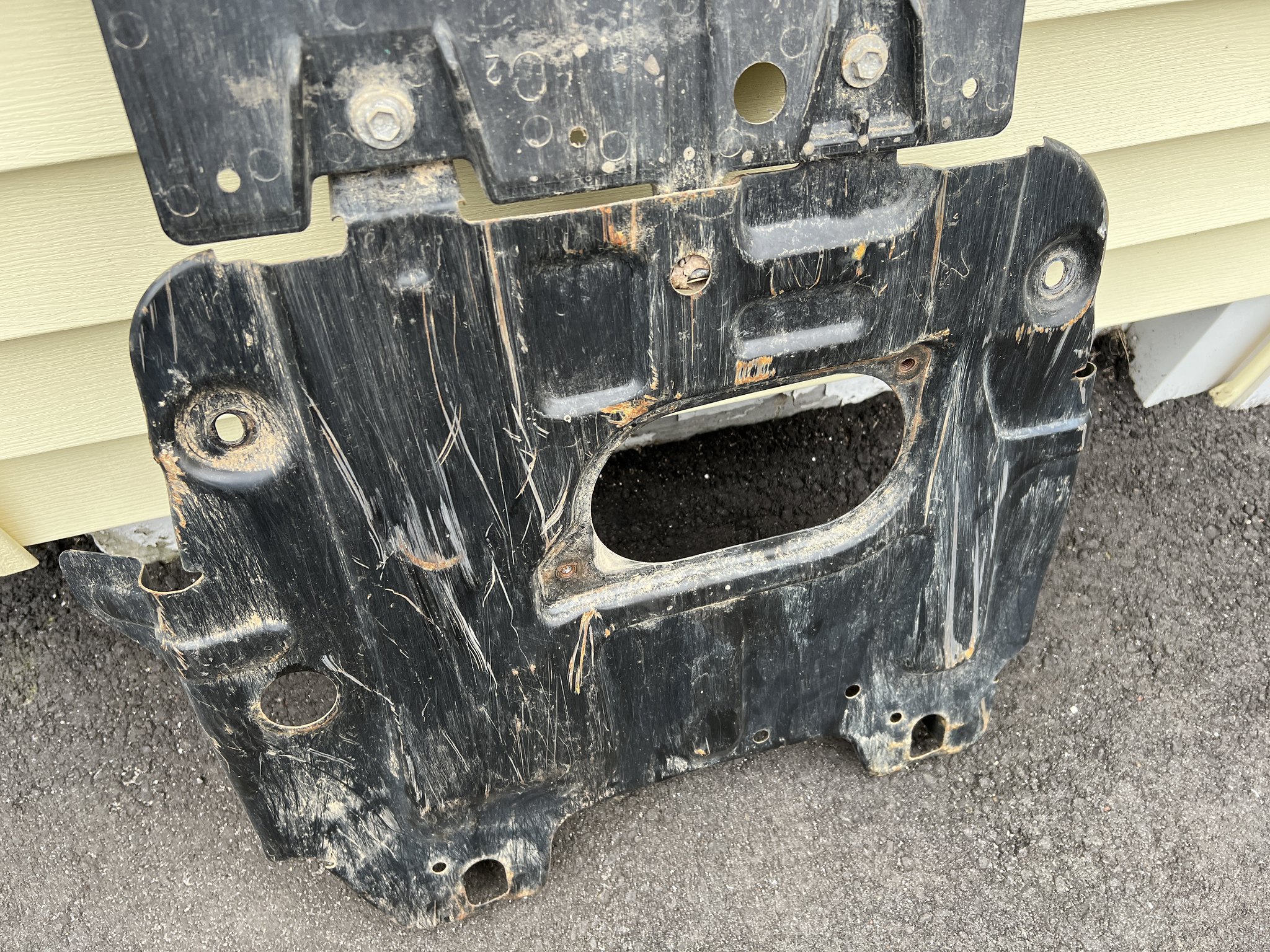

Oh, and the stock skid sure got a workout...

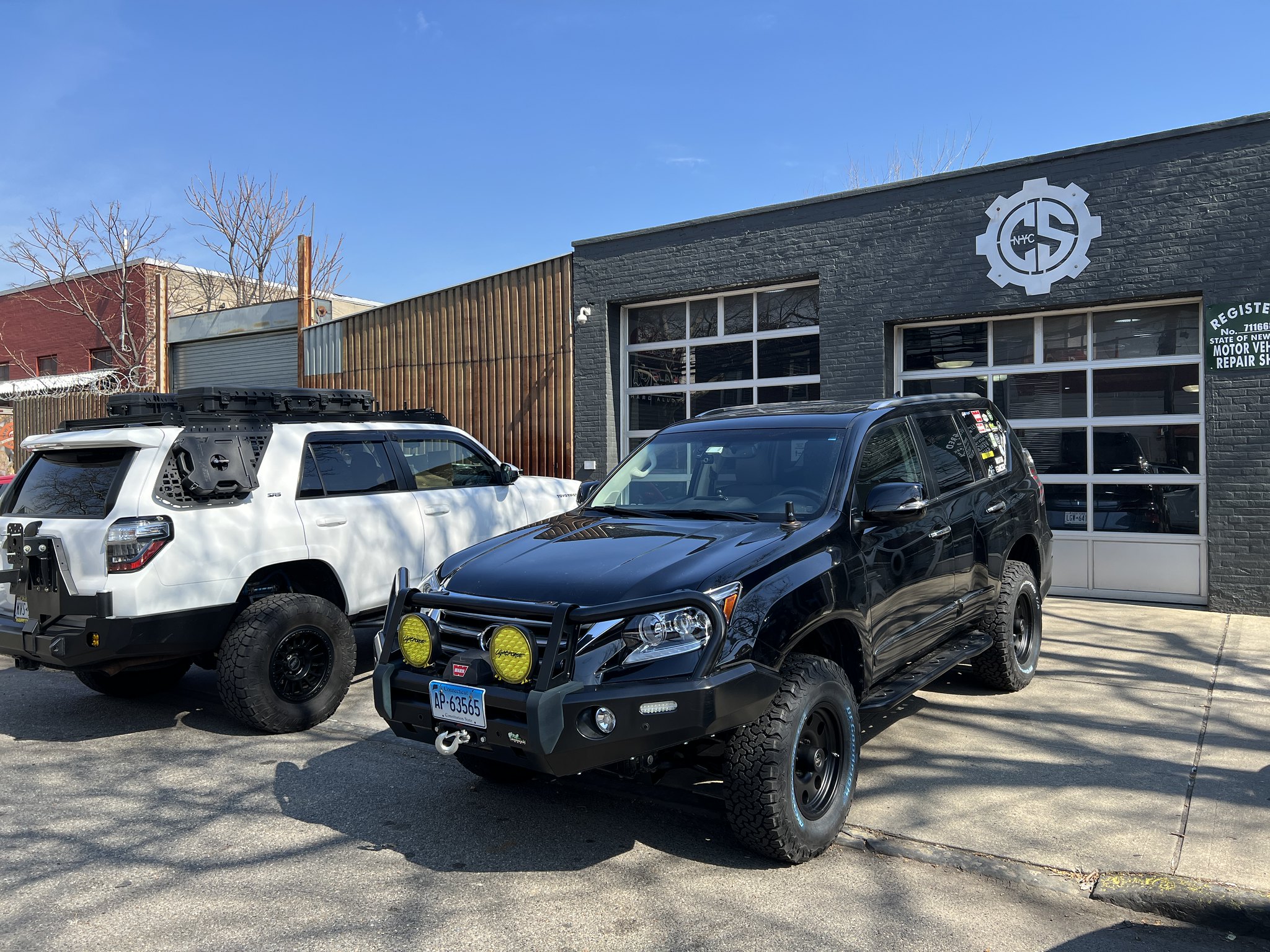

Usually this is where I would have included my full installation write-up, but limited time and hectic life shenanigans led me to bring the GX to The Custom Shop (which has done work on my GX in the past) to have the wheels/tires and skid plates installed. Everything went smoothly, though the "wings" for one of the skid plates did have to be notched a bit to fit around the bolts that wrap around the frame to hold on the White Knuckle Off-Road rock sliders. Minor issue all things considered, but worth mentioning.

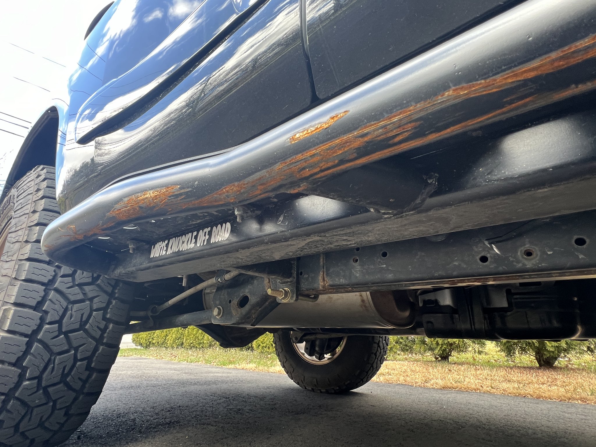

Speaking of the WKOR sliders, they've already been worth their weight in gold:

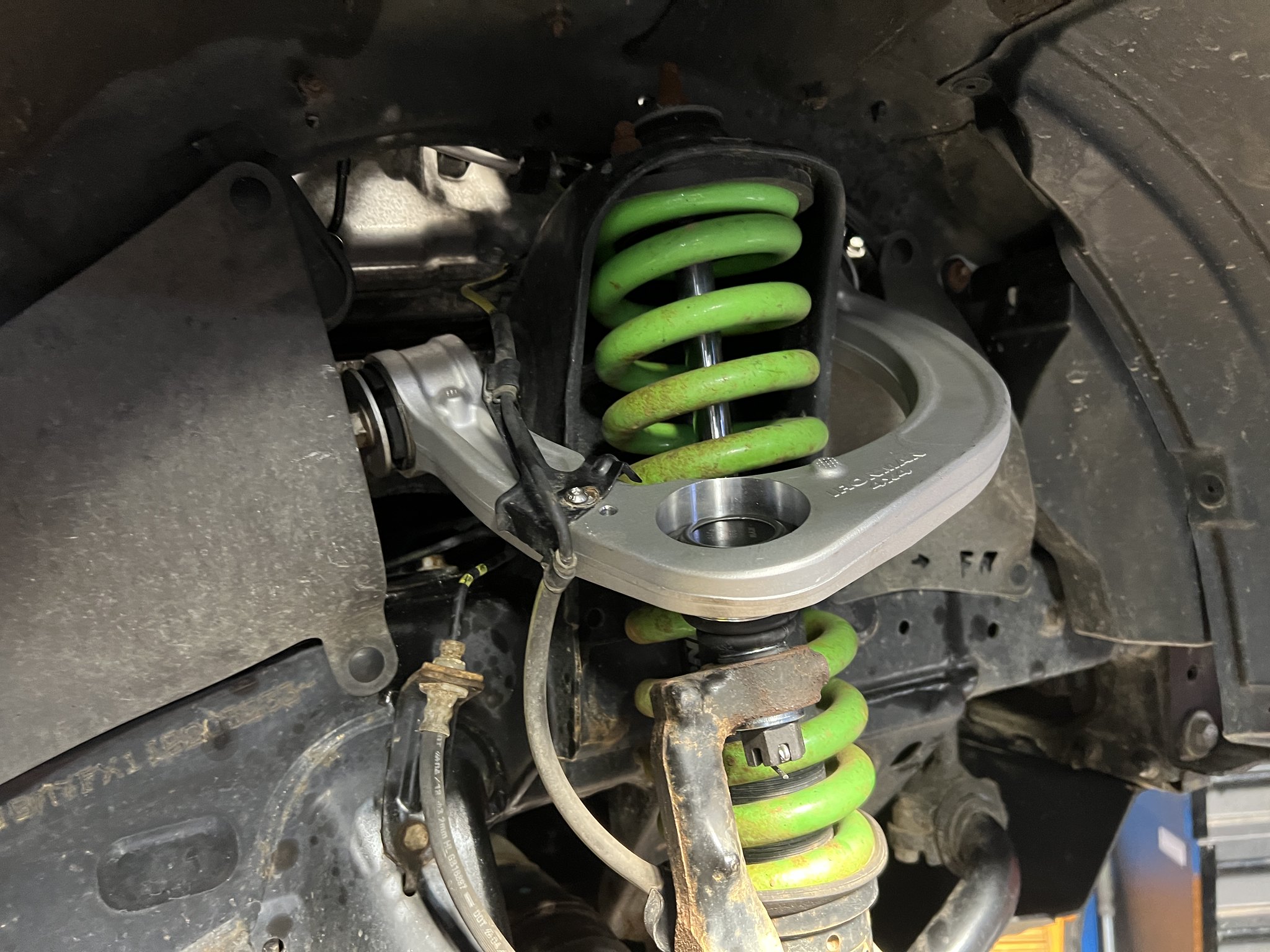

While at the shop, the guys also replaced the recalled Ironman4x4 upper control arms. I hadn't noticed a problem but figured the replacement parts might as well go on the truck instead of sitting in a box in my garage. As it turns out, one of the upper ball joints had in fact torn:
[IMG]
Fresh new UCAs:
[IMG]

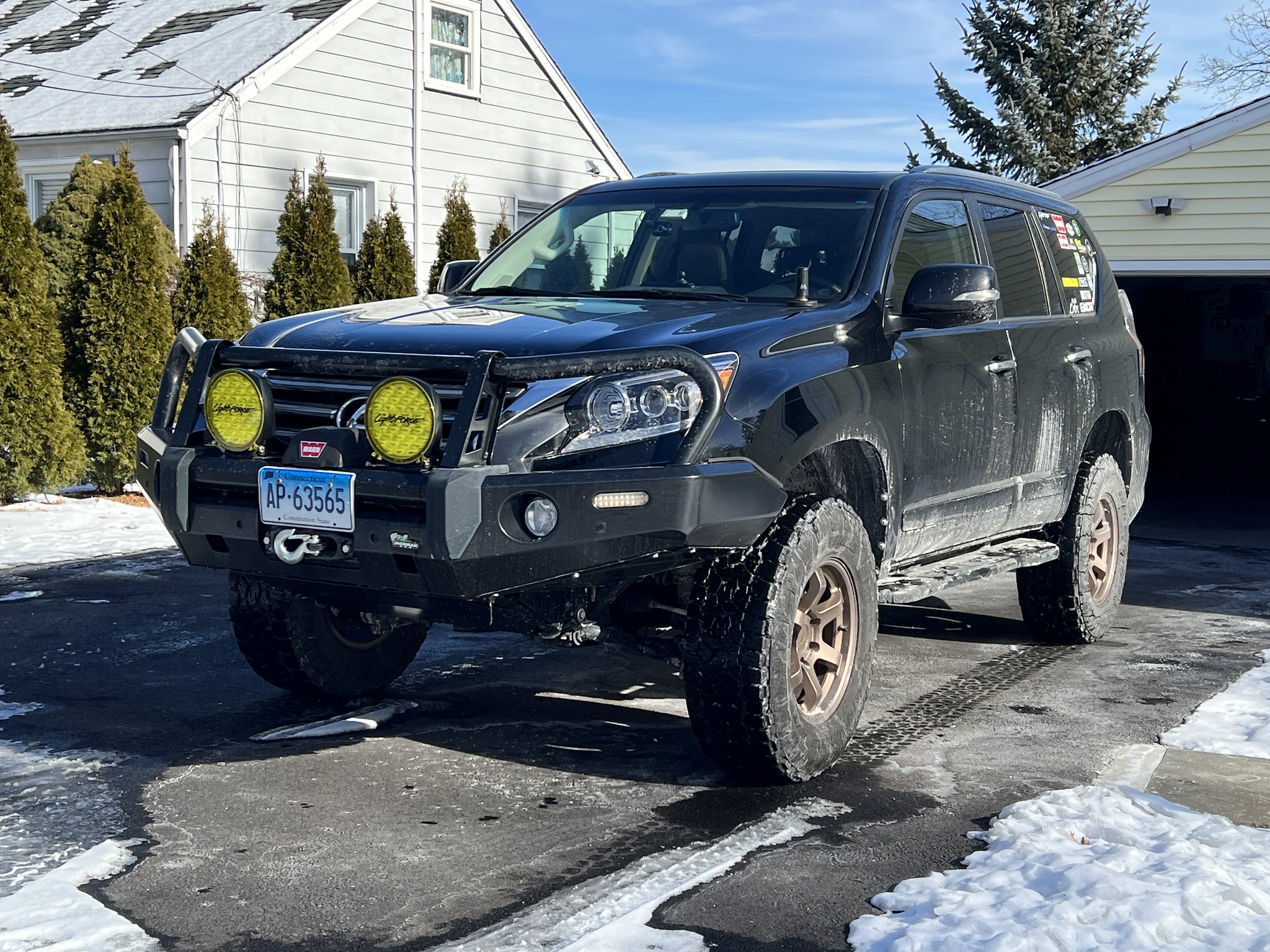

All-in-all, a very productive and satisfying round of upgrades to the GX. It solidified me keeping it around, if not for another few years then for much longer. As much as a pickup would suit some aspects of my life better, I just have so much time/energy/emotion into this GX already that it wouldn't make any sense whatsoever to let go. Plus, it suits my driving use case well and and off-roading it is a hoot. It really does scratch that "Land Cruiser taste on a used 4Runner budget" itch. Love this truck.

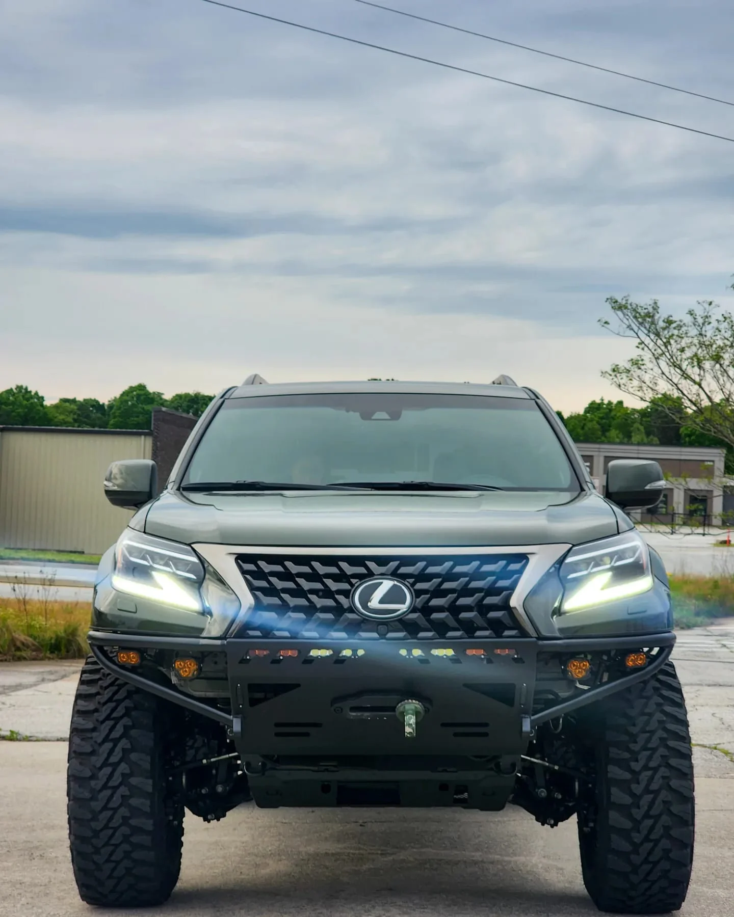

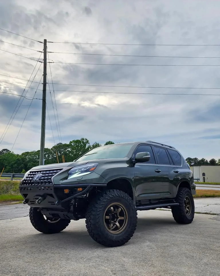

Yep, me neither! I decided I wasn't going to be able to purchase what I wanted so I reengineered it with the help of an engineer friend. I had quality issues with Victory as well. See below....
Dig how that looks, but wrong coast unfortunately.
Premium. The items I listed were removed from the website shortly after I had problems with Ironman, except the bumper. I think they may have reworked it to make it fit the power steering lines and radiator better.
I remember reading about the issues you had. Kudos to you and your friend for the re-engineering! I'll have to explore that...
