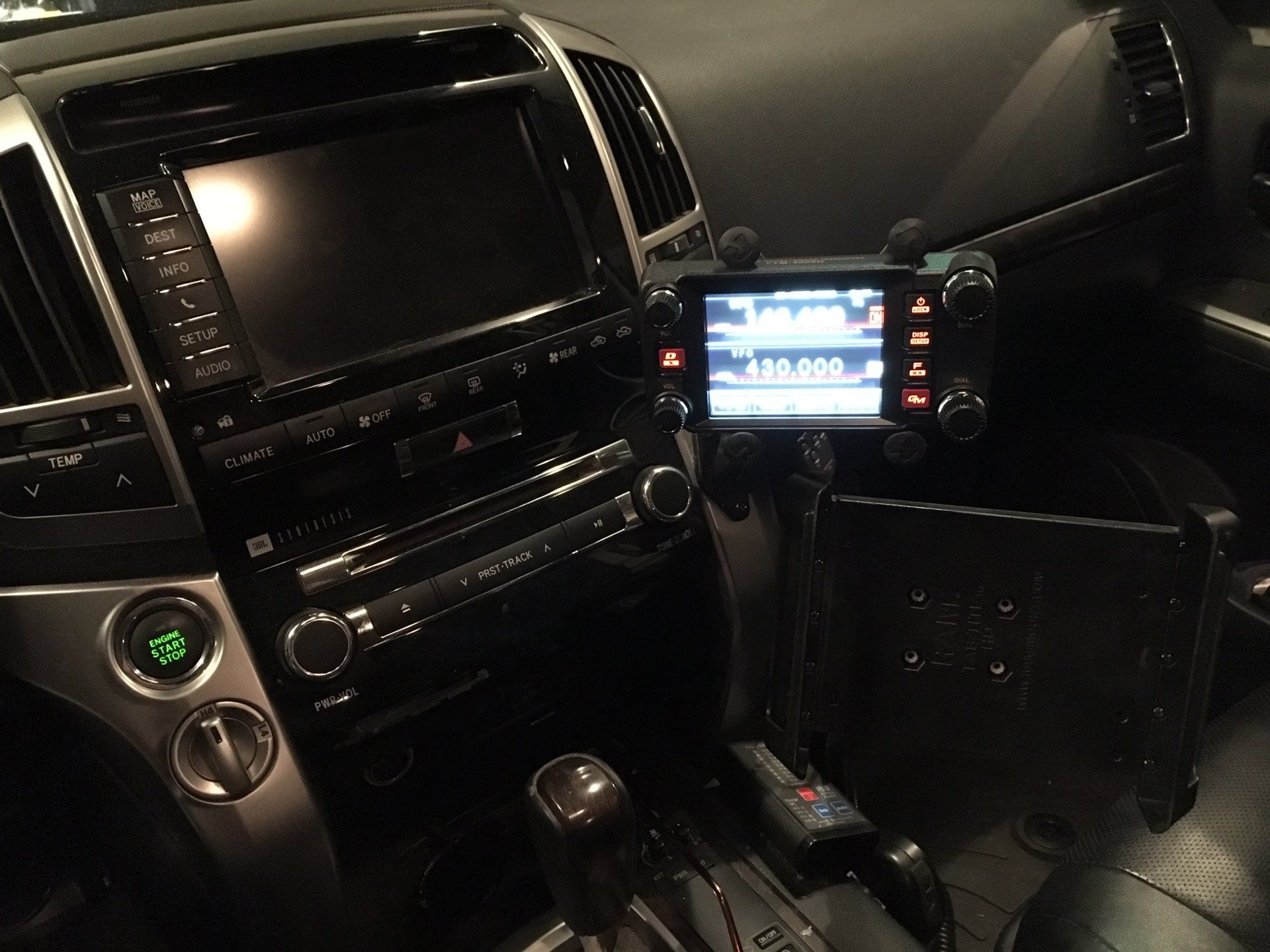

I upgraded my HAM radio to a yaesu FTM-400XDR. Real nice unit
I ended up swapping the position of the tablet and the radio. They are both RAM Mou
Nice, Ken!
I just ordered the EXACT same unit yesterday.
With same tech, it means we could track the other’s position... -Pretty slick setup for a leader/gunner combo. Wouldn’t have to wait for verbal distance/positioning cues because it can show up on screen. Mine won’t arrive til late Feb (backordered due to the killer rebate), but looking forward to it.
One cool feature will be setting up a handheld to work in conjunction with it on one band...let ting it instantly rebroadcast to the group frequency at its full 50 watts more like a known relay station. So if out of the truck, you can still reach out full distance with a handheld use a handheld instead of its 3, 5 or 8 watts.
Anyway...fun stuff!

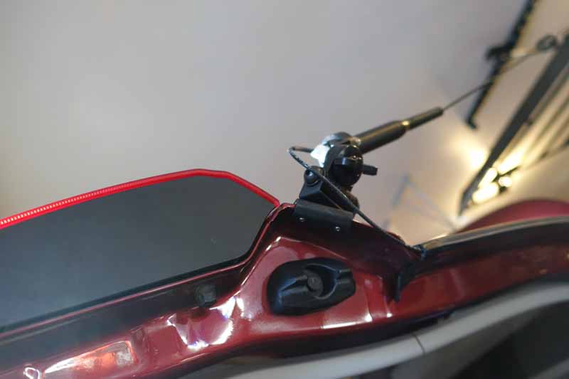

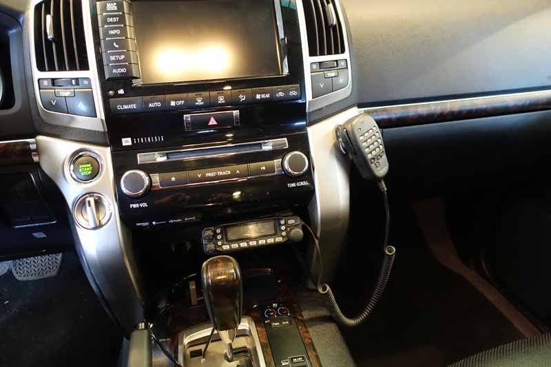

Next cam the Ham Radio. I installed the Yaesu FT-7800 that has been in my 80 and 100. Great Radio. Problem is the mount wouldn't work for the antenna. I went to HRO and found a mount that works on the hatch below the glass
View attachment 1192907View attachment 1192908View attachment 1192909

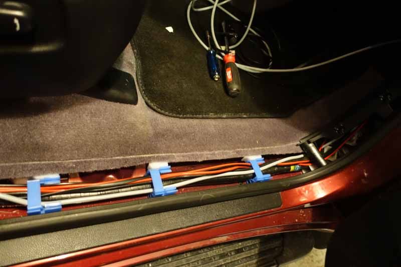

The 200 has an advantage over the other rigs I have built with the space set aside for wiring. I went ahead and strung wire for the HAM, CB and AUX power outlet
Then used a angle piece a plastic I JB welded above the ashtray and used adhesive tape to put the faceplate on
@Romer any chance you could shed a little light on the 'angled piece of plastic' you used to mount this faceplate? I bought the same rear hatch mount the other day as well .
Just read your whole thread, great job on everything!
It was just something I had in my junk drawer. It has been tossed since I put my new radio in.
My daughters GX470 had a similar angle and I cut a piece of wood until the angle was right. Then I painted it black and used Velcro on both sides
Nice choice, I have the same radio. Now if I can just get the other guys in our group to get their licenses lol.

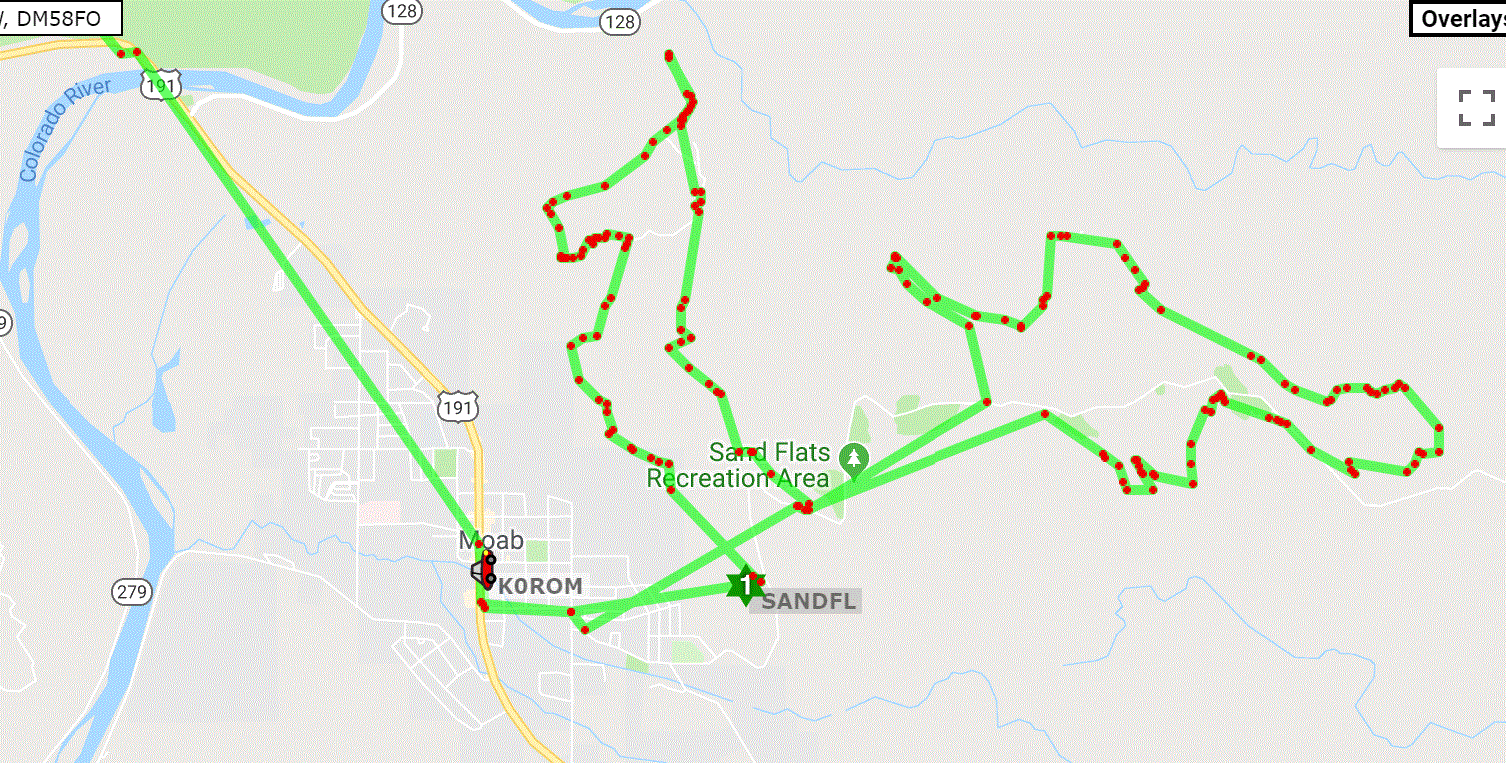

I am really liking this Radio. I still have to play with it to overlay others APRS info I am traveling with on a map. One of the main reasons for the radio is so others can track me in case of emergencies over aprs.fi. Here is my track the last day all made from my Radio being on and transmitting a beacon
I am really liking this Radio. I still have to play with it to overlay others APRS info I am traveling with on a map. One of the main reasons for the radio is so others can track me in case of emergencies over aprs.fi. Here is my track the last day all made from my Radio being on and transmitting a beaconView attachment 1934428
Great to hear, Ken! I’ve got mine ready to go, but my license test keeps getting pushed back as I figure out new ways of procrastinating. Will be a nice field test of at least two APRS units that can see each other in Ouray. The web-map tracking is nice, but I’ll be even more interested in seeing the positioning info of other trucks in a trail group.

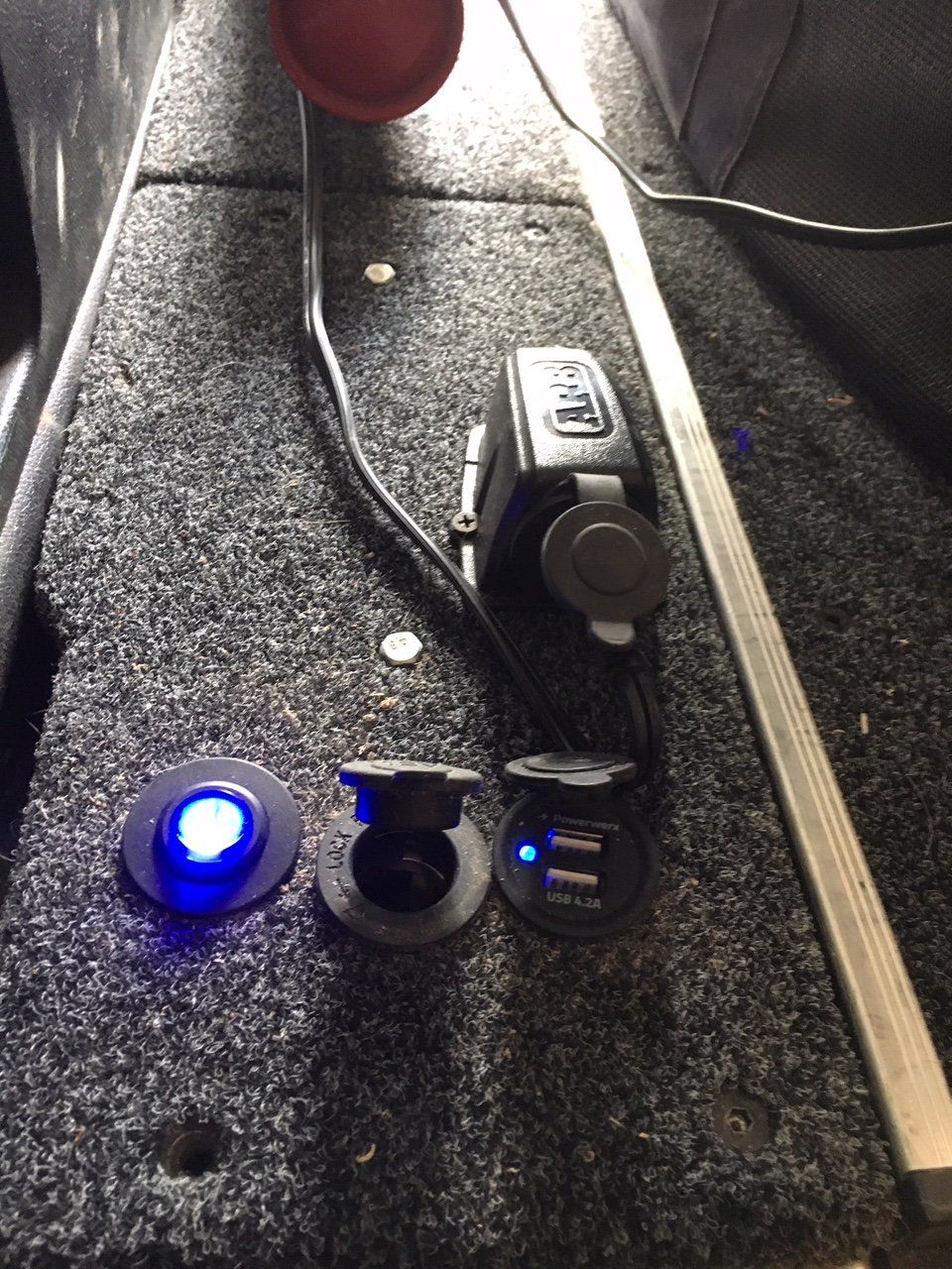

For those who own ARB Fridges, did you know the 12V outlet end screws off and there is a different connector option? This option is more stable during offroad as I have had 12V outlets get intermittent. To make it work you need to order this plug setup for the 12V truck side
I had wired this in last fall. I find that even with the fridge off, there is a drain on the battery so I ended up unplugging it when not in use.
I wired in another USB power socket to run the serial to Bluetooth adapter for my HAM setup I posted above. This allows meto communicate APRS location info to my Tablet and Topo maps
I wanted the better Fridge connector so I wouldnt have to unplug/plug depending on use. So I made a switched power setup, not as nice as what Marksun or Cole would do, but fully functional for my needs. The switch will route power to the fridge and the normal 12V outlet and the dual USB outlet that powers the Bluetooth device
Yes I know I havent put in the 4th bolt to that cover piece as of yet
Oh you will notice the fridge power cable goes forward and then comes back. I it loops on a clamp up front before coming back to ensure there isn't enough slack in the cable to get pinched in the drawer slide. I had busted a cable once. I am using the fire extinguisher clamp for this, but anything will do that does the same function
