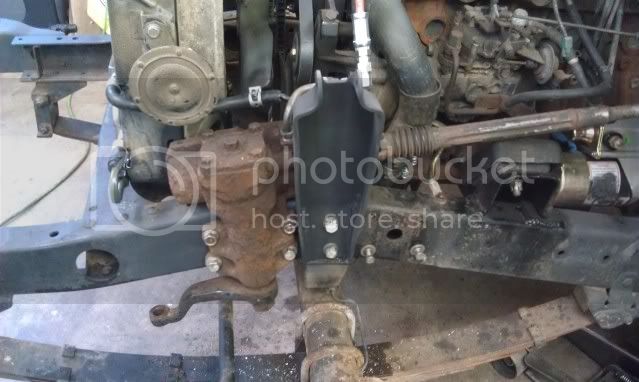

Maybe it's just the abgle of the photo, but the pitman arm looks pretty darn close to the leaf springs.
its the angle of the photo its not close at all considering the factory leafs are pretty much collapsed.

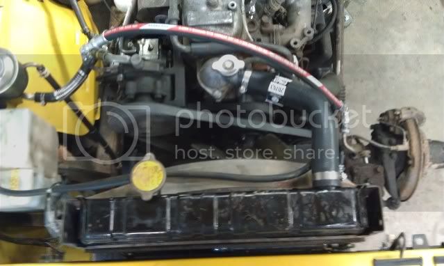

well havent had time to update much so here are some pics of were im at.
going back to work so i can finish up tonight (i hope)

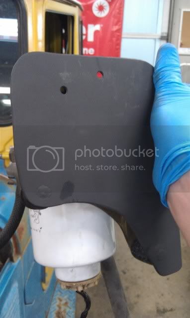

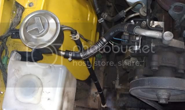

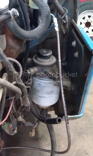

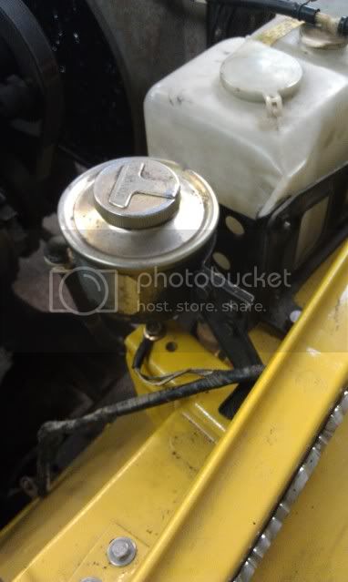

fuel filter bracket mounted using existing pickup points from the carb cooling fan

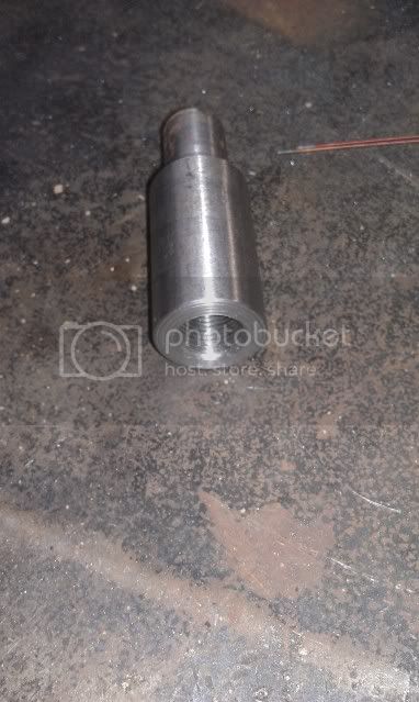

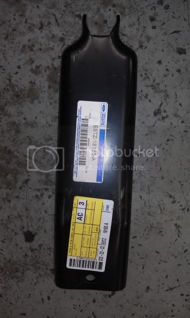

narrowed shock tower at the bottom a bit
i had a hard time tracking down the f250 shock tower part number so if anyone else needs it here ya go
It's alive! goin to the muffler shop on my lunch break and still have to mount the front bumper, stick an air cleaner of sorts on it and tighten up the fenders. oh and straighten the steering wheel. quick test drive this evening and then the 4000+ mile down shake down run first thing in the morning! And i still have to get my camping gear together.
Finally got done with it around 7 this evening and it drives great! The Fj62 steering feels great and the 3b feels much pepier than the old 2f. Feel pretty confident about everything other than a small front output shaft seal leak. Couldn't get a seal today so I ordered one for a few hundred miles down the road that I can pick up tomorrow so if its an issue ill put it in on the road. Drove it around 25 miles tonight and everything else is good so far. I"ll update when I get down the road.

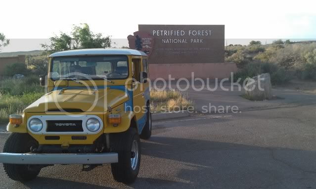

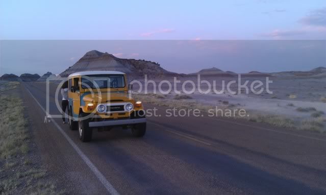

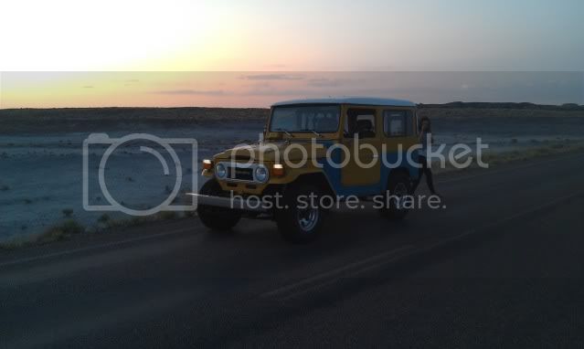

Got to petrified forest at dusk so went for a nice scenic drive.
Drove 1700 some odd miles and so far so good other than the front output seal leaking some gear oil all is well. Hasn't used any oil or coolant and cruises along comfortably at 70mph with some speed to spare.

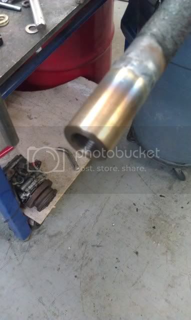

...and a diesel/steering conversion! So I guess you figured out how to attach the steering box to the passenger side TRE, but I just wanted to add that probably the best way would be to ream out the passenger site TRE to match the size of the 70 relay rod.

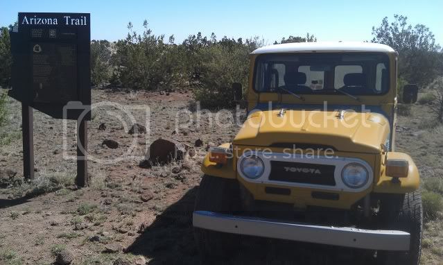

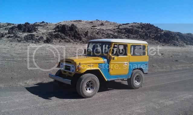

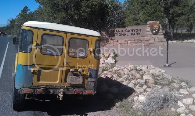

Decided to take the scenic route to the grand canyon so I took a 20+ mile unimproved dirt road outside of flagstaff along the old Arizona trail. It was a Heck of a bumpy ride but well worth it. Oh surprise to me I have had my hubs locked for 1700 miles. :(

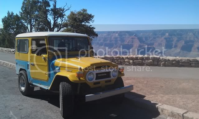

Made it to the canyon but apparently the passes to camp below the rim sold out in January. So I camped on the rim (literally) and revised the trip a bit.

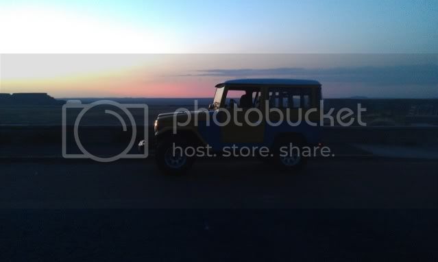

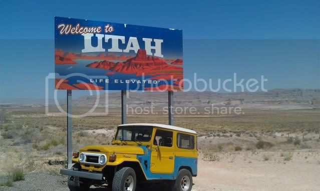

Here is where I ended up today.

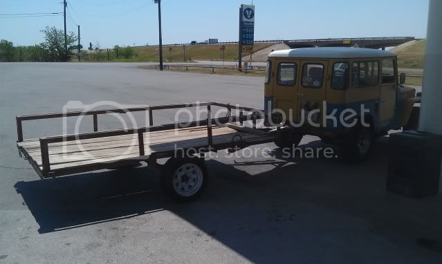

I was planning on renting a uhaul trailer for a one way run from Dallas Texas to Huntsville Alabama....until I found out it was goin to be 260 bucks! So after searching Craigslist from Arizona to Texas I ended up picking this little guy up in wichita falls Texas for 300 bucks. Trucks been running great other than my last minute muffler job bit me in the butt. Muffler broke because I didn't have time to install a flex pipe. Oh also stopped at a big rig shop in amarillo and talked them into letting me use their pit to do a quick oil change.

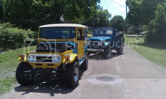

4382 miles later I'm back home with the goods. Goin to try to do a quick frame off in time for a north western trip in august
Not only was that a great trip, but I am utterly flabbergasted at how quickly you were able to get your BJ40 up and running.
So.......when you write that you're thinking of a "north western" trip, I say: let's see you make it REALLY north and west. See ya here!
