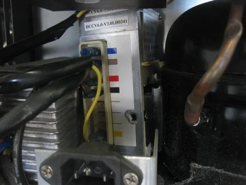

I read how connections could be loose, so I planned on opening her up upon arrival to inspect and fix anything.
Control box was missing a mounting screw, and just bouncing around inside. Used one of the panel cover screws to secure it.
I checked all the female connectors and they were all loose. I pulled them all and the wire crimps looked good. Seems they just needed a little tightening with some pliers at the attachment points. Now they fit nice and tight!
I plugged it in and the box went down from 47 deg to the negatives in no time!:D
