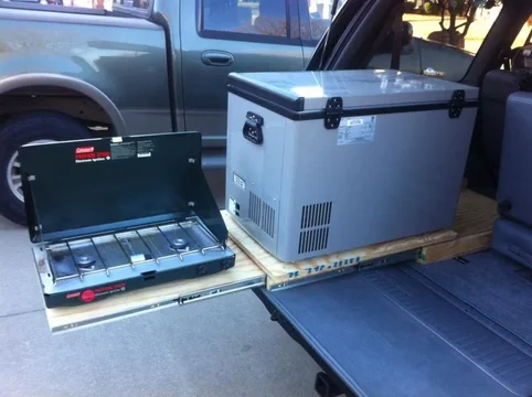

For anyone that cares, I built a slide for the 63 quart to go in my LX470. It's not final yet, but is pretty close. I just need to bolt it in the truck and make sure the fridge door has clearnace to open all the way. I basically copied another Mud user's design. See my build here, Post #34: https://forum.ih8mud.com/expedition...w-fridge-stove-slide-combo-2.html#post9009239
