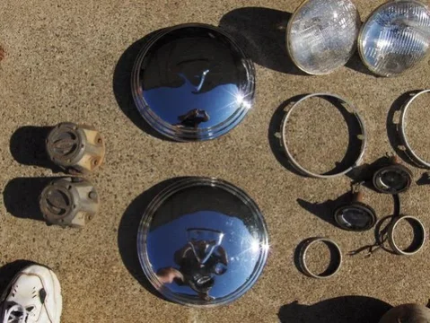

So last night at the hamburger stand a guy strikes up a conversation. I tell him he has a nice car and that I'm doing a 65 FJ40. He says Oh ya, I bought a 66 off the lot and kept it for 40 years, just sold it while back. You got any interest in some parts I still have. I say heck ya what do you got. I gave him my number and he called me today. His junk is my treasure!

A coulpe of weeks ago I landed a set of toyota OEM bows so I am slowly getting there.

NOW your really pissing me off. Standing in line, someone says "Hey, want some parts." Sure, why not. Sheez. All I see standing in line are, well, other people standing in line. What ya doin' with those hub caps?
Well I have to say it does feel nice to have something go your way for once. as far as the caps go, I'm not sure. I have 5 on order, 2 with holes. But i think I'm going to look for the parts to remove my lockers and if I do then I need them. Just not sure yet.
Fantastic!!! That is a awesome story, and for what it's worth, I'd keep all this stuff no matter what...and I know, as I'd love those caps and tool pouch as well...hell I'd be happy with those chrome rings :lol:

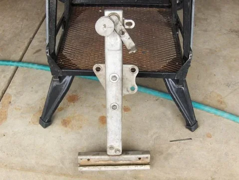

On a different note what can anyone tell me about the jerry can holder I have. It looks like it could have been home made but probably not. It bolts to the spare tire rack. Do you know who made these? Google wasn't any help. Were they any good? not sure if I'll use it but if I don't I need to know more about it so I can trade for something cool.

It could be a home made copy of the old Confer gas can holder. I have one I picked up somewhere over the last twenty years. If I remember correcctly it has a stud out the top that you use to tighten a clamp. Then a lock was used. The reason I remember the lock is mine has a lock on it that I don't have the key for.:frown:

Ya that's what I'm thinking. The big round thing at the top is a 1/2" or so thick rubber washer that applies pressure to the top/handle of the can and then a lock goes through the holes.
