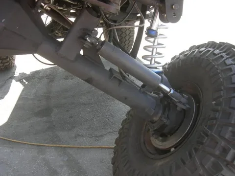

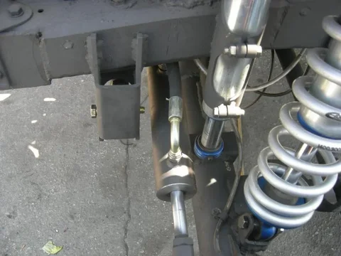

Decided to relocate ram assist

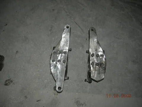

Built up the left side steering arm earlier in build when I made the six stood knuckle.
Looks like that will be the location
drilled to 5/8
single sheer at steering arm
built bracket for axle housing
double sheer

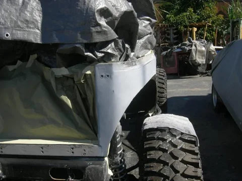

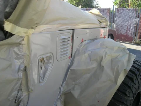

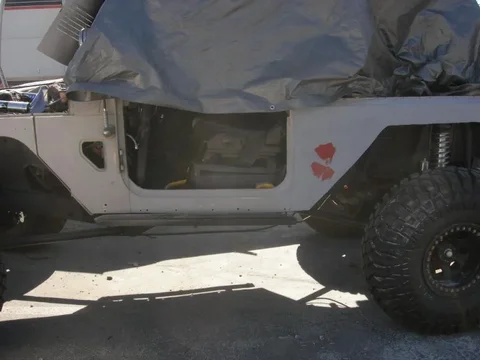

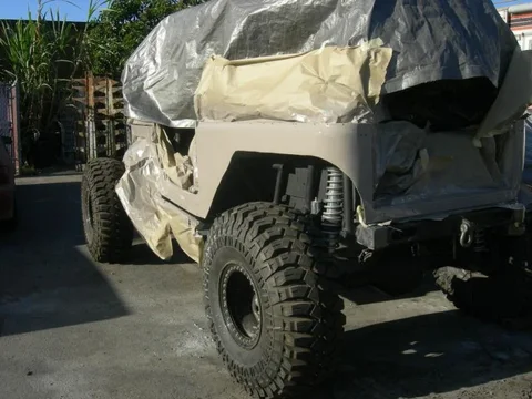

some sanding and I will get one more coat on the rig
I wasnt going for perfect
The body is going to get beat up pretty bad anyway
didnt paint the hood or the bib although they both need it
I know this position for the ram it's making the job anycase .. but aren't pushing more effort in one knuckle a little more than the other . .. ?
I'm tjinking on it .. it's like to drag links on front and the tie rod alone in the back. .. maybe not .. just wondering ..
