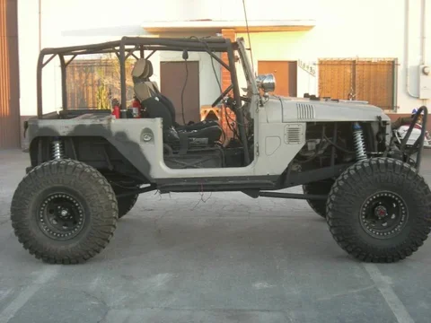

Build rocks and rolls

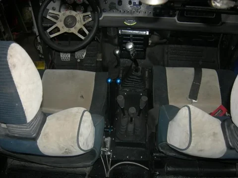

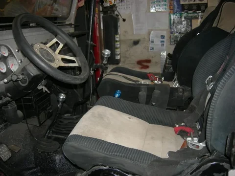

put in the seats
Inside of cab
I need to fab up a removable bar behind the seats to mount the shoulder straps to prevent spinal compression in case of roll over
fire extinguishers mounted
battery box and storage box mounted

The current arrangement allows for access from the top without removing everything
seats out and two tunnel cover panels off
shifter cables

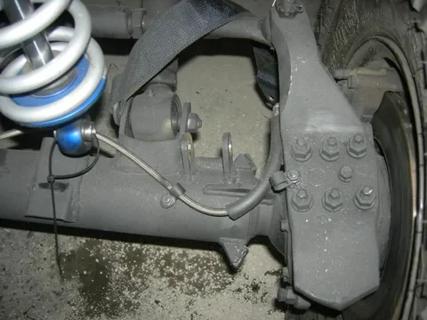

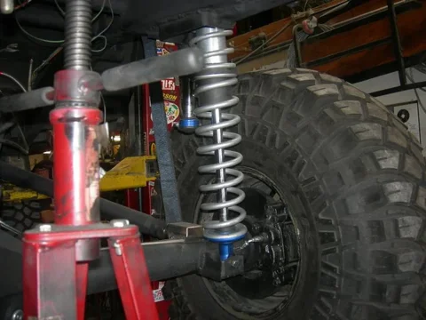

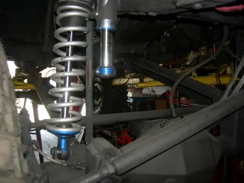

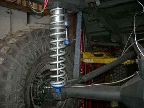

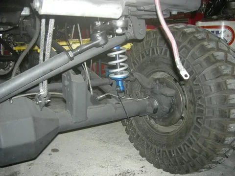

at the start of the project I began up front and worked toward the back.
I initially made the bracket at the axle wrong
The bracket should be parallel and not perpendicular to the axle.
so time rework
