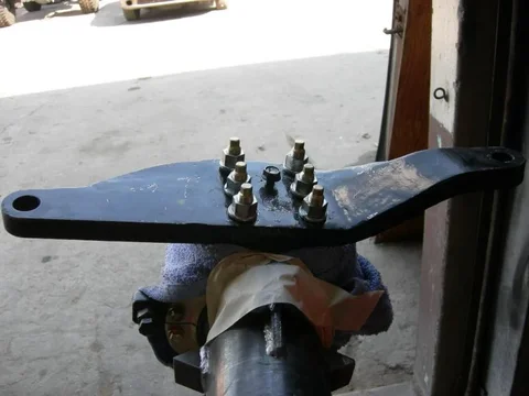

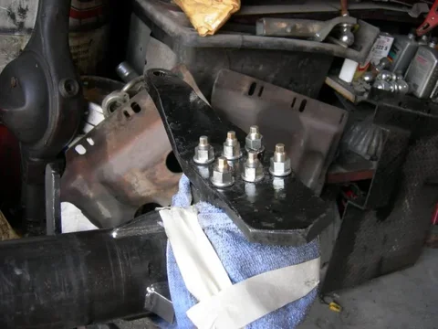

Picture of homemade 6 shooters
the stupid bolt in the middle close to the trunion was an attempt at a built in bearing/steering arm removal system.

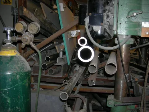

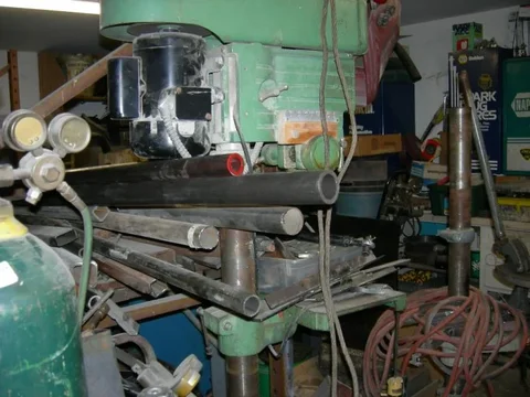

went to the metal store and spent more money than I would ever want to
2" OD quarter wall for 3 link, 1.5" OD quarter wall for the panhard and 1.5 OD 120 wall for the steering extensions.
expensive

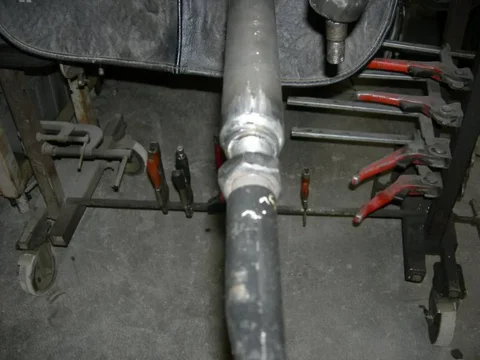

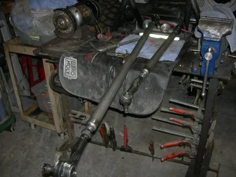

Forgot the camera on this operation but took a couple pics of the finished product.

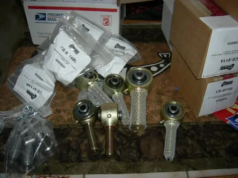

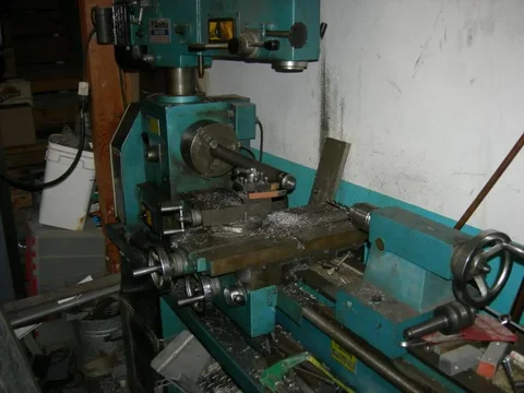

I had to add 8 inches on the drag link and 4 inches on tie rod ao it was buy new tub and run single sheer heims or find a right and left hand 7/8 18 tap for the GM tie rod ends which was about 150 bones for the left.
So I decided to machine a filler piece for both and welded it together, then sleeved them with 1.5 OD 120 wall. rosette welds to keep in place and couple of roll pins for security.
machined down the welds. machined two lines on the left side
runnin r/h threads on both ends isn't the end of the world... if you need to adjust, just loosen the nuts a turn and run the steering wheel back and forth and it pops 1 ton tres no problem.
