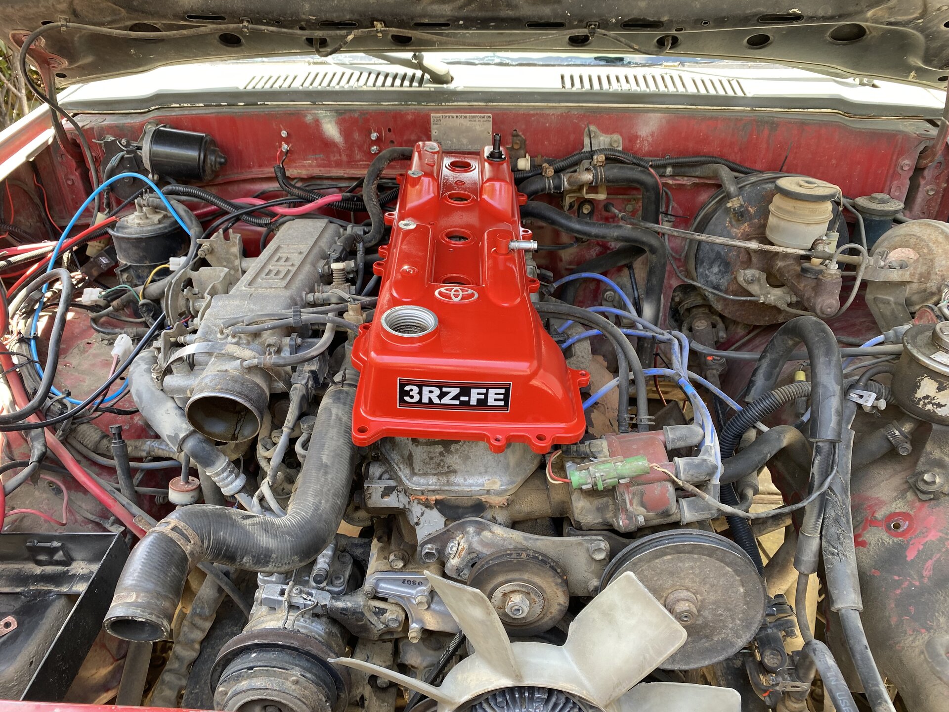

So the next update inline chronologically would basically be post #1. Pulled the engine, got it to my house, and on the stand.
The 3RZ water pump joke cracked me up to see in person. Why change a design proven by the test of time?
As of this weekend, I got it fully broken down and the block and head are ready for the machine shop. It will be dropped off this week.
Nothing I saw in the tear down looked like anything of concern. Head gasket was good. I'm pretty confident that this thing would have ran just fine for a long time if I left it stock and just threw it in. I really do wish I had two of these engines, as I would love to have just thrown this one in and rebuilt one on the side at a leisurely pace. But you're seeing a theme here- JUST GOTTA ROLL WITH IT.

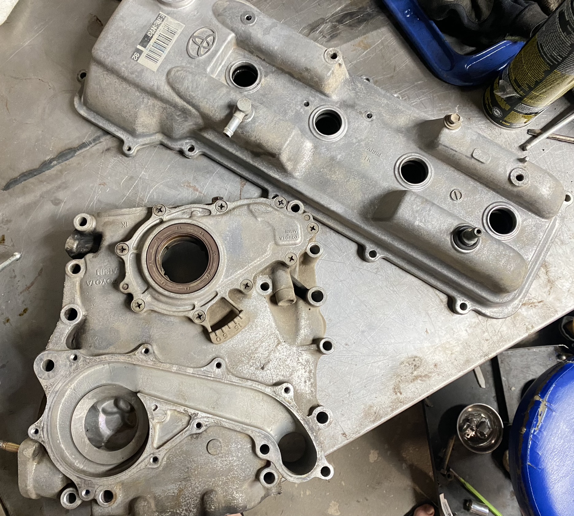

Sunday scrubbing. Trying to decide what I want to paint and which colors. I’d love to have the valve cover power coated, but I don’t want to pay for it. So it’s not happening.
Well, I went powder. Gunmetal gray.
I saw that! I am probably ripping you off in the poor man version of gray - rattle can. Ultimately mine is a trail rig, and lets be real, the body isn't a show vehicle. Powder coated parts in a red engine bay with rattle can green body that has trail cellulitis would be a funny move. :rofl:
Oh and the 3RZ stickers came in from you. So definitely ripping you off if I stick to gray hahhaha. Who knows though. I may impulse another color.
