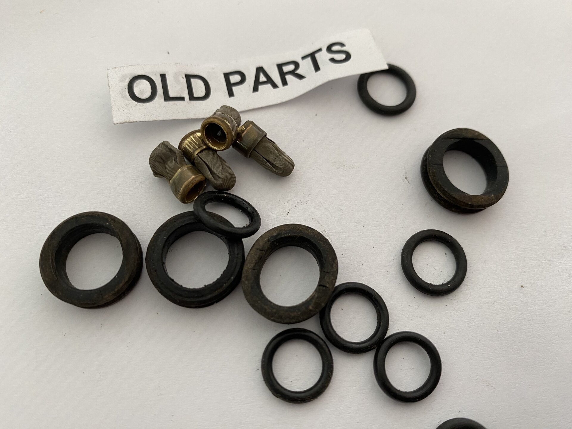

- found some pink top injectors locally that I sent to RC Fuel Injection for rework

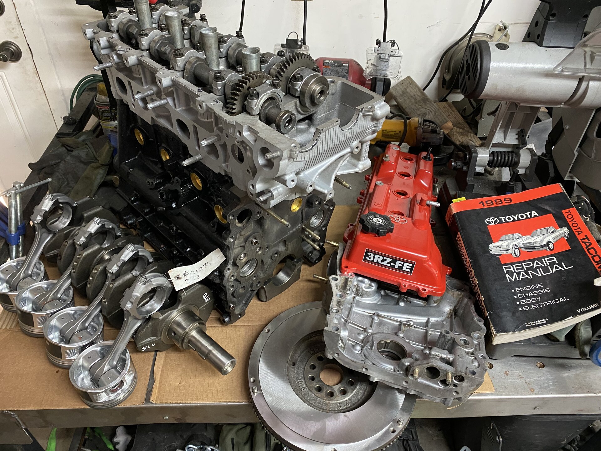

Big day - I pick up engine from the shop later this afternoon and a bunch of goodies arrived.
I have to give a shout out to RC Injection. Excellent service. One of my injectors ohmed out of spec. They had another they just gave me to rebuild free of charge. 🤘 numbers in the build sheet are interesting. Definitely glad I had them reworked.
A new clutch is a beautiful thing.
