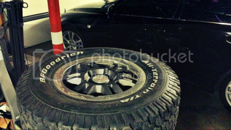

Got what I thought was a pretty good deal on tires and wheels. Came off a 2013 Tundra and tires are around 70% tread left.
Yes those are the ones you need.
Not sure why the front has the 'tines' vs a solid machined area there but those are the spacers I have, but have not yet installed.
Thank you, sir. I was hoping Slee would be open today but no such luck. I'll order them Monday morning and hope I can get them by end of next week. I'm going to flip black wall out and pull my running boards, biting at the bit to see the results. I'm running 265/70/16's now and comparing the RW wheels and tires to the old ones, huge difference. Wife is complaining about me taking the running boards off but she'll have to get over it. I don't like crawling out of her IS350 either but I don't tell her to lift it :) I'm going to keep my 16" stock wheels for a while just till I know I like the ride of these but when I sell them, any idea what would be a good asking price? Tires are about 50% and doubt anyone will want the tires so they'll mostly be buying the wheels. Is there a lot of people looking for the 16" rims?

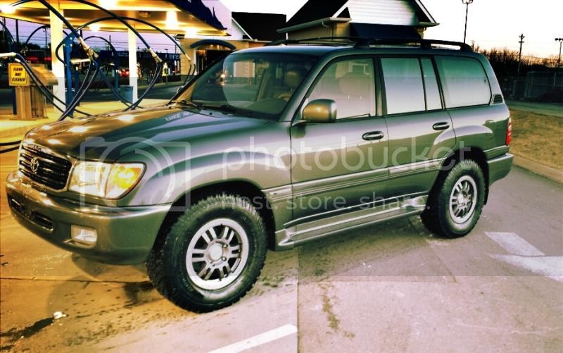

Got my RW on today. Really happy with them. Going to pull the running boards this weekend but I think they even look good with them
Nice!
Have you considered or looked at removing the rings off the rims?
I like them both ways but for now going to keep the rings on
Remove the rings and you'll leave 12 exposed holes where the fasteners would be. Not worth it IMO, which is why I left them on mine.
10ga: how much did the rims with tires run you? Congrats on the purchase!
My thoughts were to install button head bolts to give them a finished look. Not my idea something I saw and I liked the cleaner look without the ring.:meh:
I agree, like them the way they are. Got wheels and tires for $600
